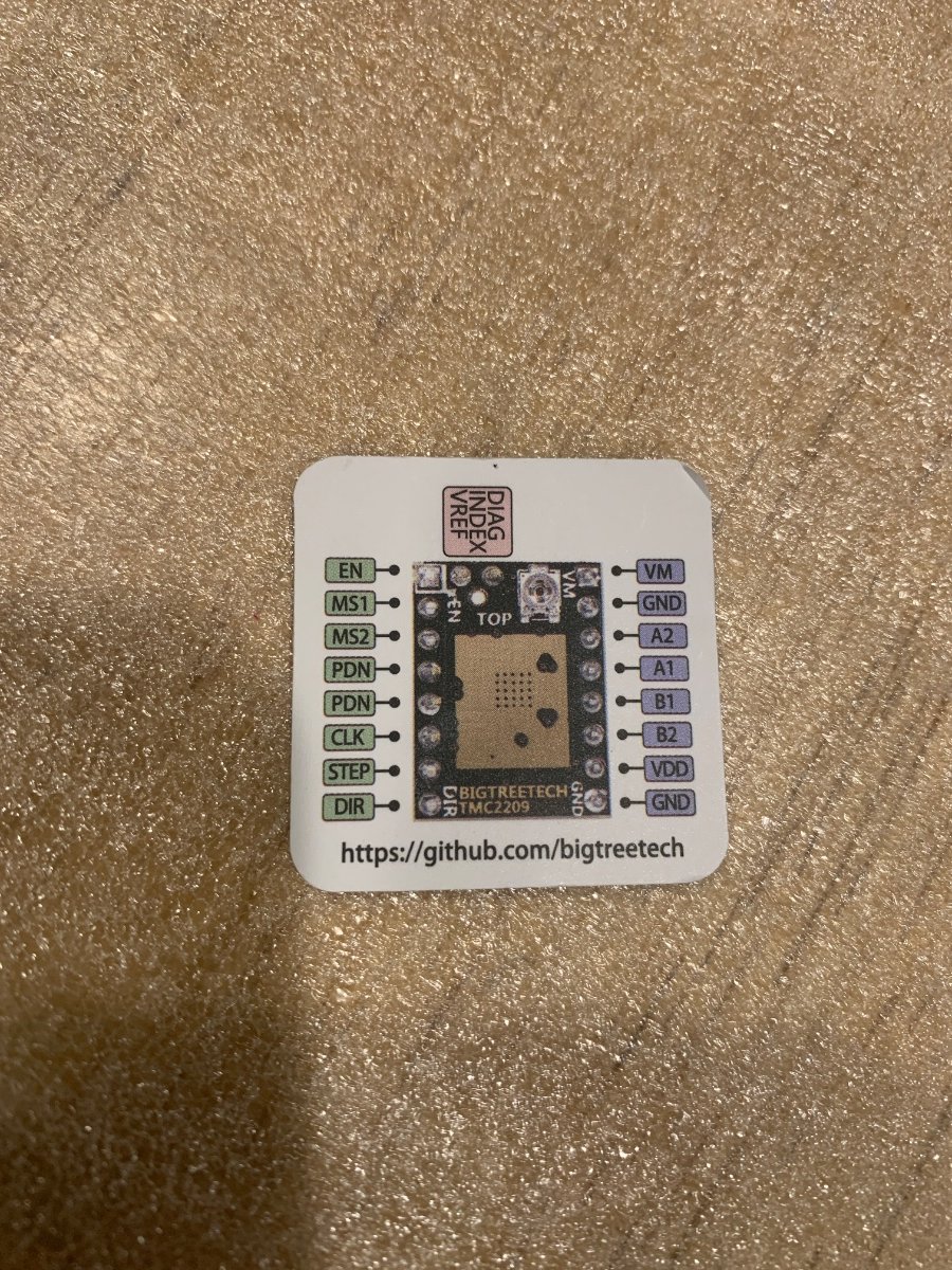

Hi all,
Having my fresh build 2.4R2 up and running now I only got a few small issues left one being noisy Z stepperdrivers/steppermotors.
I have a formbot kit, so the setup is a octopus V1.1 with TMC2209 drivers from BTT and moons 1.8 degree steppers.
The issue is that de Z motors are noisy during movement, the X and Y motors with same hardware and config setting however are silent.
Beside that when there is no movement but the motors are locked the (I assume) drivers sound like a fan, when I unlock them the sound is gone.
I have been trying to resolve this issue without result so I am hoping one of you might be able to help me with this.
