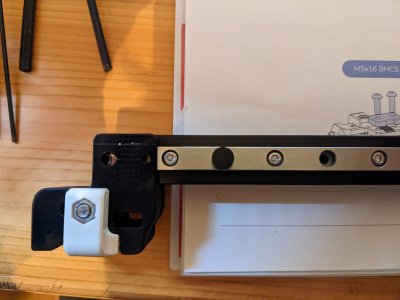

I am building a 300mm formbot V2.4 R2 kit.
I am at the step where you attach the idlers to the Y axis. I cannot get the idler flush with the end of the extrusion because the T-nuts on the side with the linear rail hit the screw for the rail.
I verified I have the rail 25mm from the end of the extrusion on both ends. The extrusion is 400mm and the rail is 350mm.
I have the hole in the T-nut out towards the end of the extrusion.
Can anyone think of something I could have wrong or do I just make it fit by grinding off the T-nut or using a hammer head one instead?
