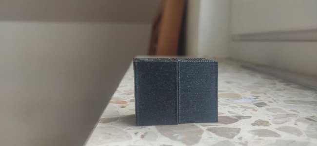

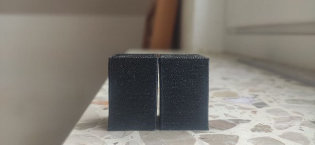

I’m having an issue with my Voron 2.4 R2 (350x350x350) – I’m seeing cumulative layer shifts during long prints (the longer the print, the more the shift is visible on the X and Y axes).
Hardware setup:
  • Mainboard: BIGTREETECH Manta M8P V2.0 with CM4
  • Toolhead board: EBB SB2209 (CAN)
  • Drivers: TMC2209 in UART
  • Input shaper configured using ADXL345
  • Z-probe: Voron TAP
What I’ve tried so far:
  • Belt tension verified and even
  • Motors and pulleys are secure
  • I swapped X/Y motors and drivers – no improvement
  • No overheating detected
Could the problem be caused by the mainboard, CAN communication, or possibly power issues?
Any help or suggestions would be highly appreciated!

Humm, if your sure its not skew and is in fact layer shifts.
Is the config for the motors correct?
What speed and accecls are you running?
Current of drivers?
The current is set to 0.9 A, speed is 150 mm/s, and acceleration is 5000 mm/s².
I’m using TMC2209 drivers.
Anyway to get a fan on the drivers?
What about the tension in the Z belts? Could there be some wobble in the frame or gantry?
