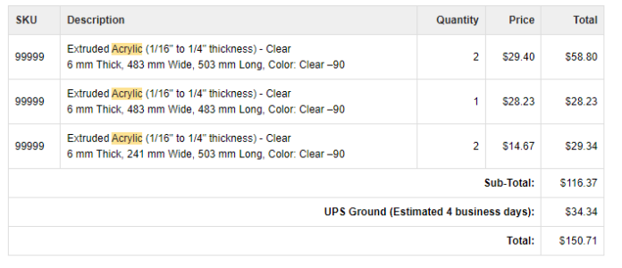

One other mod I made that I always forget about but love. 6mm Acrylic panels. The stock, I think are 2mm or something, are flimsy and let out a lot of heat. 6mm might be a bit large but it really was overall much better once I get them on. Although 5mm might have been better for tolerances.

You see the Acrylic sheet thickness is an excelent point that i would never have even thought about so thanks, i expect i will follow suit as 2mm does seem rather flimsy.
