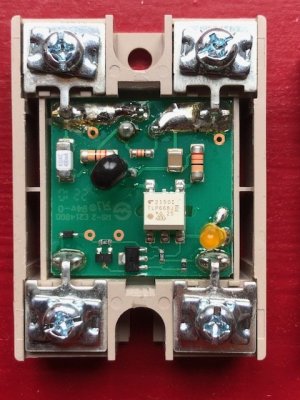

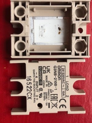

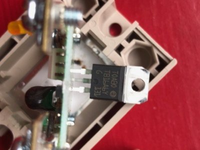

If anyone is interested, this is the SSR that formbot currently ships in their 2.4r2 kit. It is a Omron branded G3NB-210B SSR, weighs 58g (Omrons says approx 60g in their datasheet). Since I orderd a trustworthy SSR somewhere else I opened this one up to see what is inside. The Triac (TOABO TB16A6Y) was properly clamped to the metal backpanel and is rated for 16A per its datasheet. I don't have a genuine Omron SSR here to compare so I cant judge if it is genuine or not but from its build it looks okay I guess.
