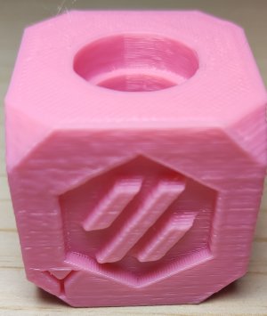

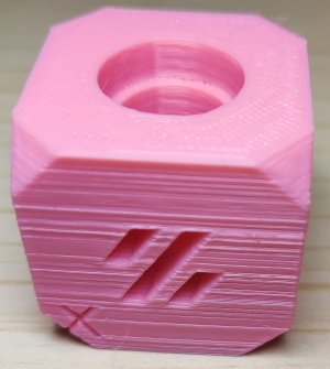

Help,I came across strange patterns
A-147
voron 2.4
I just assembled 2.4, but there are serious lines, they appear more in the same direction, I don't know how to solve this problemIMG_20240118_001522.jpgIMG_20240118_001552.jpg
What did you make your carriage assemblies from? It is possible that you have flexing in them causing them to not center perfectly. If you used PLA, they might be softening up in the heat of the enclosure.
