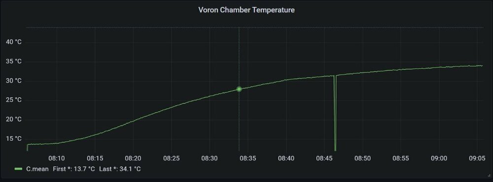

I have my home assistant instance taking data from Moonraker, logging that into InfluxDB and graphing with Grafana.
I was not able to get the exact same start temperature the entire time, but kept it within a few degrees, so not a completely scientific test but I feel close enough to draw conclusions.
The bed is running at 110C I used the fan configs in the Elis bed fan github to control the fans. For the Nevermore during bed heating it runs the fans at 40% and then 100% when the bed reaches 110C. For the bed fans it runs the fans at 20% during bed heating, then at 60% when it reaches 110C
Ambient temperature in the room stayed about 1 degree from the what it started it when I began doing testing. Between 15C and 16C.
Here are the results:
To start I did tests with neither the Nevermore nor the bed fans running:
Test 1:
No fans running. No Exhaust fun running. Chamber being heated by the bed alone.
32 minutes from start till 30C
34.2C after 1 hour

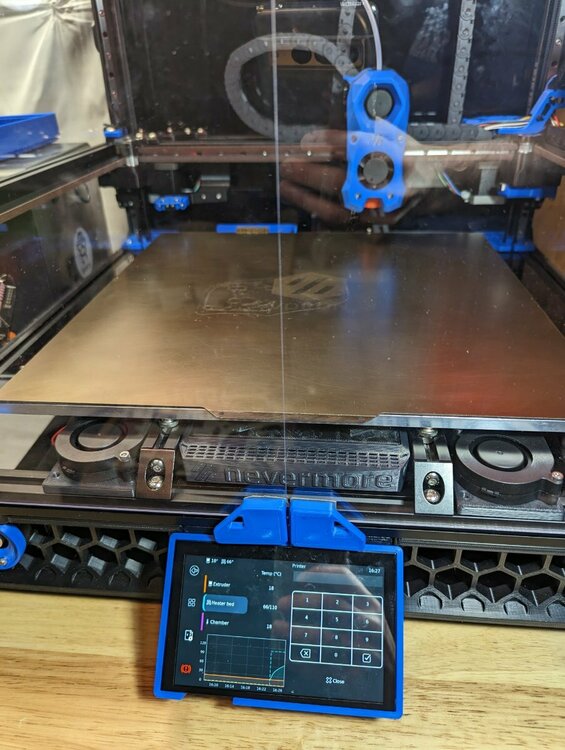

I installed a Nevermore V5 Duo V2 (Normal sized) and 2 bed fans using the Elis bed fan mount for air filtering and speeding up the chamber heat up times. But how much did it really help? Since I apparently have too much time on my hands and nothing to print at the moment, I tested various combinations of these configurations to see how fast it heated up the chamber.
Here is my setup:
Voron 2.4r2 built from a formbot kit (now with many mods)
2x bed fans
The fans in the Nevermore and the bed fans are all GDSTIME 5015 12V GDB5015.

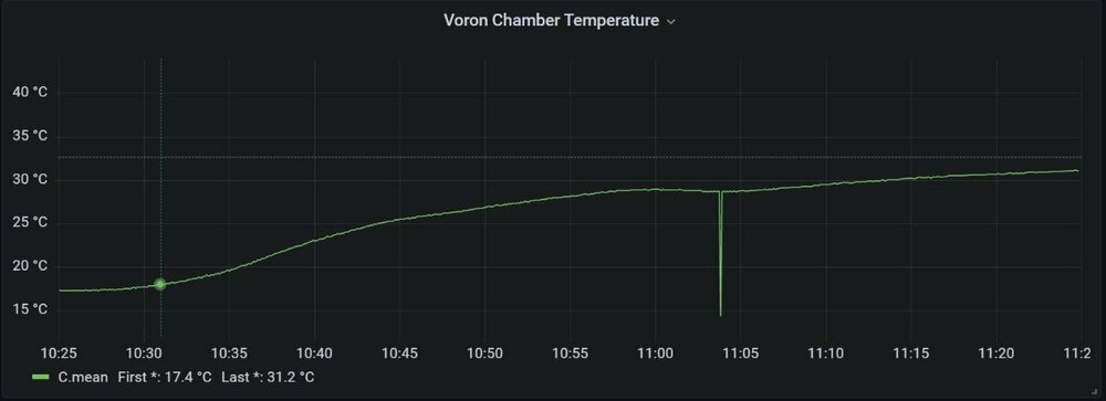

Test 2:
Only exhaust fan running. Ran from the beginning of the test at 100% and the entire time.
47 minutes start to 30C
31.2C after 1 hour

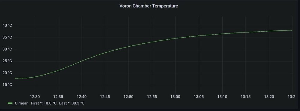

Test 3:
Nevermore only. Using the fan curve I listed above
22 minutes start till 30C
38.3C after 1 hour

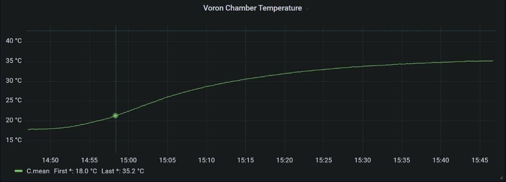

Test 4:
Nevermore with exhaust fan running.
26 minutes start till 30C
35.2C after 1 hour

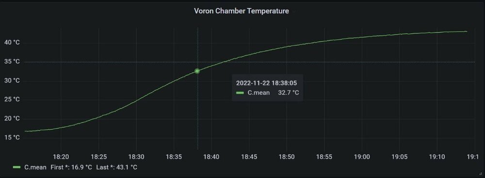

Test 5:
Nevermore and bed fans using fan curve listed above.
30C after 19 Minutes
43.2C after 1 hour

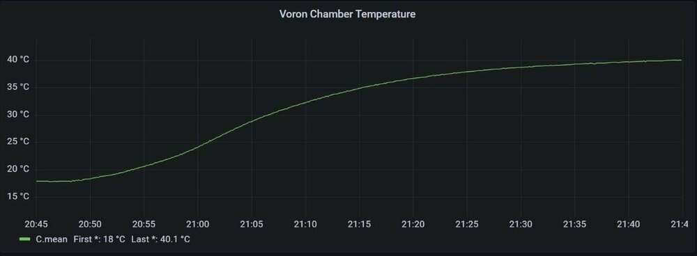

Test 6:
Nevermore, bed fans, and exhaust fan running.
30C after 19 - 20 minutes
40.1C after 1 hour

The other thing I don't feel great about is that the Nevermore pulls air from the rear, under the bed, and pushes it up the front. The bed fans pull air from the front, and push it under the bed towards the back. I feel like this is cycling more air around the bottom of the chamber and not pushing it around the whole chamber as efficiently. Ideally I should mount the bed fans somewhere near the back so they are also pushing from the back to the front, however I have a decontaminator bucket one one side of the rear and I haven't thought of a good way to set this up yet.
