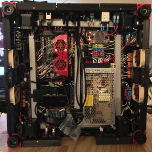

Here is a picture of the bottom electronic case for the LDO 300 kit build:
Here is the printer (building is half the job, doing the software - macros is the other half of the job):

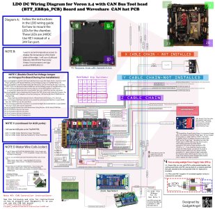

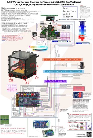

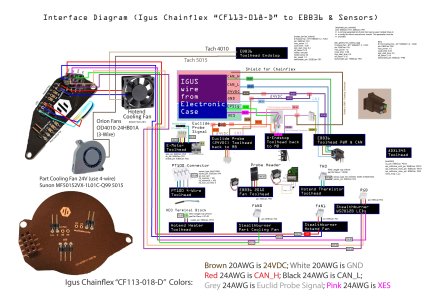

After I posted this I noticed that my drawings need to be updated to show the current state of my LDO build.
So here is my new set of drawing on 11/22/2022:
DC wiring diagram (CAN Bus toolhead with Octopus Pro board):1669115169417.jpeg

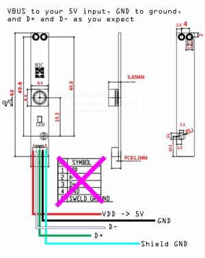

Wiring Harness Diagram:1669115254956.jpeg
Interface Cable Diagram (for toolhead board):
OV5648 USB Camera Module wiring:1669115792553.jpeg

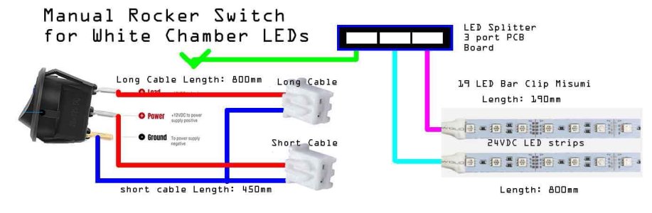

24VDC White lights switch diagram:
Continued on next entry

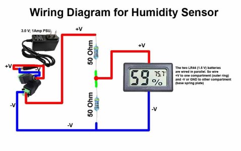

Here is a diagram that shows how to get rid of the batteries for a humidity sensor:
Once I finish up with calibrating the printer I will post more pictures to show off some mods I have made

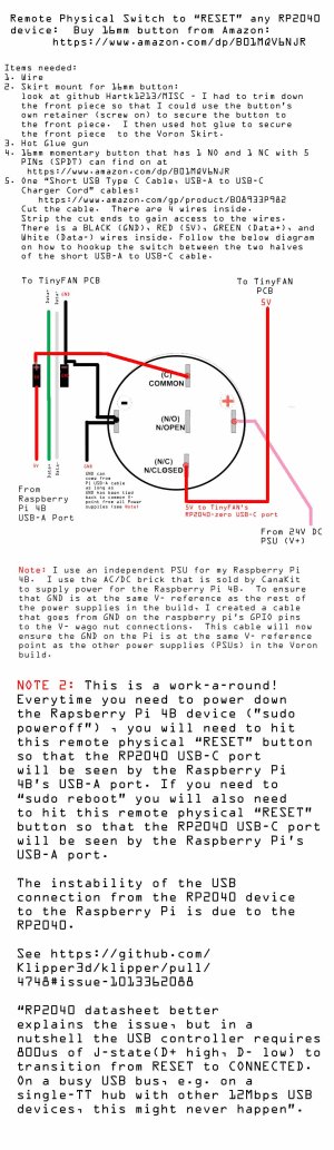

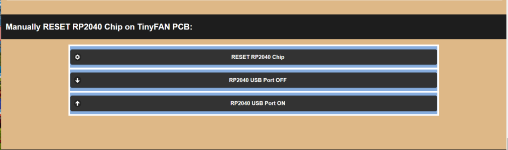

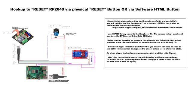

How to RESET the TinyFAN PCB (wiring diagram):
You will need this text file also it is an attached file called "Instructions for Software RESET of RP2040 chip.txt"
and the following two diagrams:
  • Instructions for Software RESET of RP2040 chip.txt

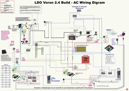

But for now here is wiring diagrams that I have created for my current LDO kit build:
Wiring Harness Diagaram:
AC wiring Diagram:

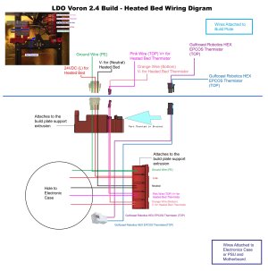

My bed pan Mod wiring:
USB camera wiring:

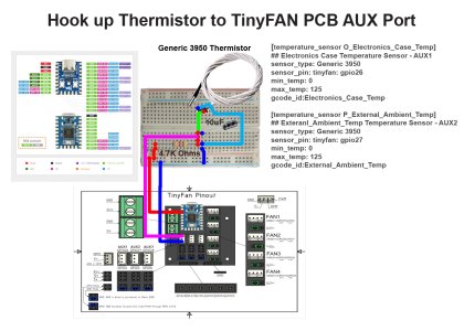

When I added some new thermistors to my build recently I had to attach two of them to the TinyFAN PCB (which I use to control my 12V hardware PWM fans).
The TinyFAN PCB can be found at: https://github.com/Gi7mo/TinyFan
If you want to use the TinyFAN PCB to read thermistors you will need to add a small circuit so that the TinyFAN PCB can read the thermistor. The following diagram is how I connected up a thermistor to two of the AUX ports on the TinyFAN PCB:
There is only one problem, [after you reboot the Raspberry pi (shutdown and reboot),] you will have to wait 6 minutes before the RP2040 on the TinyFAN PCB starts to send data back to Klipper via the USB connection.

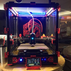

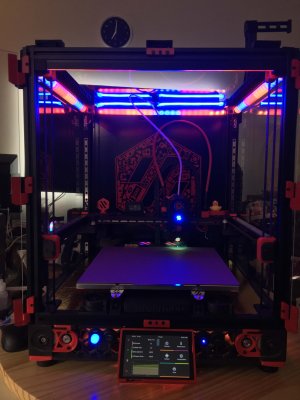

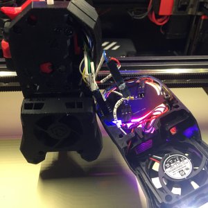

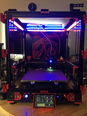

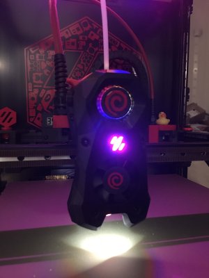

Here are two pictures which show some of the RGB lights attached to this printer.
This picture is a little bit darker:
There are three strings of RGBW lights (not including the SB nozzle lights, Whoppingporchard's Rainbow_Barf_Logo_LED, or the RGB leds on Hartk's "Two Part Stealthburner Toolhead Board LED Edition") that are controlled by two WLED webservers.
#1 string is the RGB Chamber lights. This string is 92 RGBW LEDs that circle the whole chamber.
#2 string is the Wire cover leds that are part of the bed_pan mod. This string is 24 RGBW LEDs
#3 string is the Electronics Case (kinda gives it a lower rider look). This sting is 102 RGBW LEDs

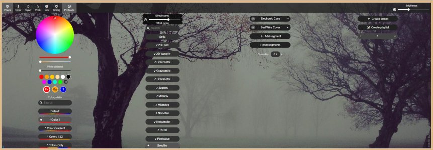

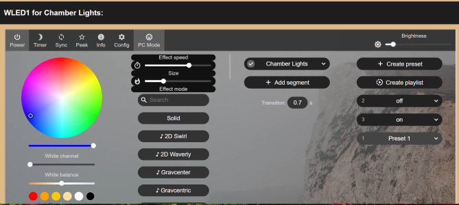

The WLED server is the "sound-reactive branch" of WLED which allows the LEDs to respond to music
Here is a picture of the WLED interface and I can control presets via moonraker.

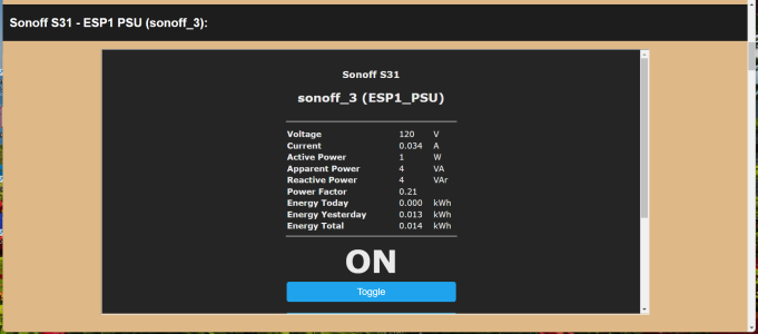

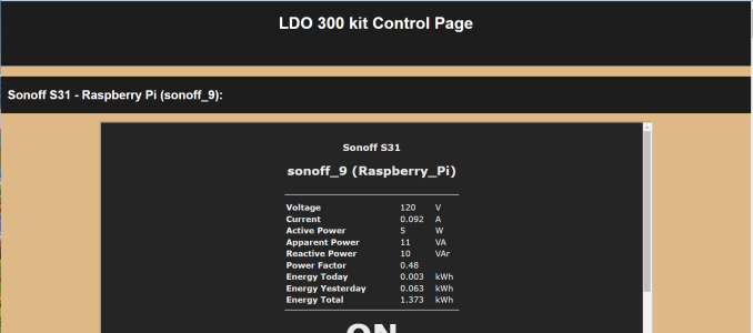

I also have a webserver on a separate raspberry pi that runs NGIX, PHP7.4-fpm and a mosquito broker for all my 3D printers.
By having a separate webserver I can control all my Tasmato power devices without having the (Klipper) Raspberry Pi for the printer up and running. Here is a picture of my main control page for my LDO 300 kit printer:
I have 10 devices on one web page (the webpage is too long to take a picture of the whole thing) that helps me control my LDO 300 Kit printer

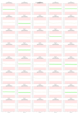

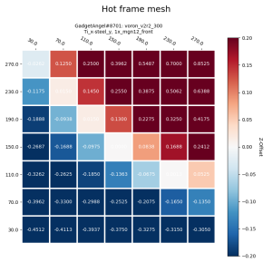

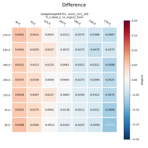

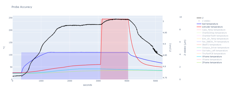

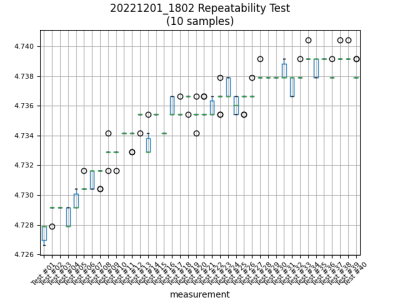

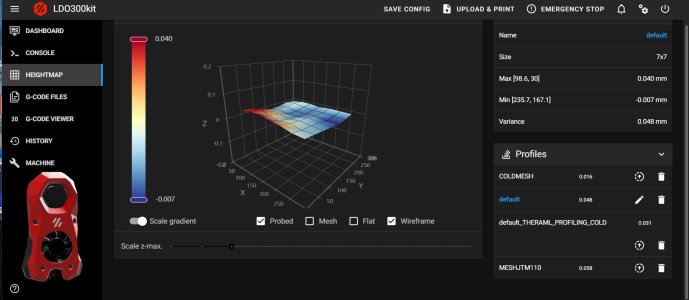

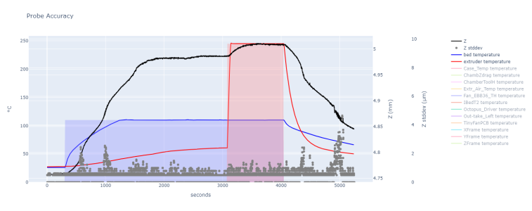

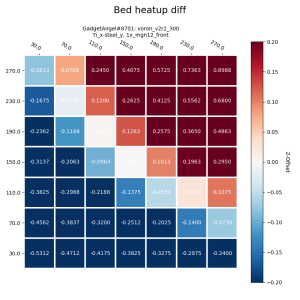

Here is the output from my probe accuracy tests (https://github.com/KiloQubit/probe_accuracy) done today (11/28/2022 at 10:30 AM EST)
I swapped out my Omron D2F-5L Microswitchs on my Euclid probe pcb and on my Z-endstop sexbolt pcb with "Kailh GM 4.0 Micro Switchs" (https://www.amazon.com/dp/B08K9FSSLH)
I have found that the Kailh GM 4.0 Micro Switch have a better standard deviation result than the Omron D2F-5L Microswitch!

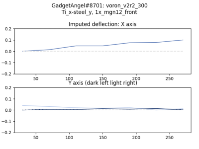

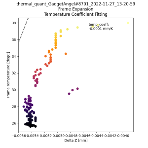

What I found interesting about these tests is that I get more temperature change on my X-Axis frame (mine is measuring the extrusion on Bottom back (right below the bottom of the back panel)) temperature sensor than I do from the Z-Axis (upper extrusion - back right corner when facing the front of the printer) frame temperature extrusion:
#1 This first graph show the Z-Axis temperature sensor and the X-Axis temperature sensor:
#2 This graph show the Zstdev :
Conclusion: I need to heat soak my bed with nozzle for at least 30 minutes so all the parts of the printer get stabilized at printing temperature. The

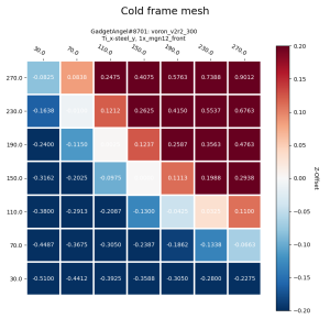

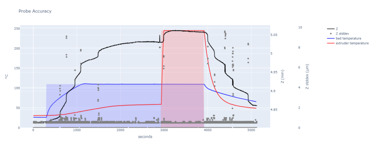

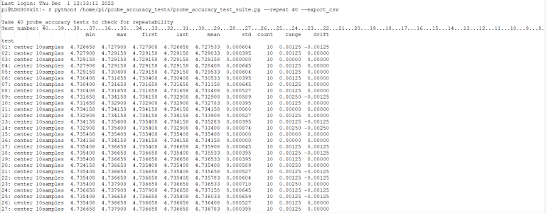

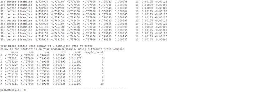

on 12/1/2022 I ran a probe accuracy test suite (https://github.com/sporkus/probe_accuracy_tests). Here are the results:
here is the output from the terminal window on the raspberry Pi:
Here is some of the output sent to the Mainsail console:
output from console:
6:09 PM echo: 35/40 repeatability ; this also get sent to the UI console output
6:09 PM probe: open
6:09 PM probe: open
6:09 PM PROBE_ACCURACY at X:150.000 Y:153.000 Z:15.000 (samples=10 retract=1.500 speed=10.0 lift_speed=10.0)
6:09 PM probe at 150.000,153.000 is z=4.739158
6:09 PM probe at 150.000,153.000 is z=4.737908
6:09 PM probe accuracy results: maximum 4.739158, minimum 4.737908, range 0.001250, average 4.738658, median 4.739158, standard deviation 0.000612
6:09 PM probe: open
6:09 PM echo: 36/40 repeatability ; this also get sent to the UI console output
6:09 PM probe: open
6:09 PM probe: open
6:09 PM probe accuracy results: maximum 4.739158, minimum 4.739158, range 0.000000, average 4.739158, median 4.739158, standard deviation 0.000000
6:09 PM probe: open
6:09 PM echo: 37/40 repeatability ; this also get sent to the UI console output
6:09 PM probe: open
6:09 PM probe: open
6:09 PM probe accuracy results: maximum 4.739158, minimum 4.737908, range 0.001250, average 4.738033, median 4.737908, standard deviation 0.000375
6:09 PM probe: open
6:09 PM echo: 38/40 repeatability ; this also get sent to the UI console output
6:09 PM probe: open
6:09 PM probe: open
6:09 PM probe at 150.000,153.000 is z=4.740408
6:10 PM probe at 150.000,153.000 is z=4.739158
6:10 PM probe accuracy results: maximum 4.740408, minimum 4.739158, range 0.001250, average 4.739283, median 4.739158, standard deviation 0.000375
6:10 PM probe: open
6:10 PM echo: 39/40 repeatability ; this also get sent to the UI console output
6:10 PM probe: open
6:10 PM probe: open
6:10 PM PROBE_ACCURACY at X:150.000 Y:153.000 Z:15.000 (samples=10 retract=1.500 speed=10.0 lift_speed=10.0)
6:10 PM probe at 150.000,153.000 is z=4.740408
6:10 PM probe: open
6:10 PM echo: 40/40 repeatability ; this also get sent to the UI console output
6:10 PM probe: open
6:10 PM probe: open
6:10 PM probe at 150.000,153.000 is z=4.737908
6:10 PM probe accuracy results: maximum 4.739158, minimum 4.737908, range 0.001250, average 4.738158, median 4.737908, standard deviation 0.000500
6:10 PM probe: open
6:10 PM probe: TRIGGERED
