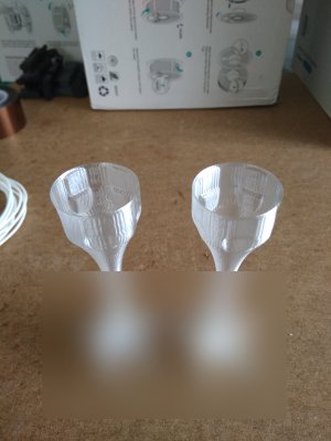

It is a Trident 300x300 with TAP. The noise appeared maybe two days ago. With the noise came visible artifacts. If you have an idea what I should look for, please share. Here is a video.
Sorry, I thought my question is not going to be published, so I deleted the video, and there is no way to edit the post. Reuploded the video, here is the link:
Meanwhile, run the TEST_SPEED macro a dozen times. It holds at 500 mm/s and 5000 mm2/s no problem. It happens only in vase mode. My guess it is not mechanical, but rather how the printer interpolates many short moves. Have to read more.
