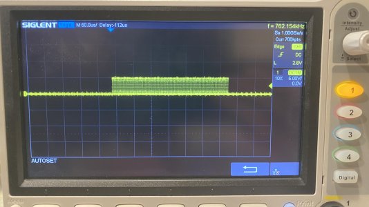

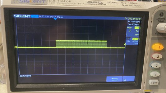

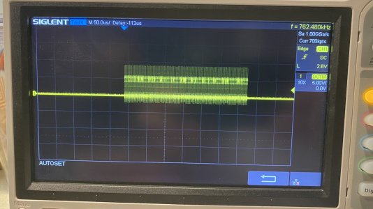

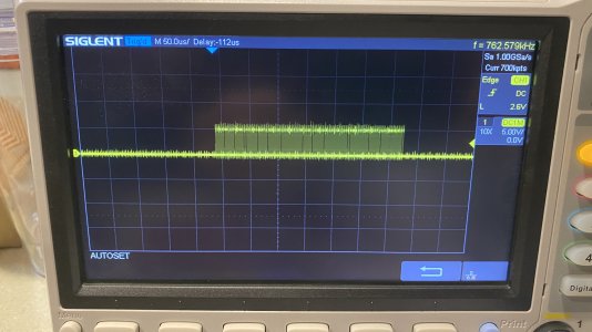

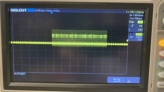

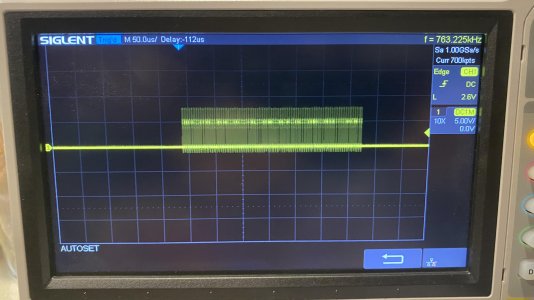

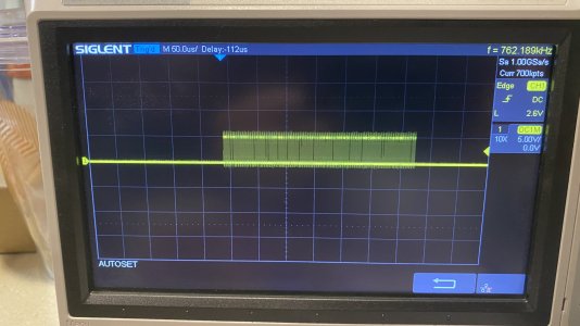

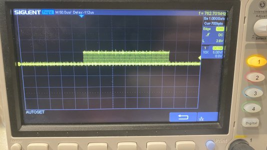

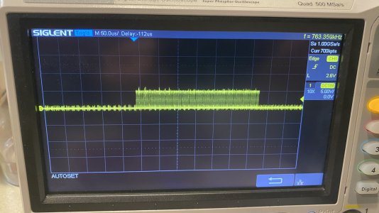

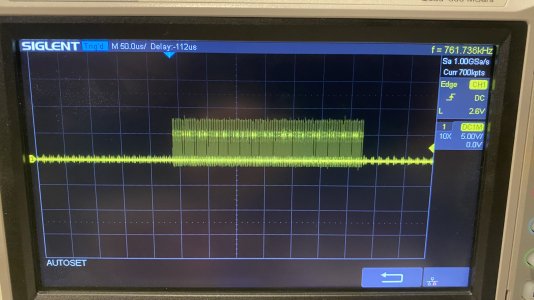

I had a similar issue today. Mine was caused by the extruder stepper motor. LEDs worked fine and never flickered until extruder stepper driver was enabled, then they flickered like crazy. Probed the LED communication signal at the toolhead with an oscilloscope and when the stepper driver was enabled a lot of noise showed up. It also seemed like the inductance of the wires might be causing issues because there were large voltage spikes to almost 10V. I was able to fix it and basically completely eliminate the flickering by placing a 220 ohm resistor in series with the LEDs data wire near the control board. The images below show the oscilloscope measurements for various scenarios.
No resistor, no capacitor, stepper disabled (low external signal noise, large ripple, voltage spikes up to ~9.5V)
No resistor, no capacitor, stepper enabled (external signal noise from stepper, large ripple, voltage spikes up to ~9.5V)
100 ohm resistor at toolhead, no capacitor, stepper enabled (less external noise from stepper, slightly reduced ripple, voltage spikes up to ~8V)
100 ohm resistor at toolhead, no capacitor, stepper disabled (no external noise, slightly reduced ripple, voltage spikes of ~8V)
100 ohm resistor at control board, no capacitor, stepper enabled (less external noise from stepper, greatly reduced ripple, voltage spikes of ~6.5V)
100 ohm resistor at control board, no capacitor, stepper disabled (no external noise, greatly reduced ripple, voltage spikes of ~6.5V)
220 ohm resistor at control board, no capacitor, stepper enabled (slightly reduced noise, greatly reduced ripple, eliminated voltage spikes)
220 ohm resistor at control board, no capacitor, stepper disabled (no external noise, greatly reduced ripple, eliminated voltage spikes)
220 ohm resistor at control board, 10pf capacitor at toolhead, stepper enabled (reduced external noise, greatly reduced ripple, eliminated voltage spikes)
220 ohm resistor and 10pf capacitor at control board, stepper enabled (almost no external noise, greatly reduced ripple, eliminated voltage spikes)
The 220ohm resistor in series with the data line at the control board was the least complicated with the 2nd best results. The 100ohm resistor reduced the noise more than the 220ohm resistor, however the reduced voltage ripple from the 220ohm resistor provides enough of a benefit to outweigh the slightly greater noise.
The 220ohm resistor in series with the data line with a 10pf capacitor placed after the resistor between GND and the data line gave the best results. Noise, voltage ripple, and voltage spikes were almost completely eliminated.
By watching the LEDs it seems that both of the options above perform similarly, with the occasional flicker every now and then (maybe once a minute) so personally I am going with the simpler solution of just a single 220ohm resistor in series with the data line at the control board.
My printer is a 350mm Voron 2.4, the required resistance or capacitance might be different depending on the size of your printer, wiring setup, and source of signal noise.
Hope this helps!
