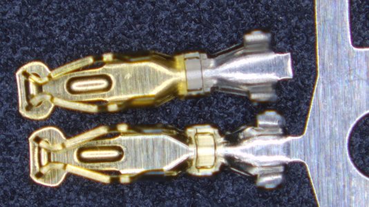

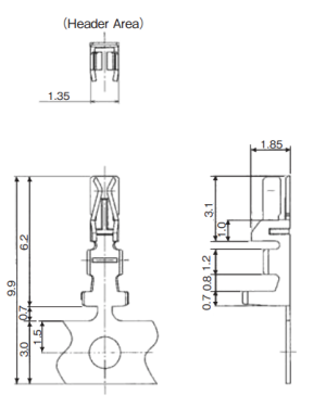

Dimensions of the male contact pins are 0.60 mm square, and they are spaced 2.00 mm. That's the dimensions of a JST PH, but this is most definitely NOT a JST PH. It looks like a shrunken Dupont style terminal, which I can find referenced only in a few places.

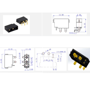

Here's some mechanical drawings lifted from the AliExpress listing for the XT30(2+2):

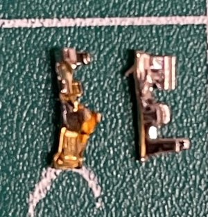

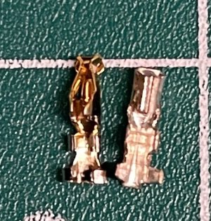

In the below images (sorry for the potato quality, these suckers are tiny), the XT30(2+2) mini female is on the left, and a JST PH female is on the right.

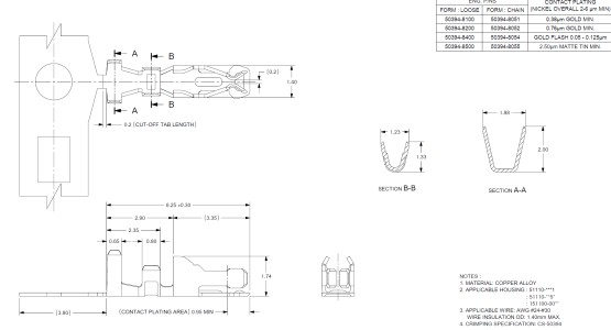

Courtesy of Boxxy, here's a listing for something that looks similar, but the vendor is out, and I'm not in Europe. See the BLMT-CT section at the bottom.
