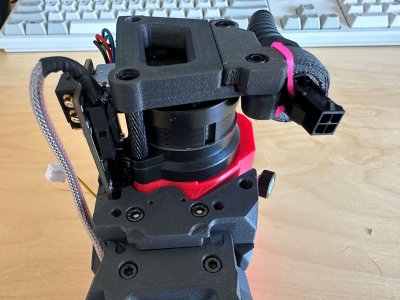

Hi team!
I am not sure how to deal with that XT30. I want to use the IGUS CF9, and that's not easy with this connector. The insulation on the CF9 is very heat-sensitive, so it melts while I am soldering it. The data pins— JST PHD or Hirose DF11, whatever they are—are also not easy to deal with. JST states the max wire gauge is AWG22. CF9 is 20AWG. I hope that with the JST WC-610M, it will be possible to overcrimp the 20AWG there.
However, it may be that a different approach is more sensible—to do a jumper with XT30, 2x18AWG FEP wires, and 2x22AWG on one side and MicroFit 3.0 on the other side.![IMG_9860-smll.jpg IMG_9860-smll.jpg](https://forum.vorondesign.com/data/attachments/4/4579-9bf39ba1ea2b109053d86c30295ccedf.jpg)
And remix that PG-7 gland to keep the MicroFit 2x2 Male in place properly.
What do you think? Or is there a better way to deal with SB XT30?
