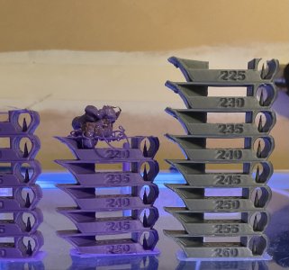

Was in the middle of printing a Temp Tower in Orca and on the beginning of the fourth level I started rubbing, I guess and watched the tower get knocked over.

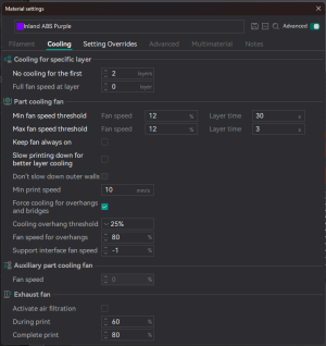

Here are my cooling settings, just in case they're a factor:
From left to right, my temp towers kind of progressed with Z-hop
3rd is .4 4th is .8, it seems if I get to the higher towers, it’s luck…

I’m at 50mm and the weird globing is happening. Must be from wiping/rubbing, but I don’t hear any collision with the tool head.
Got this one on a megabrim…..
I see now….
Layer shifting at about 40mm
odd... the last print was 90mm with no shifting, just that glob around 50mm

I am a little confused on what is happening here. Seems like you are getting layer shifts.
Is your stepper drivers over heating? What cooling do you have for them and have you tried other drivers besides 2209's?
