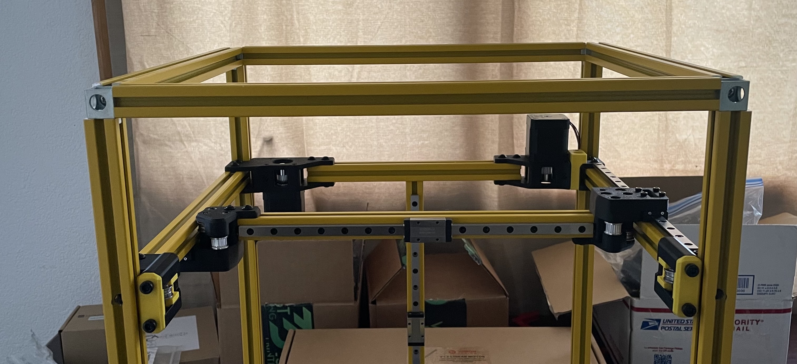

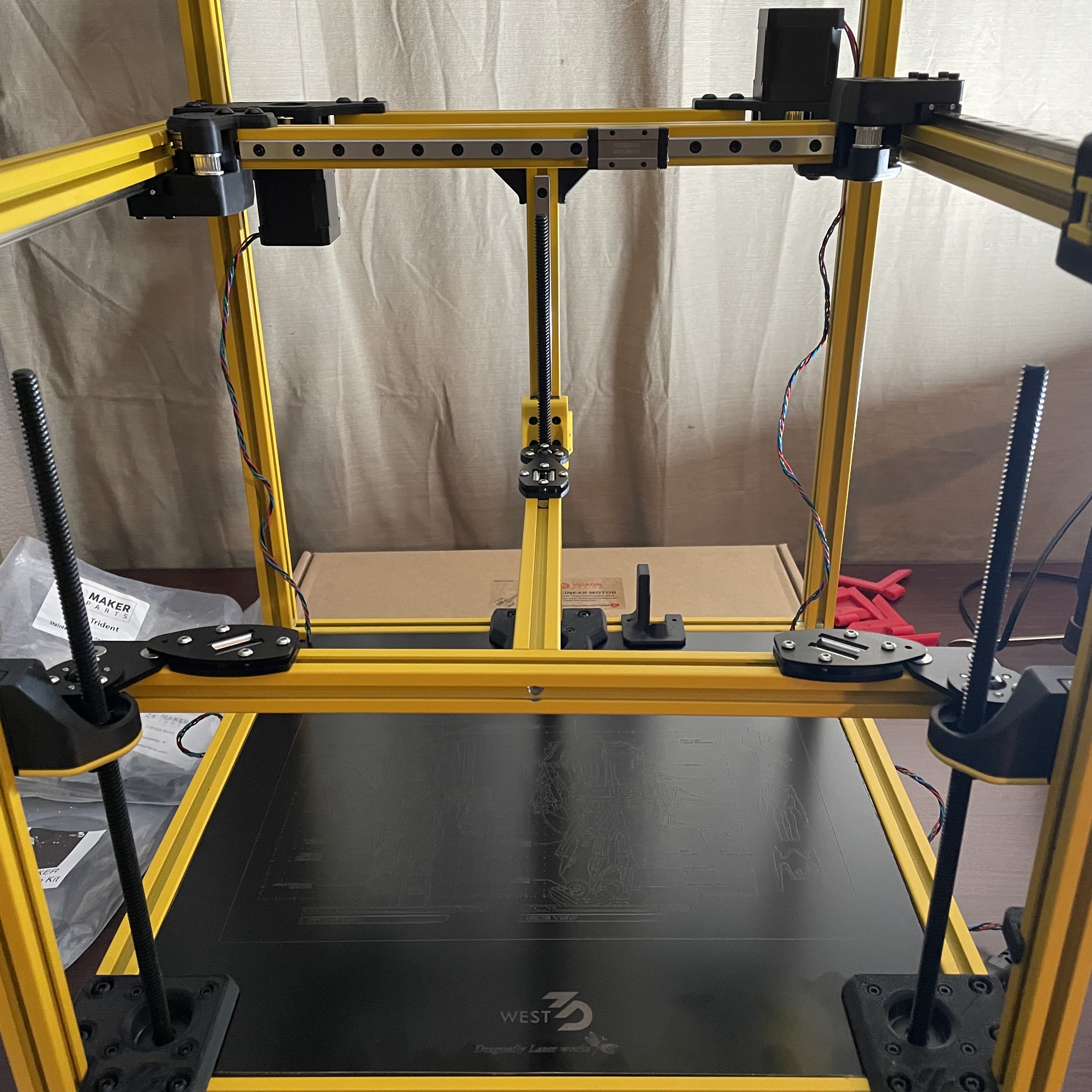

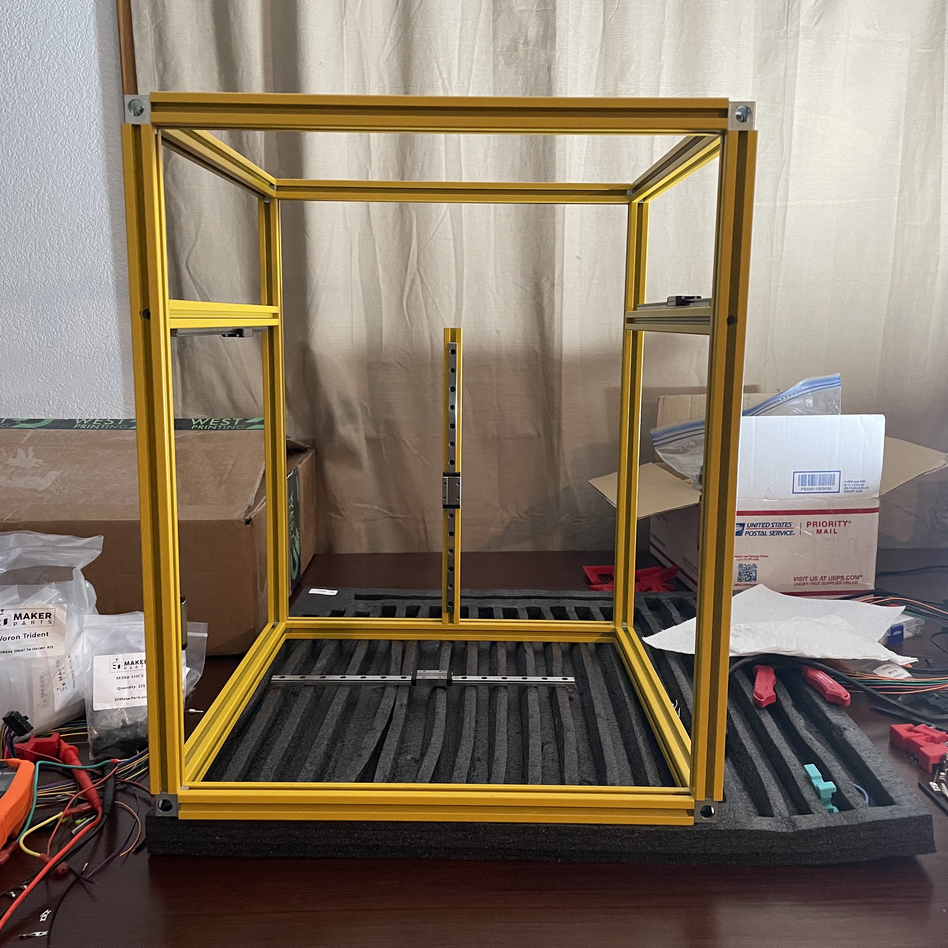

To celebrate @hartk finally starting a Trident build, I'm doing another one too. But this one's gonna be a little different…

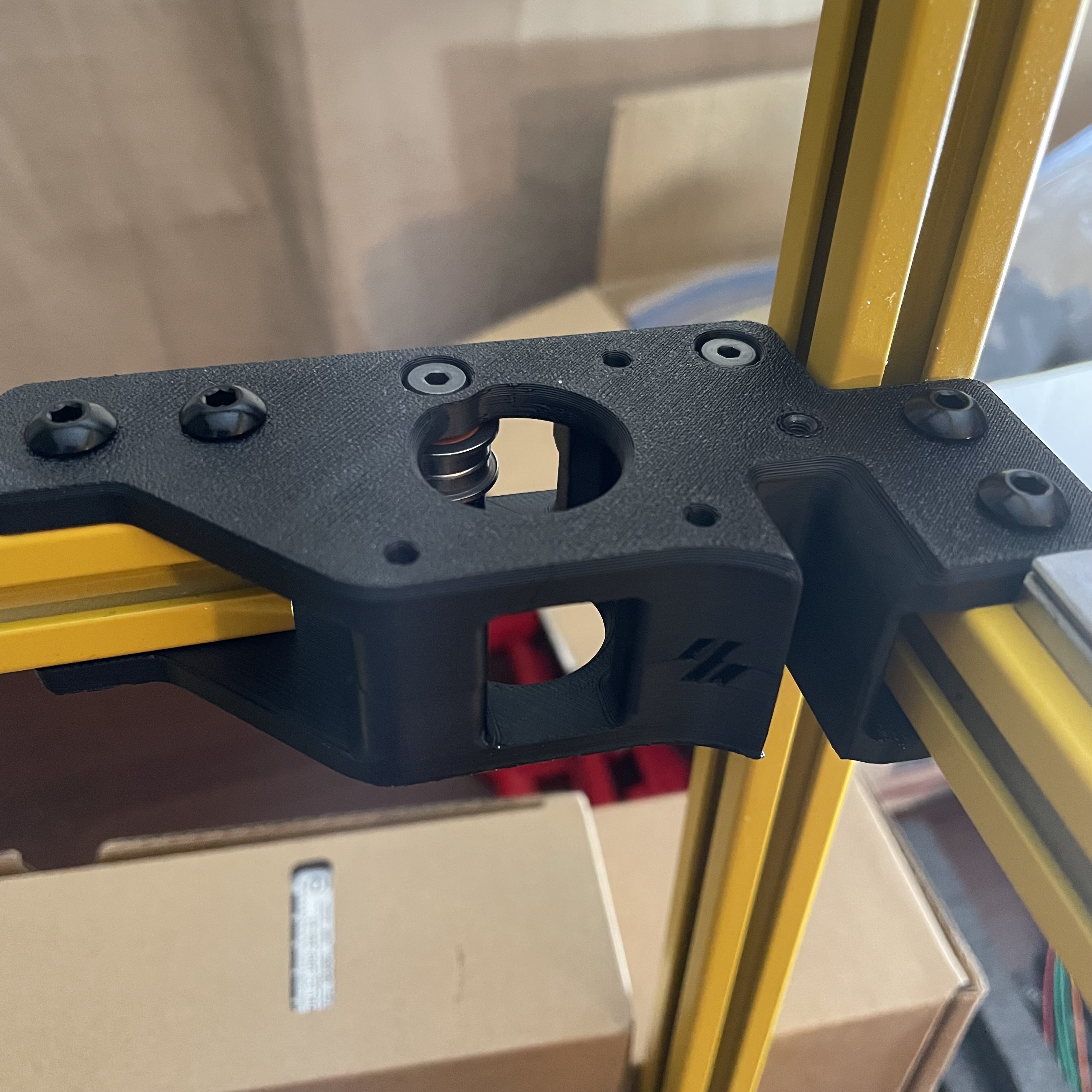

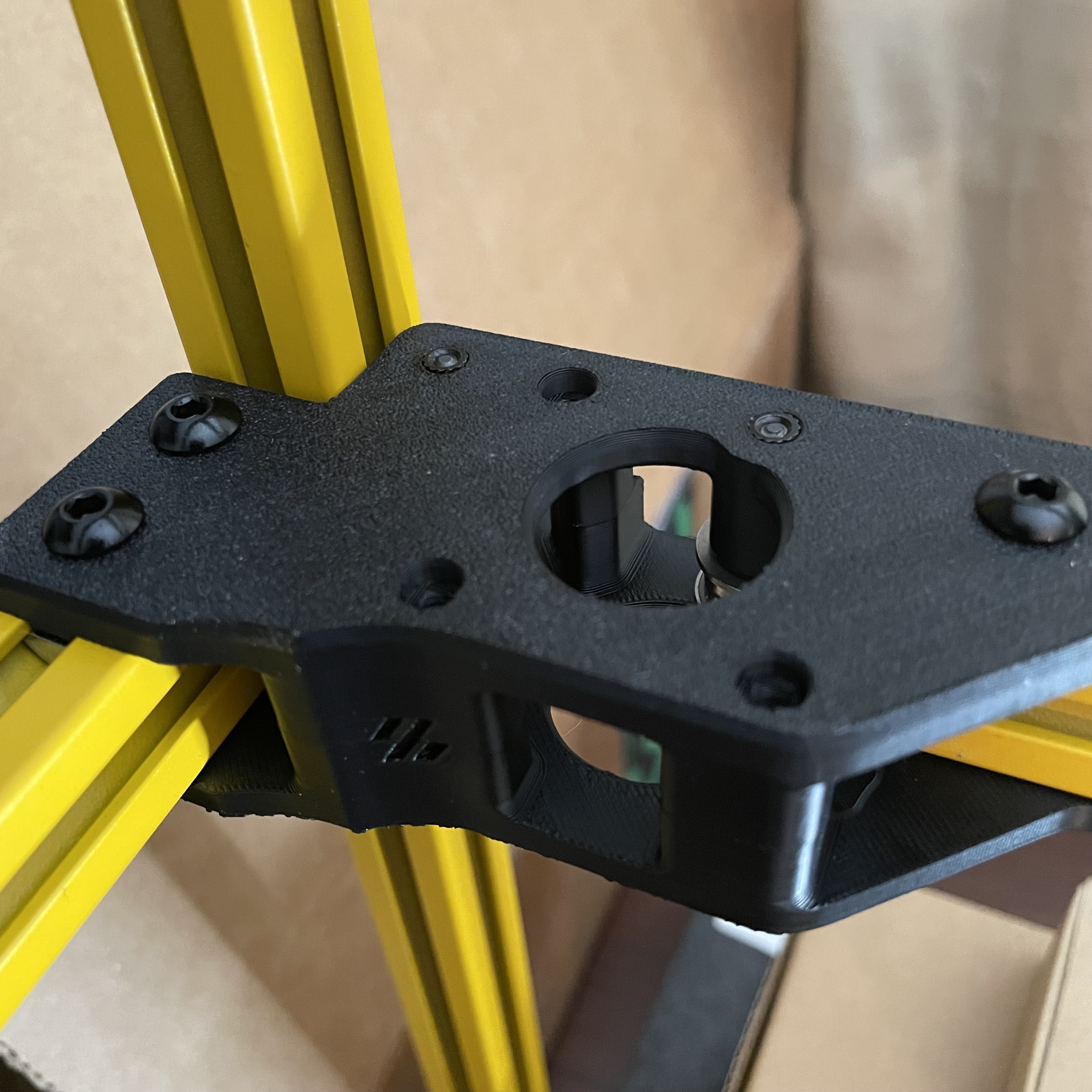

I made some modifications to the A/B drives. One is, all of the bearings are riding on MSB5-20 Misumi shoulder bolts now, which are threaded into M3 heatset inserts.
I also added MSB5-20s to the XY joints, and yes, I'm going a little off-book here.
Also testing out some new front idlers, which I'm calling BFI for "Beefy Front Idlers".
I'm really looking forward to how the IS comes out compared to a normal trident, given it appears you're normalizing your weight balance with the flipped XY joints. Who knows though, looks fun tho
Looks like a fun project. I am not sure the benefit you will gain other then you can maybe go a little tighter on the belts?

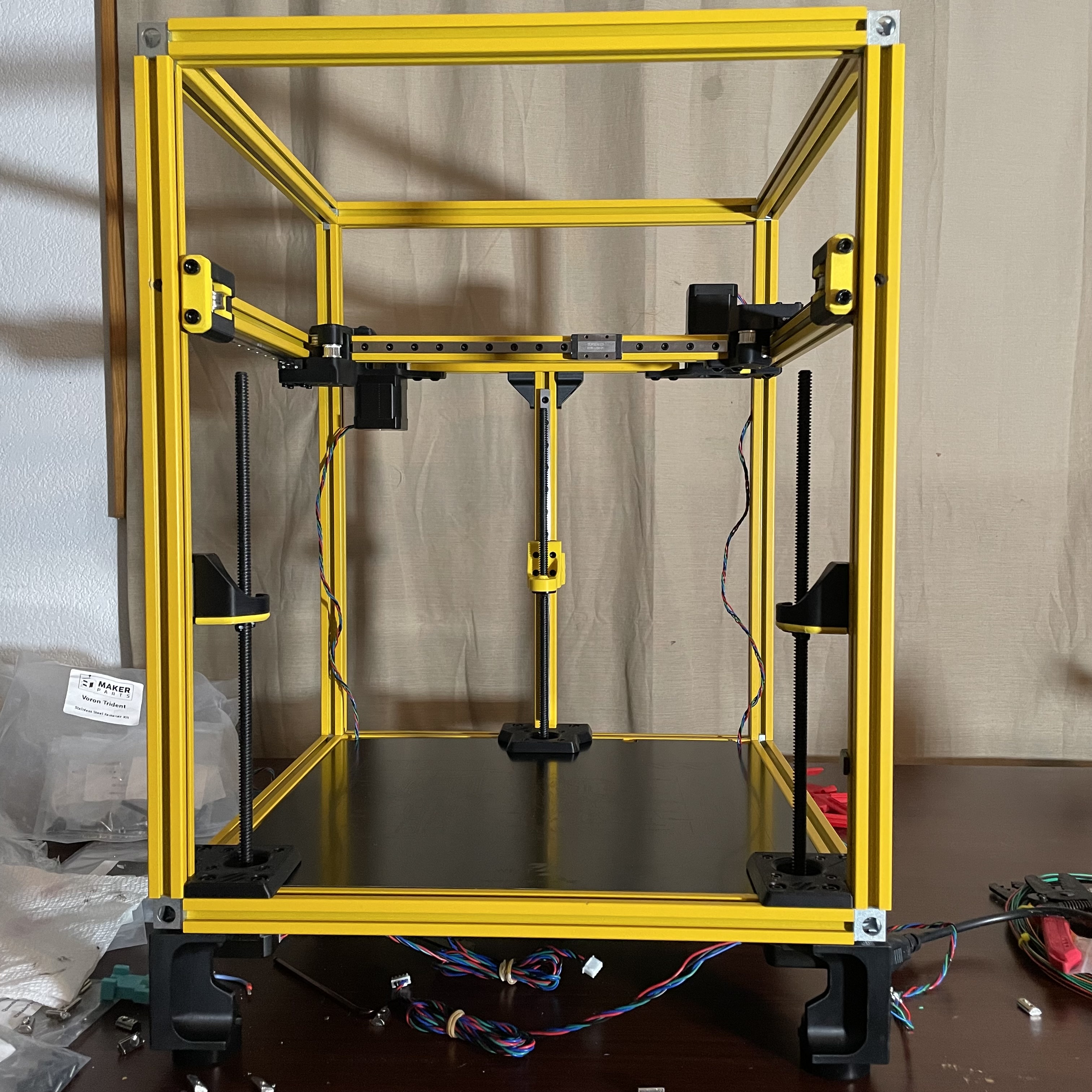

Took a little while figuring out where to upload more images because I don't trust Discord to keep happily hosting them here. In the meantime, I've made some more progress with the build.
Z joints mounted to Z rails

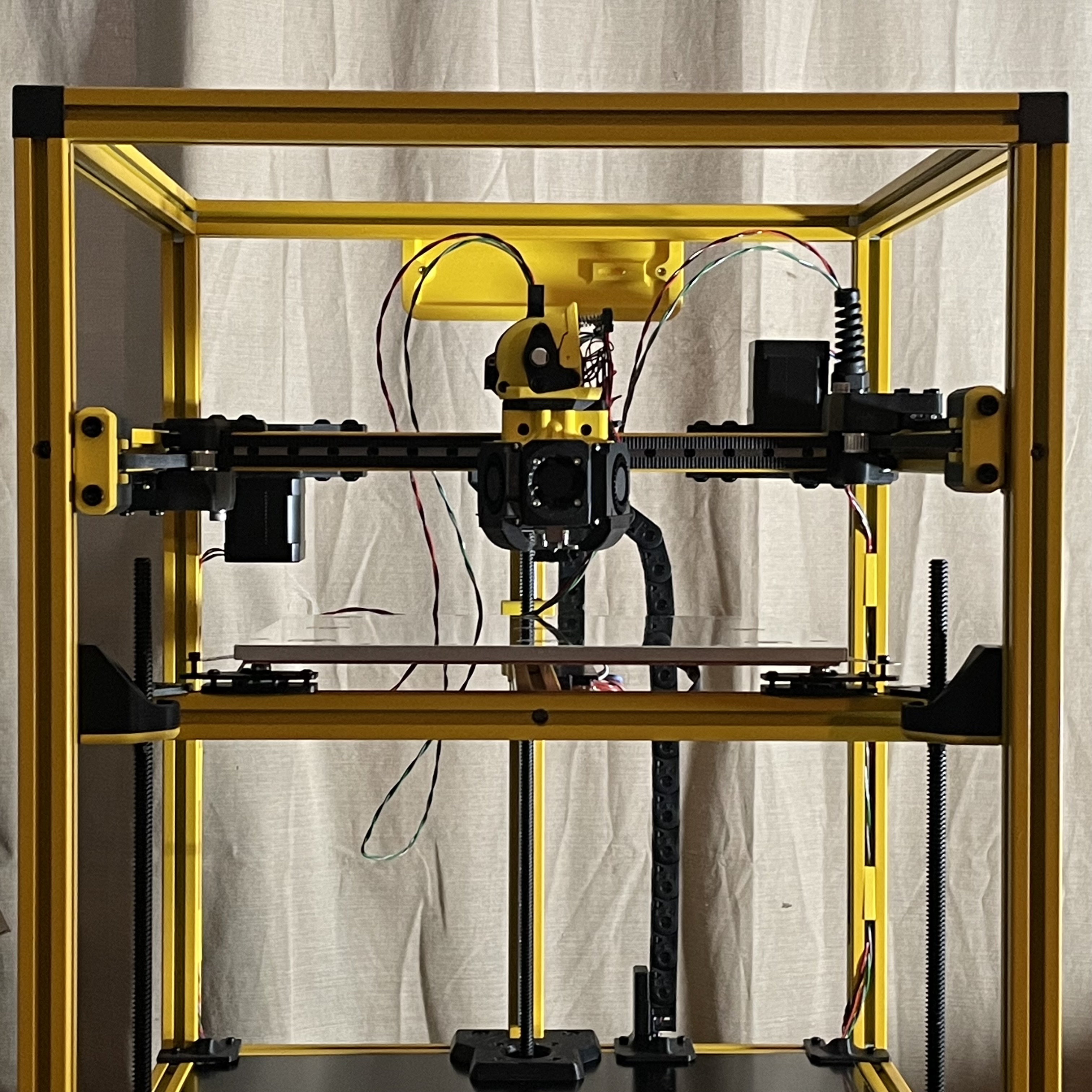

Installed whoppingpochard's kinematic bed mount on the bed frame

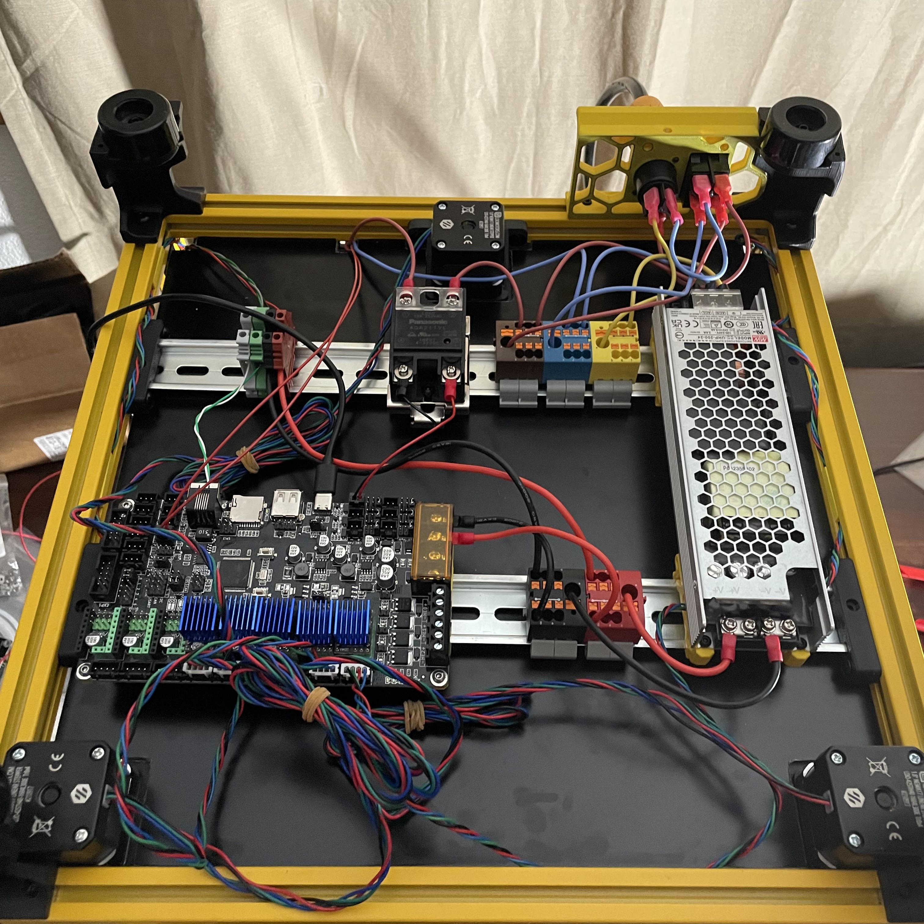

A little "rest of the #*$!ing owl" here… got the bed installed and wired through the Z chain, got the toolhead installed and wired over CAN to an EBB36…
And a little electronics-bay wiring shot.
The goal here is to be able to have equal tension on the belts without worrying about accidentally bending a motor shaft. I'm not sure how much tension this gets you beyond stock because I wouldn't even know where to start the simulations or calculations for that, but moving the belt tension 10mm closer to the base of the motor seems like a good idea to me. Even if it does look a little funky.
It makes sense. it's like modding a car, you might do something that has a tiny gain, but lots of tiny gains can equal lots of success. I will be looking forward to hearing your findings.
