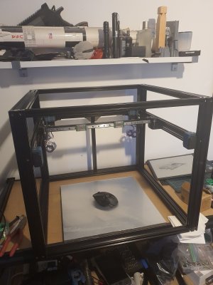

Been working on a large format Tridex. Currently its up to the point where I can home both tool heads and run some x/y tests.
Frame assembled and x/y belted up.

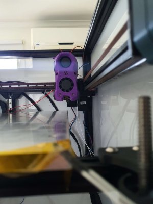

Euclid Probe & Heated bed is installed & wired up.
Euclid works really well, expected more jank from the docking system.
The bed mesh is iteresting, there's a twist in the far side where it's only supported in the middle. Not sure what's causing it. It's there both cold and at temp.

I had similar bed mesh, tilting just the same. I have ended up improving by packing it out with tape. As you said, there is no mounting points in those spots, so hard to adjust. With tape I was able to get it to +- 0.15
Y rails not parallel?
Thanks guys, didn't even consider that. After remeasuring and adjusting the rails it went from a 0.38mm variance to 0.28. So I think you're correct in it being skewed rails.
Putting them equal distance from the top is close, but I think there's something slightly off with the frame, so I'll just adjust them until it's level on the mesh instead of to the top extrusions.
