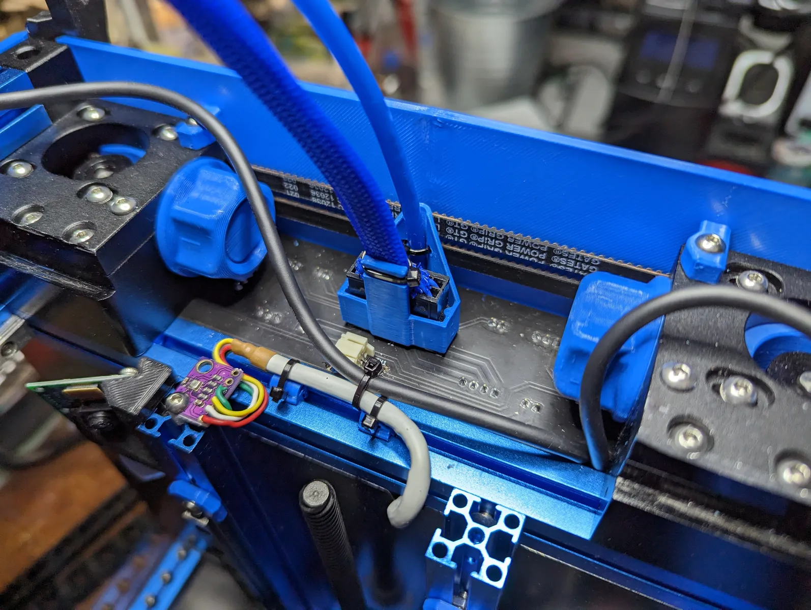

Kirigami Bed Frame​
The Kirigami bed frame is overall pretty great. The one Formbot provides seems quite rigid and the flanges that mount to the carriages actually seemed quite co-planer right out of the box. I only had to minorly tweak them a bit. Compared to other frames I've seen on the V0 Questions Discord channel it initially seemed quite good.
It's really important that these flanges are as coplanar as possible. Checkout the Kirigami Manual github for more on how to make sure the frame is square. It also points out all the correct printed parts you need. My cPIF parts came with both Kirigami printed parts and the stock V0 extrusion bed parts.
And here's where the first 2 issues with the Formbot V0 bed showed up. I ran into these problems, and others on the Kirigami Github have noted them. On Discord ppl have said they ran into them, while others have said they haven't at all.
Basically the thickness of the Formbot frame is quite thick. It should be 2mm +/- .2mm. This caused some of my printed parts (particularly the new stealth parts to not fit onto the frame.
In particular the "Stealth" Chain Mount Block and "Nut Block" didn't fit because of the thickness of the frame. I don't think the print quality was an issue. Everything else in the build went will in terms of the printed parts. BUT, perhaps folks that didn't have issues with the frame had a lower extrusion/flow rate. Not to say they were under extruded. But as you know in FDM prints .2mm can mean the difference between a part fitting as intended, fitting too loosely/tight, or not fitting at all.
Some folks on the Kirigami GitHub frame noted that they contacted Formbot, who provided them with their own remixes of the printed parts. But didn't have success with them. I initially tried filing out some of the material that seemed to be causing interference. This worked ok for the chain mount. But the Nut Block ended up being something I had a lot more trouble with.
A quick solution to this is using the older "Non-Stealth" version of the nut block. It doesn't wrap around the flanges of the frame and won't push them out of being coplaner. A Stealth Nut Block that is too tight will push out the flanges and likely slightly bow the fame.
(Cont'd in next post)
Kirigami Bed Issues Cont'd​
I ended up using the non-stealth version of the Nut Block after initially trying to file a way a bunch of material to get the stealth version to fit. From what I can tell the differences in the parts are purely aesthetic.
The stealth Chain Mount initially worked after I shaved away some material but it ended up breaking later so I reprinted it with a lower extrusion multiplier and the second part fit easier after some adjustment.
After getting all that assembled I found that when I finally attached the bed frame to the Z Carriages the axis just didn't move quite as easily as I expected. There was no real binding. But when I set the fame up on it's end the bed wouldn't just fall from it's own weight. That isn't strictly speaking necessary. But I wanted it to.
I believe what was happening here was just that even with the non-stealth nut, the carriages were just slightly over constrained. The frame was ever so slightly torquing them out of perfect alignment with the rails. I finally diagnosed this to have to do with the fame holes used to mount the nut block and carriages. They were very tight when I put the screws through them. To the point that it was difficult to get the screws through the holes.
These holes and screws need a bit of wiggle room to allow the rail carriages and flanges to self align such that the carriages aren't pushed up against the rails in a bad way. I solved this buy slightly filing out the wholes of some of the paint.
After doing this and switching to the non-stealth block the bed fell under it's own weight and seemed to move better.
