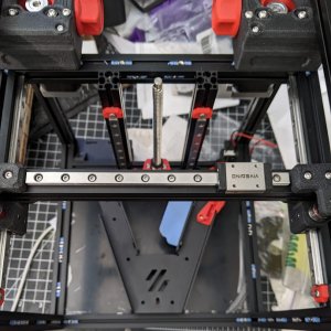

Linear Rail prep​
Since it needs to sit in a bath, I figured I’d do all four of the non-preloaded rails before I got started on the actual assembly
I decided to follow the written docs on the LDO website because I hate videos. Basically, 10 minutes in 90% Isopropyl Alcohol in the cute little individualized birdbath to get the grease off. And then SuperLube 21030 is one of the suggested greases.
I printed a pointy tip that goes on the tube, except that turned out to not work very well because in order to get enough pressure to force it as per the LDO instructions, I ended up squeezing it hard enough to make the SuperLube tube burst. So I switched to a disposable dispensing syringe and then that worked better.
(I have a bit of skepticism about the whole “shipping oil” thing, but I’ll do it anyway. For my bike, a lot of people went on and on about how the oil that comes on your chain is “shipping oil” as if the bike chains are sitting on a boat deck getting salt spray on them and a bunch of Actual Bike People With Mechanical Engineering Degrees explained that actually the chains are dipped into hot oil and it’s probably going to last longer if you leave it on. You are invited to try this on your time.)
This has actually been the most annoying part of assembly so far.

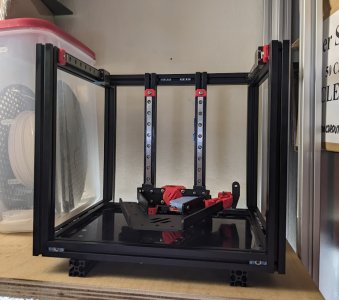

Frame - Z Rails​
  • The nut bars feel a little flakey. I can’t necessarily critique the way that Formbot printed them because I pulled them into my slicer and they are really tiny minimal parts and I’m not sure I’d do better on my Ender. As such I opted to assemble them with the nut bar facing towards the linear rails and the nuts facing the extrusion rail, however this means that the M2 nuts want to pop out and get stuck where the screws can’t quite reach. ChrisA, who is building roughly the same printer at roughly the same time points out that the nut inserts are better in many ways than the threaded bar because the steel would make the beams bow when heated and also add weight. I’m assuming that the effect that makes the extrusion backers isn’t going to happen here because the steel is exactly in the wrong place so I’d tend to agree with that logic and would also add that M2 threads are delicate.
  • First error of assembly: On Pg 26, you are adding stoppers to one end of the Z-rails but leaving the other side alone because you add those later. I added stoppers to the wrong side. No biggie, I guess the angle that the image is rendered makes it a bit unclear.
Frame Z-Axis​

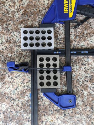

  • My technique for squaring the frame is to use 1-2-3 blocks with little clamps as the right-angles and I used my granite countertop as the flat surface.:
  • Minor surprise here on pg 35. There are exactly 5 railstops. I had exactly 5 railstops in the kit. I kinda breezed ahead-ish and figured that I was missing either one or three railstops. Oops! Let’s keep going.

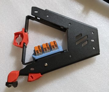

  • Okay, now things get weird. My Formbot kit comes with the Kirigami bed so I skip a bunch of pages.

Frame - Z Axis​
  • Second error of assembly: Everything went together fairly well except that now I need to move the Z-beams a lot from where I had them set up initially. After looking back, I realize I’d set them ~58mm from the outer edge of the H extrusions, not ~58mm from the inner edge of the H extrusions, so I ended up having to do a bunch of re-squaring.
  • Mounting the bed on the Z rails was annoying. It turns out that the best approach was to grip the M2×4 screws with my tiny tweezers, apply threadlock, and then kinda drop them in while wearing my magnifiers. Which is extra-fun because I don’t have depth perception.

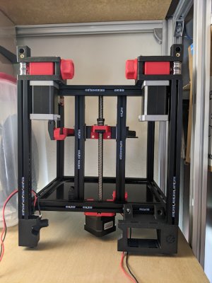

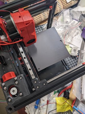

A Drive​
  • Conveniently, the parts for the A and B drive are roughly assembled which means that you do a little less hunting for parts.
  • Other reviews commented on the spacer shim washers being of low quality. I’m using just a plain old pair of calipers but I’m measuring a fairly wide variation in height, plus they don’t look especially well fabricated. Conveniently other folks had mentioned this and so I’d gotten some rings from DFH and they seem to be a lot better such that every one I have is within the tolerance of the calipers to each other. I’m using the supplied washers as washers instead of shim washers where the instructions are just calling for a plain old washer. Coincidentally, while I was building the A/B drive, the same thing came up on the Voron discord as well.
  • I’d gotten some bearings on an auspicious day in my spouse’s faith because I was planning on getting the zero but wasn’t ready to deal with building it so that I’d have the printer “started” on an auspicious day, so I used some in the A drive instead of the supplied bearings.
  • Okay the manual says to use temporary nuts to keep the whole thing from falling apart but doesn’t say when I’m expected to take them off… so I left them on.
B Drive​
  • Second mount went much faster. Maybe I just need to build more Vorons?
A/B Drives​
  • Ah, now I know when the temporary nuts come off of the A and B drive!
  • This is the first time I had to back up a bit. Not because I’d not preloaded a nut but because the preloaded nut I was using was bad and so I had to put a fresh nut in. Not sure if I used one of the kit nuts or if I used one of my existing nuts.

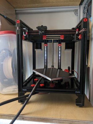

Summary and future planning​
A few other things meant that I had a bit of time with the printer sitting on it’s shelf and hadn’t gotten to doing much assembly.
I guess now it’s starting to be clear where a lot of the things go and, looking at the mods I’m planning on applying, where I need to make sure the screws are preloaded, etc. So I spent some time checking the DIN rail mounts, the ZeroFilter, etc.
The Z-axis install is actually the fiddliest part, at least partially because the community moved over to the Kirigami bed as the standard, but also because the manual is itself a bit confusing because it’s trying to accommodate the entire space of possibilities for a leadscrew nut.
And one of the problems with ABS-GF for all of the parts is that a M2 self-tapping screw is not super-excited about ABS-GF, especially the Philips screws that came with the Formbot kit.
I am pretty sure that I am going to end up re-doing the feet and skirt, either by just making my own darn design or because someone’s got one that looks nice and fits my needs. This is a Voron, after all. The primary problem, and one I don’t have a clear ready-made solution for, is that I’m not using the spool holder and I want to be able to swap spools without moving the printer forward on the shelf. I need to see how things are looking as I get closer to done to decide what my best version of filament feed and drybox location is going to be.
This work session aligned to the 8th anniversary of Voron’s release

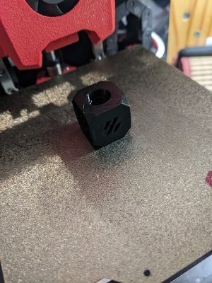

No-Drop nuts and the edge cases​
It’s an understandable problem… but there’s a lot of context required in the Voron community because everybody’s building out their printer, applying customizations, and not everybody’s a documentation writer and it’s a lot easier to distribute STL files and a lot harder to distribute valuable context.
Part of my goal of writing up my build log is to write at at least some of the context, as it is when I built the printer.
Ergo, the story so far on No-Drop nuts:
You probably want to print the No Drop Nuts from the f-zero repo that never made it up into the users repo because they seem to be a lot less fiddly, assuming that you can get them to stick to the build plate. I like PET or PET-GF because it’s extra-sticky!
So far, the cases where No-Drop nuts will interfere:
  1. Four nuts on the front door.
  2. One nut on the back skirt where the power socket screws in.
The second one is a bit of a problem, but since I’m probably going to redo the skirt regardless I’ll leave one screw out. The first one I am catching in time to replace it.
There’s a set of 10mm NoDrop nuts that should be good for the front door. What I did instead, and in a few other cases, was sandwich an extra bare nut between two NoDrop nuts.

X Axis​
  • I’ve had a few cases where, because of the angle chosen in the manual, I spent a bunch of time digging through the 3D printed parts box trying to find something, only to realize that it was there the whole time. The XY joints are some of those parts. In a few cases, it would help to show the opposite side of the part, I think. Then again, I am running out of 3D printed parts in the box!
  • The M2x10 self-tapping screws are annoying. I finally found one bit in one driver set that seems happy driving them? It’s a PH-0 from a frighteningly cheap Harbor Freight set.
  • Instead of pre-loading a nut and then screwing the bolt in, I instead decided to just insert the two brackets with the screws and nuts already inserted, which means that I don’t need to think about the No Drop nuts and it also makes the whole thing less annoying.
Summary​
I ran out of weekend before I worked up the energy to actually cut the belts, LOL. It’s a very imposing thing!

  • I was overly generous with M2x6 BHCS screws for the rails and so I needed to do a bit of disassembly to get a few out of the rail. Oops!
  • Instead of a pre-cut belt, I get 3 meters of belt. Apparently SrgntBallistic’s one easy trick is to run one belt, leave a little excess, and then use that as the length for both. so I did that. I just wrapped a piece of blue tape around the cut mark and that worked well enough. Also, it turns out that, out of the random 3D printed spudger and poking things that I’ve printed, the spudger pencil from orax’s set was most helpful for me to get the belt going.
  • I’m not sure if I made my life harder at some point, but it really feels like the Belt Tension tool should be included as part of the “tools” subdirectory because I am really really really trying not to get my hands and wrists any more screwed up from where they are. Also, apparently the way to go is to use the Gates Carbon Belt tuner - use Motorcycle mode - because it’s presumably doing a little better at the less-guitary more-thumpy tones that a belt is going to produce.
Print bed​
  • I got the Fabreeko edge-to-edge bed heater and magnet plate so I’m using those to build it out instead of the standard bed because folks were complaining about not quite being able to use the full build-plate of a zero on account of the magnets not being strong enough and the heating for the bed being a bit uneven.
  • The Fabreeko magnet plate didn’t come with holes drilled or anything, so I applied it using the instructions on the video the manual links to and then I took a 2mm drill bit, a 3mm drill bit, and a 5mm drill bit from my metric drill set and carefully manually twisted them inside of the drilled holes to get the access holes drilled.
  • The Fabreeko edge-to-edge bed heater comes with the cables all lovingly bundled with a JST connector on the end… but now I’ve gotta cut into the cable bundle because there’s a 150 degree thermostat for safety… but not a thermal fuse.
Summary​
Reaching the end of the build, it feels like. I need to mount the build plate, build the toolhead, and then it’s “just” electronics. Which is good, because “Why the heck is everybody ordering 100mm and 200mm MakerBeam XLs all of the sudden?” day is coming.
As I said last update, it feels like I’m reaching the end of the build?
I grabbed the manual and the remaining parts and was able to fairly quickly sort the remaining 3D printed parts into a few small ziploc bags.
Print bed​
  • In the absence of actual documentation, I’m going to assume that what I’m meant to do is to screw the thermal fuse to the bed with an M3x10 screw and use one of the “shim” washers that aren’t accurate enough for shimming the idlers and pulleys between the screw head and the thermal fuse.
  • There’s kind of a wiring mess here and I’m not entirely sure where the bug lies. You cannot fit a 2 pin JST-XH connector through the cable chain, but both the Fabreeko and stock beds come with a JST-XH connector that’s been helpfully crimped, which means that either you are going to end up leaving a pair of wires dangling, or you have to improvise in one direction or another, either cutting-and-joining or crimping on a fresh connector. I’m not sure what the right “fix” is for this.
  • I carefully sliced apart the Fabreeko cable protector without cutting any of the wires, then I cut the heated bed wires to the right length to hook them up to the Wago 221 terminal blocks that I had printed the Kirigami mount for myself because it didn’t come with the kit. And then I ended up cutting off the JST-XH connector for the bed and I’ll probably just crimp on a fresh connector later.
  • Not as part of the manual but I grabbed the multimeter to make sure that the heater connectors were connected. The Fabreeko wires seem to be roughly 18ga wires when I was stripping them. Also, Wago 221 connectors, the little lever-flip connectors that are popular these days, do not require you to use a ferrule.
  • SrgntBallistic’s wiring diagram comes in handy here as I’m contending with snipping wires and constructing things.
  • SrgntBallistic noticed that the position of the Formbot bed has mechanical interference with the Kirigami bed. I don’t think this has been fixed on the bed I’ve got, even if most of the other problems have been fixed.
  • I am definitely going to have to print the massive nuts mod or the snow knob mod because the stock knobs are way too small.

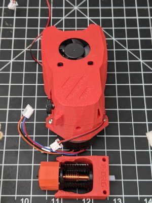

Print head​
  • I am not sure what lube is suitable for the MR85 bearings in the extruder so I’m just going to put in the same SuperLube that I used on the rails.
  • When it comes to glues, I guess you could say that I’m not really much of an adherent. I generally design things to not need glues, especially superglue. Naturally this means that the superglue that had been sitting around that was described as not being like the other superglues is all dried out, before I’d ever gotten around to opening it up and trying it out, which meant I needed to get a fresh tube real quick. Would Epoxy have worked? No idea.
  • I did have to sand a bit off of the metal gear shaft in order to get things to fit properly.
  • When I was screwing around in Step 5 trying to figure out what I was supposed to do about the M85 bearing, I opened the container with the drive gears, which required me to peel off the tape holding it shut. Naturally, in between then and now, it managed to pop open and spew it’s contents and so I had to do some very careful digging to find a few bits. The magnets for the door were true bros in this case because that’s where the M85 and grub screw were but the little plastic washer thing was not magnetic and required a bit of a search.
  • I realized that I only got one 3010 24v blower fan and I should have gotten a second one. So I ended up using a genuine gdstime fan for the hot-end cooling fan and used the stock blowers. My impression is that I’m going to want to upgrade to the DragonBurner relatively quickly and that one uses 4010 blowers.
  • Manual writing is hard. For example, there’s a part where the manual talks about why you need a M3x10 screw so that it’ll have extra thread on the back side and two screw holes are slotted so you can adjust the backlash. In order to do this right, you’ll probably need to understand a bit of the why, even if the rest of the why is what makes a mechanical engineering education.
  • I ordered my kit with a Phaetus Dragon ST hot-end because I really really like one-handed nozzle tightening. And when I started trying to assemble it, I realized that the Dragon ST that I was looking at had the kinda unfortunate E3D V6 style mount that I think even Sanjay felt bad about in retrospect and was about to flip out because the provided hotend mount was not designed for the V6 style mount… and then I realized that I could just unscrew the V6 mount adapter and everything was fine.
  • BOM and/or sourcing issue: The BOM calls for M2.5x12 screws to mount a Dragon and there are none provided. I used some M2.5x12 screws I already had, except that the screws were too long. So I switched to the M2.5x8 screws provided and those fit perfectly. The error is either that the Dragon’s mounting screw depth changed, the screws were wrong all along, or the depth of the screw holes changed. Unclear.
  • SrgntBallistic got a 104NT-4-R025H42G thermistor for his hot-end but mine came with a generic 3950. I’ve got an extra higher-temperature handy, thankfully, so I’ll use that instead.
  • There were some folks who found that their umbilical breakout boards were mis-wired with the molex connector in the wrong orientation. Mine seems to be fine. One thing to note is that the polarity of the fans is labeled… however the input fan connector has the opposite orientation to the output fan connector.
  • The manual doesn’t state but it’s generally understood that you want to use the 2mm inner diameter teflon tube for the hot-end’s teflon tube.

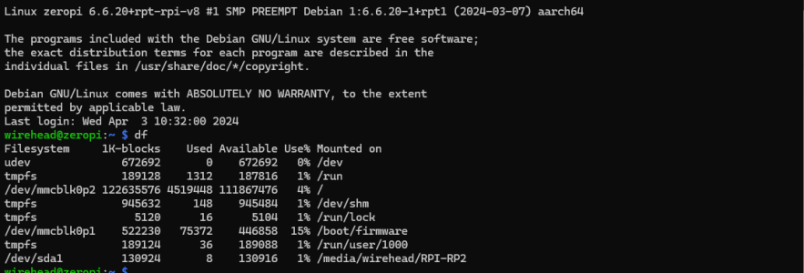

Getting started on the software side of the fence​
I have various issues with Raspberry Pi the company. The Raspberry Pi started out with this vague goal to re-create the experience of the BBC Micro in the UK, but over time they split it into the foundation and the company… and so there’s no hero companies with capitalism… but there's been a few incidents where they've been tone-deaf and not supporting their stated goals.
Also, they’ve had some catastrophically silly design flaws with the USB spec.
On the other hand, you want a Pi-shaped object to run klipper on and interface with the printer’s microcontroller side and the easiest option seems to be a genuine Pi because I trust the Pi OS’s longevity over the rest of the similarly-sized objects, so I’m not going to use that instead of the included Pi-shaped device because it makes my life easier if it’s identical to my other devices.
Likewise, it comes with a Sandisk branded MicroSD card. I don’t, in general, trust Sandisk cards right now after a very fancy and very genuine Sandisk card for my camera started acting up. Thus, I got a Samsung high endurance MicroSD card instead.
So, the first step is to download the Raspberry Pi Imager, tell it I’ve got a Pi 4, pick the 64 bit Raspberry Pi OS, and then when it asks me if I want to add some settings, I filled in my Wifi SSID, set my account name and password, and turned on SSH, at which point I can make Ansible do the rest of the work.
Summary​

Print head​
  • The instructions aren’t clear so I’m doing things the way I did the Mosquito I put on my Ender 3v2: Apply a liiiiitle tiny bit of Boron Nitride thermal paste to the thermistor and heating cartridge, shove them in, either let them dry overnight or warm them up at 90°C for ten minutes. I ended up deciding it was easier to wire up if I put the wires for the heater sticking out the opposite side as the thermistor and dumb-lucked the sides.
  • I do not see any instructions for what kind of screw to use for the umbillical PCB. I ended up using a M3x8 thread-forming screw. The folks on the Voron discord suggested that it was probably OK to just use a M3x6 screw and thread it in to the plastic.

  • Okay here’s where I slipstream the Voron V0.2 Electronics DIN Rail Bracket into my build. I had printed some alternate brackets but I didn’t end up using those. The DIN bracket for the SKR Pico is just slightly wrong, it’s got one hole out of place but it’s functional as-is probably.
  • I did have to switch the input voltage.
  • Again, I’m also slipstreaming the screw-on bracket instead of using VHB tape. It does fit my Zero. I printed it with PET-GF on my Ender 3v2 on a G10 bed with Elmers purple gluestick to make it not warp. I used the 4.6mm hole version, and I guess the big thing not explained is that the M3x6mm screws (I ended up using M3x8mm screws because the NoDrop nuts sometimes don’t quite grab with the 6mm length) are used to screw down the four mounting holes, plus one of them goes into the threaded insert via the tap on the side of the PSU. The M3x10mm screws go in through the side. And you really want to mount the power supply to the bracket before you mount the bracket to the printer.

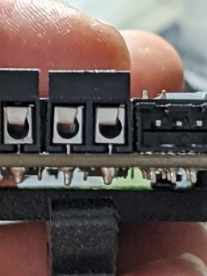

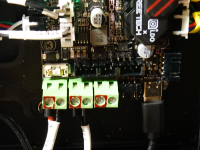

My BTT SKR Pico sucks​
I was just checking through all of the wiring because it’s actually at a point where I could power it up and start getting it printing PETG without the full chassis on. So I went through and checked all of the wires to see if everything seemed secure.
One of the screw terminals is bad. The one for the hotend, ironically, which is also the one that went bad on my Ender 3v2.
The screw terminals are the sort where there’s not a good-side/bad-side thing, you can just jam in a wire and it’ll end up on the right side. You can see how the other ones have a metal contact that bends down to hold the wire in place and make the circuit. And the one on the farthest right… no matter what I do with the screwdriver, the contact never moves.
The thing that concerns me about my particular Pico is that all of the screw terminals feel flimsy as I tighten them where the Creality board for my Ender 3v2 also has cost-optimized screw terminals but those aren’t nearly as bad. These are, and understand that I default to using screw terminals for my electronics designs, probably the worst screw terminals I’ve ever seen.
Also, as I said last time, the heat sink is held on by what feels like putty.
The LDO kit… which is what folks tell you to get because you’ll end up swapping out all of the parts from your non-LDO kit till you get to the LDO version… has a SKR Pico. So I’d like to think that if all of the SKR Pico boards were this bad, there’d be a lot more unhappy people.
Other than sending in a support ticket, do I?
  1. Buy another SKR Pico so I’m not sitting around staring at a broken printer for however long formbot and/or BTT take to figure things out because it can’t hurt to have a spare, hoping that I’ll get lucky on a $39 control board?
  2. Buy a different board that’s fairly compact because maybe BTT is making the SKR Pico too cheap. Say the SKRat control board?
  3. Get out the soldering iron and fix it myself because I can and because there isn’t a better replacement anyway? Maybe put a Phoenix-style connector this time?
Yes, these terminal blocks are garbage. One wasn't even threaded (the hotend one) ! Replaced them all with beefier ones I had in stock, made of plain metal instead of this skinny sheetmetal.
Requires a lot of heat, even with the desoldering station, because of the copper planes all around the pads. But definitely doable and worth the effort.
Poor quality, and poor design ; they didn't even take advantage of the dovetails because of the silly grid placement. The guy that routed the PCB most likely does not know how terminal blocks are supposed to be assembled.
Yeah, I'll probably do the same, assuming my soldering iron has enough heat output for the job. I'm assuming that they designed it in the biggest hurry during the time period where you could not get STM32's but could get RP2040's. I guess yay for them actually using a fill underneath the screw terminals?
Just thinking of something... Could be on purpose : 6-pin screw terminals cost more than 3x 2-pin, and it's unlikely pick and place machines could assemble the three components in one...
If you don't already know this YT channel, have a look to Mr SolderFix. Tons of tips and tricks.
Another way to remove the terminals is to destroy them, and remove the remains one by one. But it is risky.

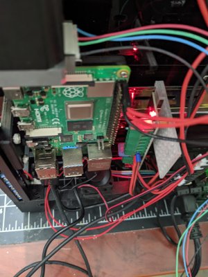

The Klipper Expander I already have…​
It hit on Wednesday that I have a complete and reasonable solution to my problem already.
I got myself a Klipper Expander because it seemed to be useful. And it’s able to handle 3A per MOSFET, which means that 24V × 3A = 72W, which is more than the hotend is capable of. Which I was in the middle of something else so I didn’t remember how ampere the capacity of the MOSFETs were so I realized that, worst case scenerio, I can breadboard a Klipper-Expander-like-thing solely using parts sitting around my geekroom.
While the RP2040 devices can just mount as a filesystem, STM32’s use DFU, so I had to re-arrange my dockerized provisioning scripts. I’m not sure what the final version thereof is, but this works well enough for now. Because each board has a unique klipper.config file to drive the build, I now have a build-image-skr-pico.sh script that loads the config for the SKR Pico and a /home/wirehead/klipper/build-image-expander.sh script that loads the config for the Expander, plus a /home/wirehead/klipper/dfu-utils.sh script that runs dfu-utils inside of the docker container.
Once I got that moved over, I was able to follow the Klipper Expander flashing guide to flash the firmware.
Bonus points: I have a DIN rail mount that I’ve already printed that can be pressed into service as a temporary bracket.

  • I went through testing the fans and stuff and discovered that the Triangle Labs 3D sensor I put in place of the stock 3950 sensor has some bad wires, so it’s back to the stock sensor. Also, I realized that the hot-end fan wasn’t turning because the wires are reversed, so it’s back to the stock fan as well, ugh.
  • Then I had to check out the sensorless homing guide to try and get that calibrated. It’s really confusing when you are calibrating because every time you run a G28 X0 or G28 Y0 command, it will lower the Z axis slightly… which is arguably probably a safe operation, but this also caused some confusion. But I have a printer that’s properly homing. I ended up, while going through the process of setting up homing, using the M18 code to turn off all of the stepper motors and manually re-setting the positions.

  • I washed the Formbot-provided flexplate with dish soap because I figure if I’m going to screw up a flexplate, it’s the right one to screw up. As I’m washing the smooth side, I feel something coming off. Okay, that’s not good. But, no, oops, it looks like that was a protective coating to keep the smooth side smooth.
  • I set the Z-endstop position with an eye towards seeing where exactly the Kirigami bed interfered with the screw for the thermal fuse and it’s definitely eating up a few mm of travel.
  • Overall.. the bed-leveling process seems better with Klipper and the BED_SCREWS_ADJUST macro. What I’m really interested is in how much the bed drifts over time, of course.

I decided, before getting too far into things, that I’d at least print a proper Voron calibration cube. So I’m using the SuperSlicer provided profile with everything left to the defaults. And since most of what I’ve got is PETG I figured I’d just print everything with that, for better or worse?
Seems actually pretty good considering that I need to actually properly calibrate things, LOL.

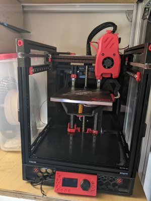

I’m (mostly) back to having a functioning 3D printer again. Looking at it move, it feels like it’s already printing faster than the Ender 3v2 and presumably once I’ve got it fully tuned, it’ll potentially be faster still.
The first pre-printed part to break was one of the DIN rail electronics mounts. It was probably a silly idea to print that in ABS-GF in the first place, of course. I’m not sure what the best way to destructively inspect the printing so as to make a better guess as to how fast I should have a full set of replacement parts ready.
The heatsink won’t stay on the SKR Pico, which is putting an end to printer commissioning. I’d intended to work my way through the Ellis’ Print Tuning Guide as well as rigging up the accelerometer to test all that out but that seems like a bad idea if I’m worried about frying the SKR Pico’s steppers. If I had been thinking more clearly I’d probably have ordered thermal glue earlier in the week, so we’re still in the land of a 3D printer that’s not fully functional.
Just ironic that the thing that has made this build the hardest is the controller board that’s hard to avoid because it’s also on the current rev of the LDO kit.
