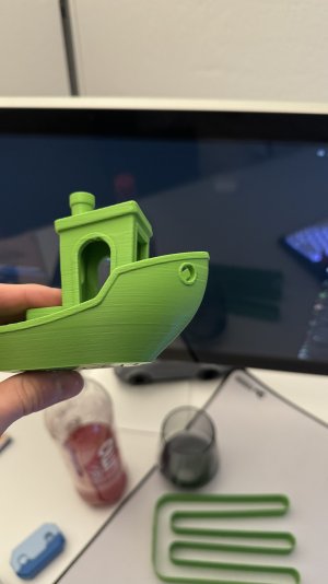

How can I fi this layer lines on my voron 2.4? I don´t know what to do.
That looks like a very good print. Maybe the lines are worse in person? Make sure you have the right amount of tension on the belts and that it is even.
Check the carriage is tight and not wobbling. Check any grub screws to make sure they are tight.
I mean it doen't look that bad unless its worse in person. I had bad layers once that I eventually tracked down to a partial clog in the hotend. Not enough to jam the extruder, just like a coating had formed above the hot zone that increased friction and made extrusion irregular.
These things can be caused by almost anything unfortunately sorry.
