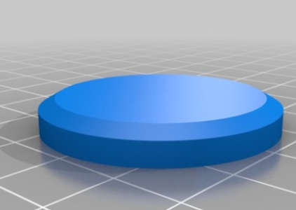

Sorry about the image quality, this is supposed to come out like a dome, but it's looking more like something else.
What's wrong with my print settings?
STL:
My Print:
I've attached the settings, if anyone cares to look. I could also take screenshots if that would be easier.

It kind of looks like what would happen if your print needed supports turned on, with the center sagging and showing the infill. Is this supposed to be a flat-bottomed piece, or is there a raised section under it?
it's just a "coin" with angled edges on the top. That's either the top perimeters sunken in or the ironing pushing filament outward.
I'm thinking it's the later.
