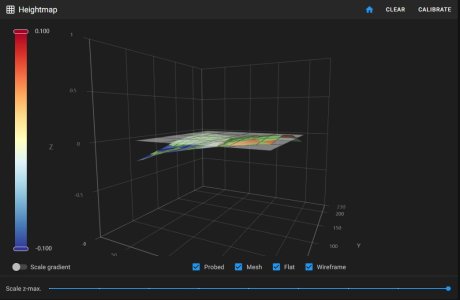

Hi,
I tried to check the printer bed and after the command - CALIBRATE,
I got this picture, but I don't know if it's good.
I am asking for your opinion and is there anything I should do
Thanks in advance George

For the left side, check your Y extrusion rails. If they are not as close to perfectly level with the rest of the frame you will see that angle. For the bow on the right I don't know.
You just helped me figure out that my build plate isn't twisted. I gained 0.5mm of "flatness" by measuring all 4 ends of the Y extrusions. The front left was 1mm low, causing the bed to appear twisted.
