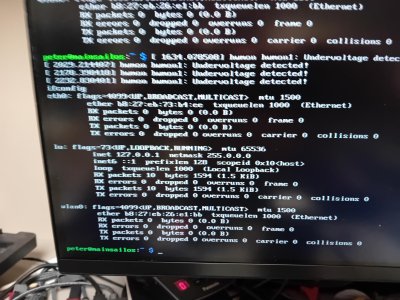

I used ifconfig to find the ip address of the Pi and under lo it is 127.0.1.1 However there is no IP address given for wlan0. I can ping 127.0.1.1 but the browser says can't reach this page

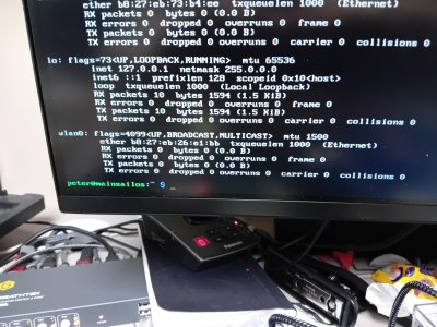

I tried to used ifconfig to assign an IP address to wlan0 which was, apparently accepted but ifconfig wlan0 immediately afterwards gives no IP address. I have a picture of the results of the ifconfig to see if it makes any sense to you?ifconfig.jpg
That is not the right IP. Can you access your router or DHCP server? It's more like a 192.168.X.X IP
Also that is not the entire screen shot. Maybe there is missing info?
It's not connected to your network. I think you will need to edit the config file on the PI. Put the PI SD card in a card reader, and look for a file called readme or Network_config_readme or something along those lines. And you will need to enter your network information and save it.
