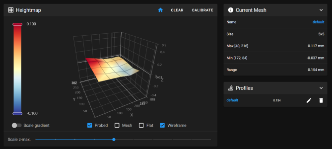

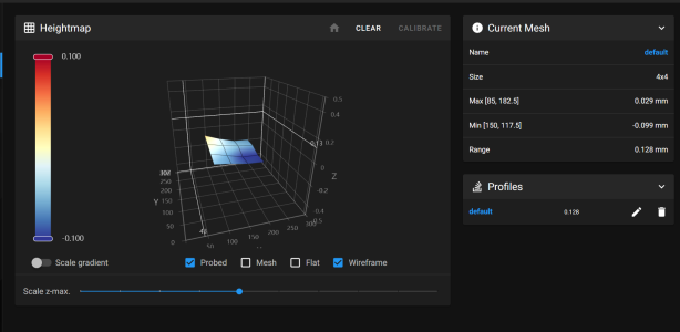

Hello all. I have a LDO Trident 300 which I have built but have never been happy with how it prints the first layer. If I print a small 30mm x 30mm first layer box at the centre of the bed, the spacing of the lines is uneven. Usually one half of the square has gaps while the second is close to perfect. My first thought was uneven extrusion so I disassembled the extruder and found the gears had been rubbing on the printed parts. I decided to upgrade to cw2 so purchased a new pancake motor and printed the new parts. I now have that up and running but am having the same issues. I then decided the inductive probe may be the issue so printed and installed KlickyNG. No luck, same issue. I have tried variable bed mesh also without any luck.
I guess I am looking for another set of eyes so to speak. I'm at a loss as to where to go from here? New extruder maybe? Anyway thoughts anybody? Cheers!

I did a bad job of explaining my thoughts above - what I meant was the hotend and/or extruder are extruding inconsistently. I am not sure if that is how you read it or not. However, if my aluminum extrusion or rails are warped what would be the best way to correct those? I have seen titanium backers and carbon extrusions online.... would you know if they help much? Currently I have the LDO kit stainless steel backers in all of my rail extrusions. Thanks!
Frankly, I doubt that the extrusions or rails are warped unless the quality was horrendous to begin with. I would suspect that the build plate may be more of an issue than anything else. So many of these vendors talk about cast plates but in reality, I think they are just plate aluminum that is machined "flat." By looking at your bed mesh, you possibly try a very small shim on the right front corner to see what happens.

Do a full bed mesh to see what the whole bed looks like. From that small sample, You might have a crooked Y extrusion. Check the position of the ends of your Y extrusions.

Hi claudermilk. Yes, the full bed mesh reveals more, which I don't think can be fixed by shimming. Sorry, I forgot to save the image so can't post that. I think my best option is to rebuild the x and y gantry. I'd like to add the pins mod and maybe the rama idlers while I'm at it. What do you mean by checking the ends of the Y extrusions? - do you mean for level?
I don't think you need to rebuild all that. It looks like the left rear Y extrusion is a bit low (someone correct me if I'm wrong). Loosen that and get it to exactly the same distance from the top or bottom of the main frame and re tighten. I ran into the same issue with my initial build. I had to adjust my rear right by 0.1mm and after that my mesh came out much more even.

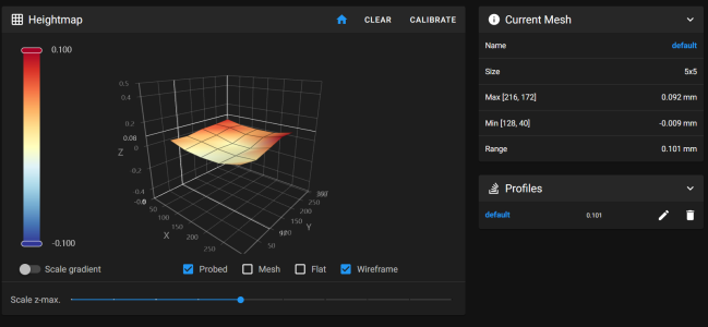

When I adjust my gantry corners, my goal is to set them so that they aren't the highest or lowest spots in my mesh. In your case, like claudermilk says, the rear left is sitting a bit too low, so I would loosen that screw and raise it .1-.2mm or so, retighten, re-Z-tilt (important!), and take a new mesh. Repeat until the corners are satisfactory. It's helpful to put a piece of tape to mark the starting point as a reference so you know how much you are adjusting.

Just wanted to say thanks to all for the suggestions to the problem I have been experiencing with my new Trident. I managed to achieve better results to the bed mesh on my printer. Initial test prints are much better to what I was getting previously. My only worry is the fact that I had to adjust the back left so much. Does that suggest there is something else out in the gantry somewhere?
Also - should I continue to tweak based on my results? :unsure:

Are you getting good print results? If you are, then I wouldn't bother--that's not a terrible overall range.
Unfortunately I spoke too soon. While overall the results look much better than before, the bottom layer / first layer is still inconsistent depending on where parts are placed. There's also an uneven or inconsistent extrusion issue at play I think, which isn't helping.
Silly question coming - but I was under the impression the bed mesh calibration routine would help in compensating for high and low area's of the bed?

Hm… A 0.101mm range on a 250mm bed is not terrible and should definitely be corrected by the mesh. Can you share a photo of first layer inconsistencies? Also, paste your [PRINT_START] macro or share your config file so we can make sure the mesh is active and not somehow being removed prior to printing.

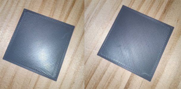

EDIT - print_start macro below & photos of 30x30 patches. Extrusion widths seem inconsistent through the same patch?

Hm... The first layer kinda looks acceptable to me. The unevenness might be caused by a slightly tilted nozzle? is your hotend perpendicular? Do you see a similar thing happening with top surfaces as well?
