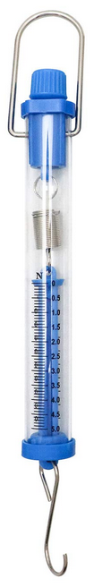

Since there is no reference "sweetspot" frequency provided for the v0.1 (...or to be found by me...?) I adjusted the tension with a spring scale
One side of the scale is fixed to an aluminum extrusion, where the door would be, the other one hooked to the belt(s) for measuring (more equalizing)

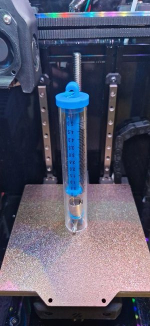

You asked for it, so here's some ghetto engineering;
inb4: I am well aware that this is less precise than measuring the frequency and I am in no way under the illusion that this is remotely scientific.
I still feel it is a better solution for my printer then frequency measuring since I had way better results quality-wise / determining the relative (!) belt tension (between belts A and B)

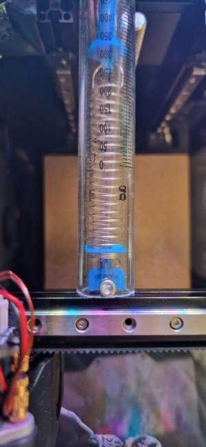

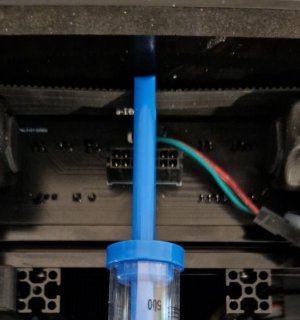

I cut the scale to fit to in betweet the x axis extrusion as well as the spring mount inside.
The pretension of the spring / force is at 0N to start with (incidentally, again).
with y=0 I put the hook onto the desired belt
...and pull the 'meter' to sit flush on the x axis extrusion. There's the required force for belt A, repeat for B. Tension adjusted if neccessary.
@NoGuru
Charme und Silikon ersetzen Präzision.
I am impressed. While not a perfect solution, neither is the plucking. I think this could be a better solution since it will be more consistent. bravo-xd.gif

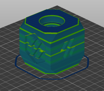

While getting ready to do some testing based on the ideas so far, I noticed this in SuperSlicer using the Speed view of the sliced model:
Does that look to anyone else like it lines up with the inconsistencies I circled in the photo of the actual prints? My speeds are mostly directly set with just a few being set as a percentage and Auto Speed is off. I am not great at adjusting speeds. I usually just throw stuff at the wall to see what sticks.
try reducing accellerations and not speeds, I feel like this had something to do with cheap AB belts that stretch more during high accelerations.
I've been printing the parts for my 2.4 and I have not been seeing any inconsistency problems. When I view the parts in SuperSlicer using the Speed view, they are a much more solid color, no lines, compared to the attached image above.
Are the belts that come with the LDO kits cheap belts?
