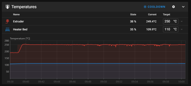

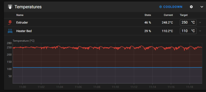

im having some issues with the hotend temperature stability like in the attached photo.
I have tried changing the thermistor but it made no differance.
it has been working about 500hrs before this.
When temp "jumps" suddenly, in other words faster than physics would allow, focus on wiring and/or crimps. Having said that, your jumps aren't that large compared with others I've seen.
Hope that helps you narrow it down!
I found the issue, one of the cables for the thermistor on the x carriage had started to break. Thanks for the assistance!
