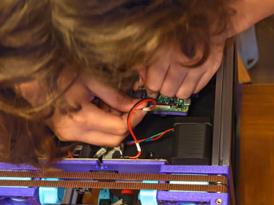

Toolhead board.
I'm an idiot. Looking at another installation image just now, I see where the motor cable is supposed to go. I'm pulling the toolhead board off later and re-routing the cable correctly.

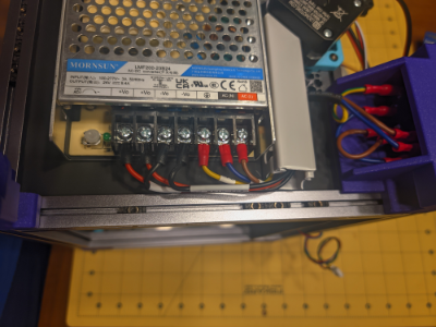

Finally, power supply and inlet switch.

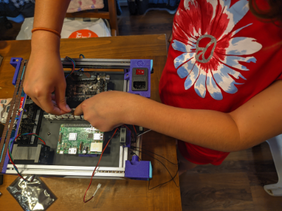

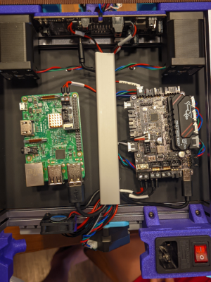

I managed to forget to print the controller/Pi mount parts, so we couldn't get those done--and she was about done at this point anyway. Next up: mounting the controller and Pi and starting to attach wires.

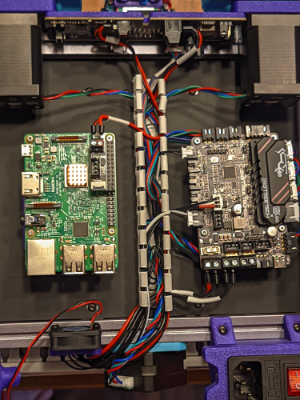

Big progress! Wiring is done! Next is making it move--that is tomorrow.

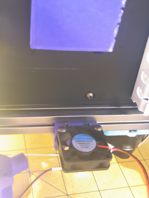

Mounting the electronics cooling fan.

Prepping the controllers, and mounted.

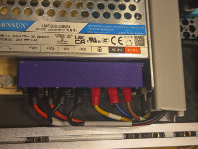

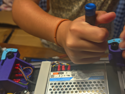

Connecting the power supply, and the nice safety cover.

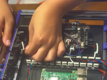

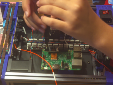

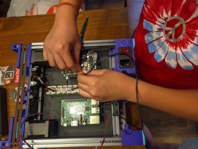

First exposure to these tiny darn connectors. Yes, I'm totally cheating using her small hands for this stuff.

Wiring montage!

A full cable channel, and covered!

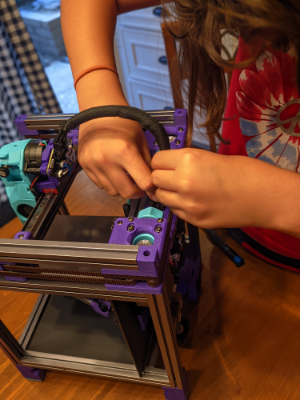

Connecting the umbilical. This took some care--enough pressure is needed that I was worried about breaking things.

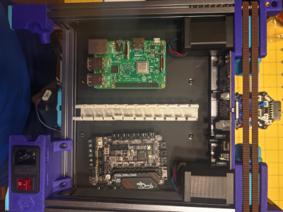

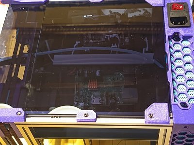

How it sits now. Next up is inserting the flashed SD and starting software configs and printer checks. Getting close!

Had some difficulty with the Picobilical frame PCB. I wasn't seeing any 5V out on it. Probed everything and all but that looked ok to me. I eventually built a quick power jumper to power the Pi per the main build documentation from the SKR Pico. That got me running enough to get the Pi going with Klipper, Moonraker, and Fluidd installed. I was able to get the SKR Pico flashed no problem, and got the Picobilical flashed. But I only was able to get the serial ID on that sucker once. After lots of poking, unplugging another USB cable from the Picobilical board (trying to re-flash from a PC) I noticed the 24V leads moved. It turns out both the 24V and 5V leads hadn't gotten truly secured even after triple checking. For some reason those terminal blocks are really touchy. I made darn sure both sets are really, truly secure. Now I have solid power going to the board, and coming out. Now ready to get the config file set up and get this little guy moving.

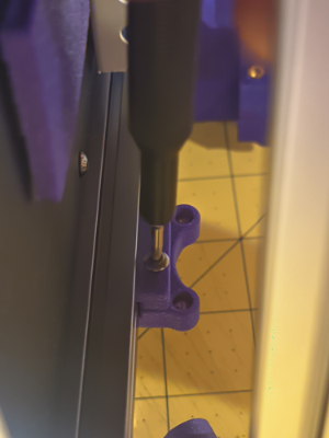

Good choice on printing the v0.2-rev1 camlocks with the hex openings, rather than the ones with the Voron logo. Hopefully you printed the rev1 feet and skirts, too, or else you're in for a surprise when you go to install the bottom panel. 😆

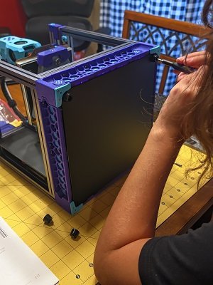

Getting really close to the finish line. Panels went on this time. Tophat is next, and that will be it.
The peel!
Bottom panel going on. This will make @Steve happy. 😁
Back panel with all the pixies safely contained.
And where we sit now.

The skirts on mine went on nicely, too. But when I went to install the bottom panel, it wouldn't fit properly (bowed significantly in the middle because the feet and skirts were too short). This was a design flaw with v0.2-s1 that was fixed with Rev 1, and I was able to use my v0.2 to print the Rev 1 parts and retrofit after the initial build.
