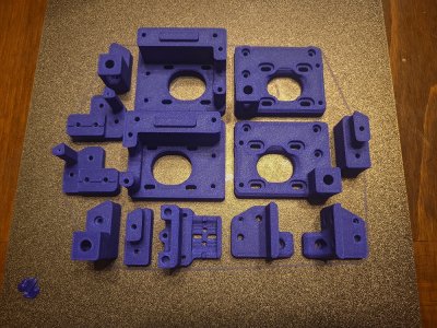

I got my filament ordered and sliced up the plates of parts. Took the LDO project files and revised them for r1. I also ditched the skirt plate and redid my own using the multibody variant. I'm going to try and get all fancy and do the open honeycomb infill trick that's all the rage.
Slow start on this due to an ordering hiccup. I wanted a gray frame, but I have a blue frame. I love the blue--that's my Trident--but I want something different for this one.
In the meantime, I'm printing up parts.

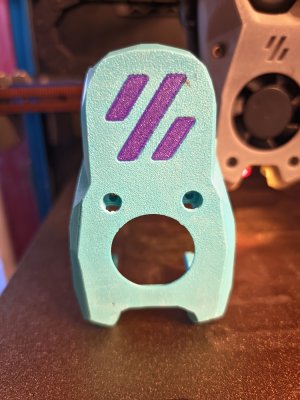

Fusion Geomagnetic Mauve prints up really nice and looks great. The Polymaker Teal has been more difficult on my Trident for some reason.

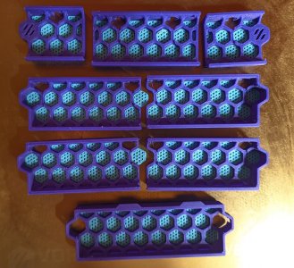

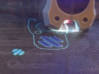

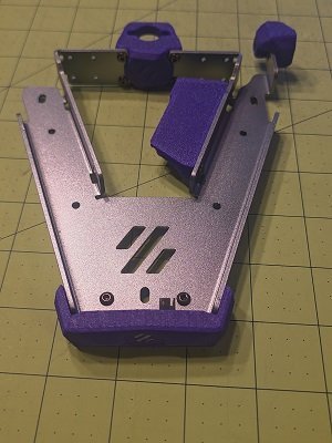

I'm attempting the multibody, multi-color parts for the MiniSB cowl and the skirts. First attempt looks good.
Got the skirts printed up, not without a bit of struggle. It took a few tries to get the right plate and squish to allow the parts to come off mostly intact. A few mesh bits still needed acetone welding back into place.

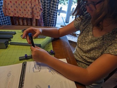

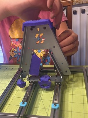

Actual building has finally happened!

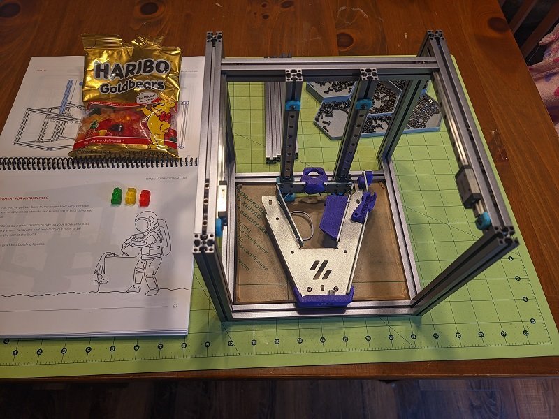

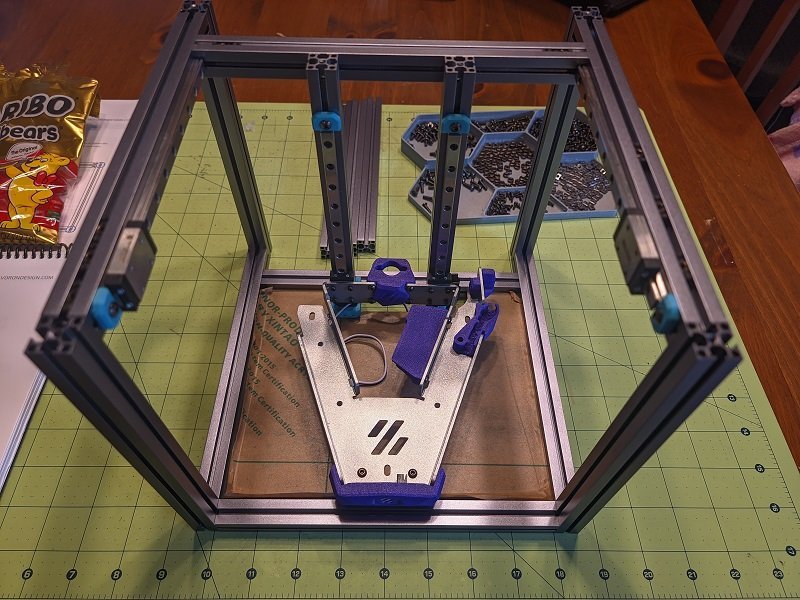

First of all, the required bag of Haribo was acquired. It's even the correct package size. :LOL:

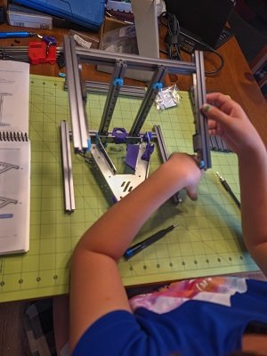

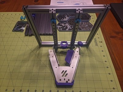

New Voron builder-in-training. She did almost all the actual wrenching. I mostly supervised, directed, and advised.
Current progress.
At this point she was about done and I was getting there--been a busy weekend. As it turns out this was about as far as we could get anyway. Next up is the Kirigami bed, and i had a reprint needed. I also found that there were no feetsies. Where's my feetsies? I forgot to print them. And the clear logo insert for the Kirigami, so some printing needed to be done first. I also prepped all the heatests (I think); I'd rather I burn my fingers than my building assistant (and mom will appreciate dad not letting her play with dangerous, hot tools).
Those no-drop nut holders are great--they work like a charm. For my batch, I need to file the bottom a bit so they don't have too tight a fit, but there will be no cascade of nuts shooting out onto the floor from a poorly-considered frame rotation.

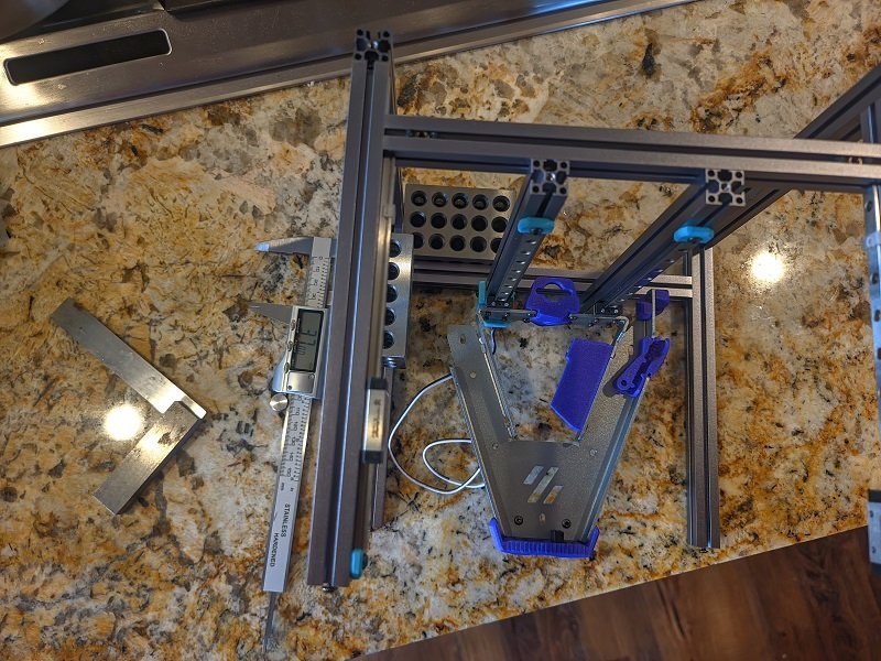

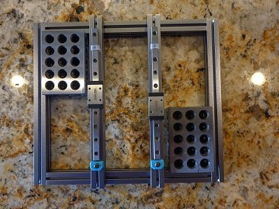

More progress. Slow and steady, just the Kirigami set up and mounted; BUT, no tramming needed at all! The rails turned out to be perfectly positioned and the bed just drops smoothly. The extra effort making sure the parts were as perfectly flat and square with the 1-2-3- blocks paid off.

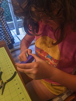

Lots of progress pics.
Prepping parts. Thanks Steve for showing us the Knipex pliers--they were perfect for pressing the M3 nuts into the front piece for the Kirigami.
PXL_20230731_232410625_MP.jpg.c53c606e1b657668c7e2beabe1f2bce6.jpg PXL_20230731_232225004.jpg.c11af3c3cb30926f4e759e3787b30244.jpg PXL_20230731_232929817.jpg.a2678ce645f5f0124c18496fe757e53c.jpg PXL_20230731_233257497.MP.jpg

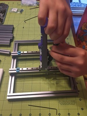

Some more progress yesterday.
"How many preloaded nuts?"
This part of the frame assembly was a bit fiddly and juggling lots of bits.
Getting it lined up and square.
Sadly, in the final preload check I found I had missed a few. 😒🤦‍♂️ Had to do some unbuilding to get all the nuts loaded and lost the perfect first time tramming.
Time for gummies. That got her interest back--checking the nuts and making sure everything was square got tedious and boring.
Finished for the day. It's so little and cute!
