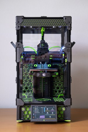

Mod name | Description | Based on | Link to the mod |
Electronics compartment side covers | A cover to hide the sides of the electronics compartments. I combined the idea from Maple Leaf Makers for a side cover for the electronics compartment with the mid panel hex pattern from Zen3D to have a seamless look. |
Hex pattern electronics compartment side covers plus hex pattern mid panel for Voron Zero by Akio | Download free STL model | Printables.comThis mod complements the MidPanel with hex pattern by Zen3D with matching hex pattern side panels. | Download free 3D printable STL models
www.printables.com
Deck panel cover | A cover for the deck panel. It is placed on top of the normal deck panel and is purely aesthetic. |
Voron 0.2 DeckPanel Cover Mod by Akio | Download free STL model | Printables.comA deck panel cover for the V0.2 | Download free 3D printable STL models
www.printables.com
Tophat led mounts | Led mount for led strips that lights the V0.2 from the top of the Tophat. |
| not yet published |
Hex pattern top hat extender panels | Custom hex pattern panels for an extended tophat. | - |
Hex pattern top hat extender panels vor Voron 0.2 by Akio | Download free STL model | Printables.comSimple tophat extender panels for the Voron 0.2 | Download free 3D printable STL models
www.printables.com
Electronics bay cover + umbilical guide | Custom electronics bay cover to route the bowden tube, toolhead umbilical and two led cables for the left and right led strips. |
PG7 cable gland compatible motor panel for Voron 0 by Akio | Download free STL model | Printables.comA custom printable motor panel to be used with a PG7 cable gland | Download free 3D printable STL models
www.printables.com
Braided cable guides for 1515 extrusions | Guides for the braided led and fan cables to route the cables neatly. They are desiged based on the mount of the matchstick diffusor by Maple Leaf Makers |
Cable guides for 1515 extrusions (90°) by Akio | Download free STL model | Printables.comCable guides for my braided cables that help the cable make a 90° turn for my Voron0 | Download free 3D printable STL models
www.printables.com
Piggyback air filter mod | A Nevermore/MF Nano inspired air filter that is located in the back of the printer (electronics compartment) and draws air in through one side of the mid panel and pushes it back on the other side. The filter cartridge can be changed easily from the back of the printer. |
| not yet published |
Tall skirts mod | Taller skirts that are based on the V2.4 / Triden skirts. They allow the 4.3" touchscreen to be mounted in a compfortable position and allow for a vertical mount of the raspberry pi in the bottom electronics compartment. |
Tall skirts mod for Voron 0.2 by Akio | Download free STL model | Printables.comTaller skirts mod for Voron 0.2 | Download free 3D printable STL models
www.printables.com
Bottom electronics compartment mod | Together with the tall skirts mod this mod adds a grid of m3 hex nuts to the bottom of the printer. On this grid the electronic components can be mounted flexibly. The mod includes mounts for the RaspberryPi, BTT U2C, BTT SKR Pico, Wagos and standoffs for custom cable management. | - | not yet publsihed |
Bottom panel mod for better air circulation | A more open bottom panel that allows for a better airflow. |
| Included in the tall skirts mod:Tall skirts mod for Voron 0.2 by Akio | Download free STL model | Printables.comTaller skirts mod for Voron 0.2 | Download free 3D printable STL models
www.printables.com
Mini Stealth Burner bowden mod with BTT EBB36 mount | Modified Mini Stealth Burner bowden toolhead to attach a BTT EBB36 to it to use canbus with a bowden setup. |
| not yet published |
Upper rear panel with Voron logo | Printable upper rear panel with Voron logo. | - |
Upper rear panel with Voron logo for Voron 0 by Akio | Download free STL model | Printables.comPrintable upper rear panel with Voron logo. | Download free 3D printable STL models
www.printables.com
Top hat corner cable guides | A cover that can be mounted into the corners of the top hat that hide the cables for the leds in the top hat. | - | not yet published |
