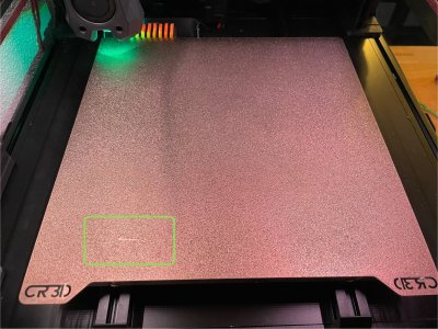

I recently had a heavy nozzle crash which damaged the PEI Plate and the nozzle of my voron 2.4 printer.
Is there anything else to check for potential damage? The nozzle was pushed hard against the bed (Z motors were skipping already) and was moved to the sides as well before I turned it off, causing a deep scar on my pei plate.

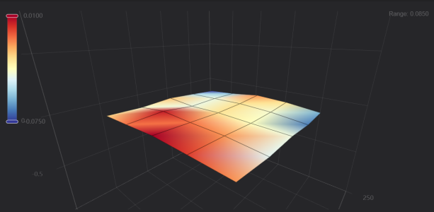

More likely than not you may have bent your X gantry extrusion. Run a bed mesh and see if you’ve got a reverse taco. Tell me how I know….
Here is a screenshot of my bed mesh (and a bonus picture of my scratched bed).
While it's not perfectly even (is it as bad as it looks?), I wouldn't call it a taco.
