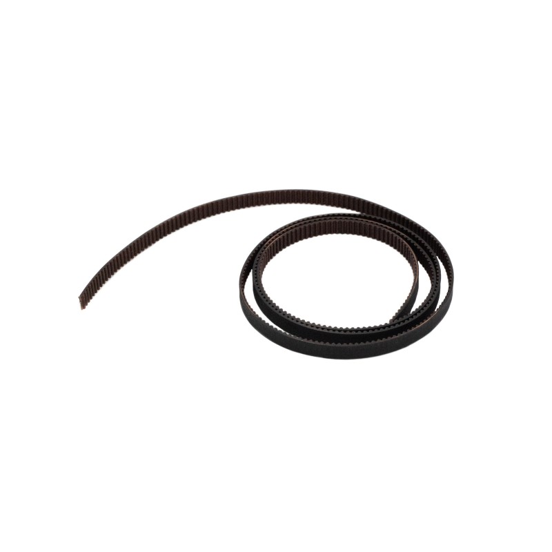

- [x] 3x Nema17 39mm stepper motors
- [x] 3x ~500mm GT2 Belt

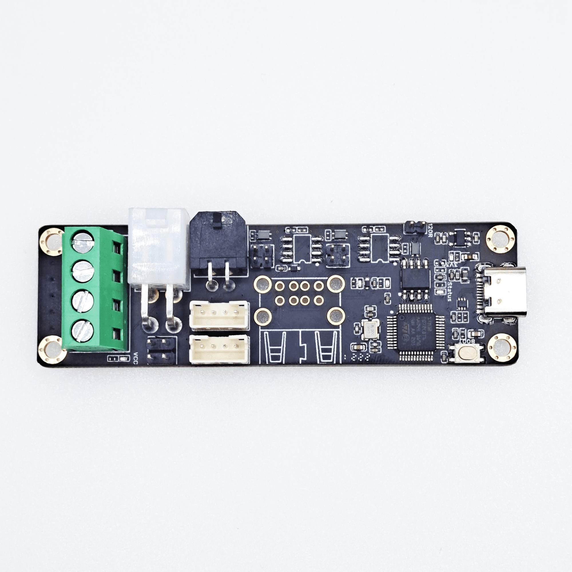

In total 6 drivers will be needed, A, B, Z1, Z2, Z3 and E. Since I will be using a CAN toolhead board the MCU will only need 5 drivers. After some searching I landed on a used SKR 1.4 Turbo. It included 4xTMC2209 drivers and I have one extra lying around from a previous CAN conversion.

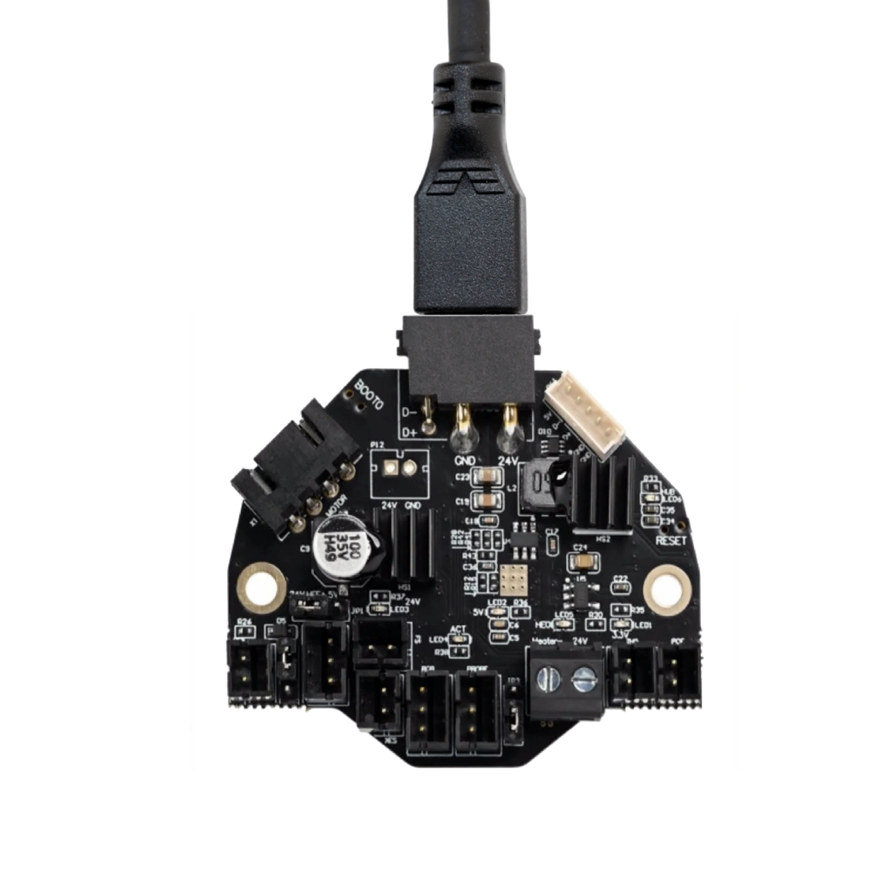

I will be using an ebb36 with an u2c from Bigtreetech that will be salvaged from my Trident when the fly sb2040 arrives.

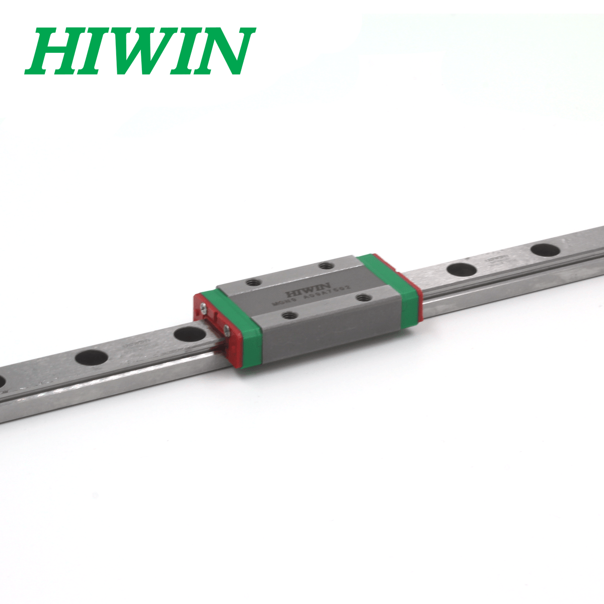

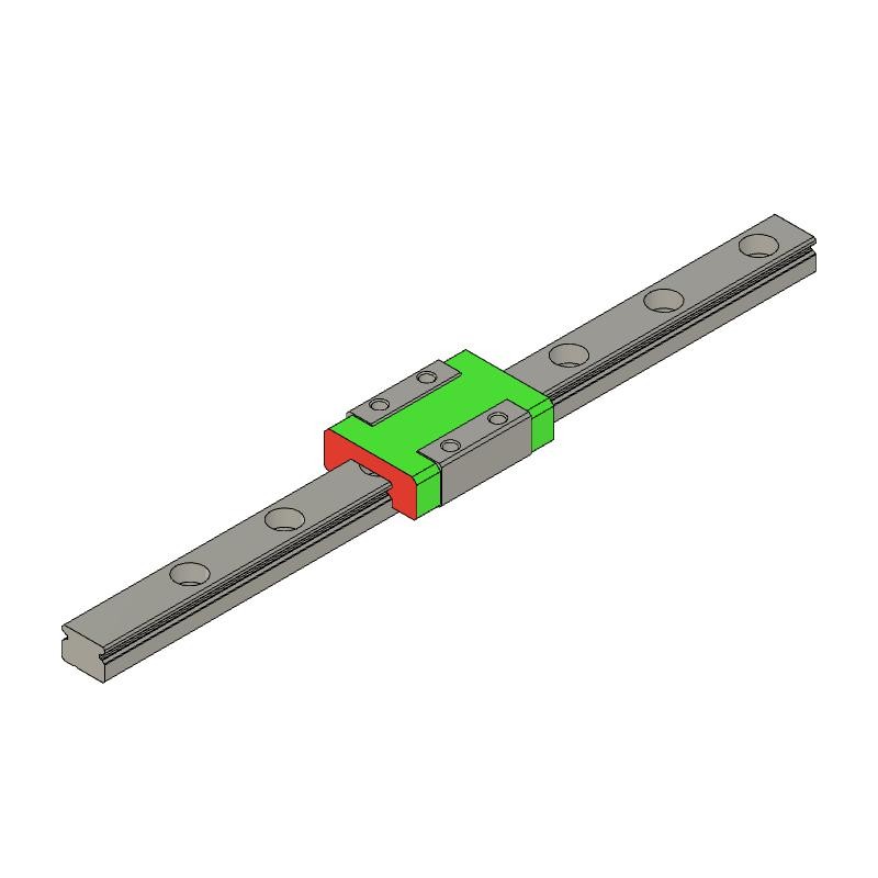

The Tri-Zero needs two extra MGN7H 150mm rails for the two extra Z. As recommended by the designer of the Tri-Zero the X rails will be upgraded to a MGN9C rail and the old one repurposed for Z. One additional MGN7H was bought.
