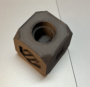

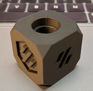

Hi!

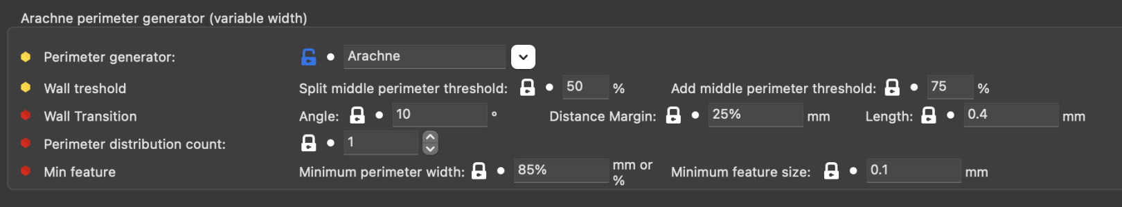

I am having issues while tuning my pressure advance, I have tested all flows between 0.92-1.08 and I am pretty sure this is not the issue. I have tried several different nozzles, and I am currently running a CHT 0.4. I am using Ellis's tuning guide and his pattern method. However, I cannot raise the pa above 0.03 without too many gaps. From what I've read a Voron 2.4 with Stealthburner CW2 with Rapido should run about 0.04 to 0.05 in PA. Any ideas what the issue might be? I am using Esun ABS+ with Ellis Superslicer 24 mm^3 profiles, with Arachne with the settings below. I've tried temps between 255-270, and it makes no difference. Esteps is calibrated. I've run input shaper and tuned it.
