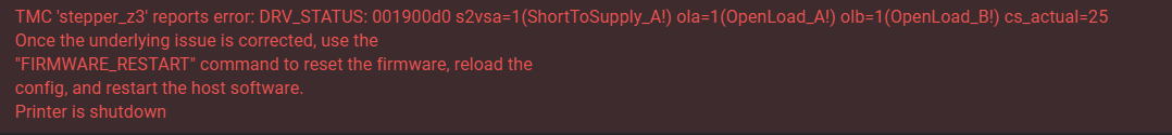

problem ID DRV_STATUS:001900d0
liend
voron2.4
Other
I can't solve this problem
please help:)
Typically means your stepper plugged into the stepper_z3 driver is currently either wired incorrectly or the connector hasn’t been fully seated.
