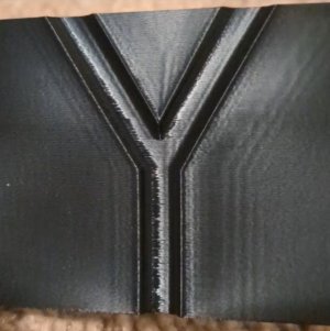

I have a 350mm V2 that has some bizarre behaviors. This particular one confuses me more than any other... How is it possible that I get resonance rippling before *and* after corners? Also, if anyone knows the cause of the ugly texture that appears on inside corners, I'd love to get rid of that (visible on the left side of the Y). This print was in vase mode, so no seams.
Yes, the machine is fully tuned. I can do every part of Ellis' guide by memory at this point. I've spent maybe 30+ hours trying to tune this issue out of this machine to no avail. I've also replaced every part that I feel could contribute to this issue, but it remains. My machine has some serious gremlins that are extremely good at hiding.

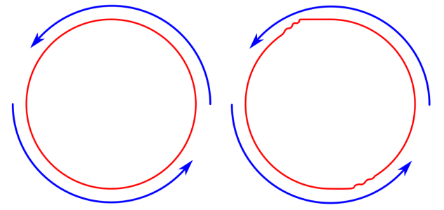

It is a Formbot kit that has basically had everything on the gantry replaced with self sourced parts. When I print slower, the resonance goes away, but the overshooting does not. Basically, on cylinders, I get something like the right image instead of the left (arrows indicate printing direction). When printing slow, I get a lot of vibration that makes my print surface look like garbage, but I don't get the wiggling after the overshooting.

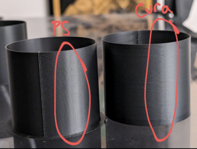

Cura sliced gcode still has the bump (see below). I feel that is evidence enough to say this is definitely mechanical in nature. 1000009393.png
It's difficult to see in the pic. I think Orca is worth a shot, even though its a fork of PS the coding is very different.
If you still think its mechanical, start to look outside of the Gantry. I can't think of what else it could be but maybe someone has more insight.
