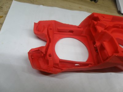

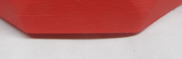

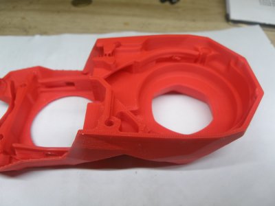

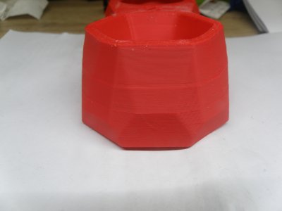

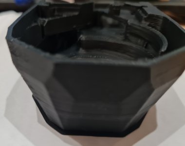

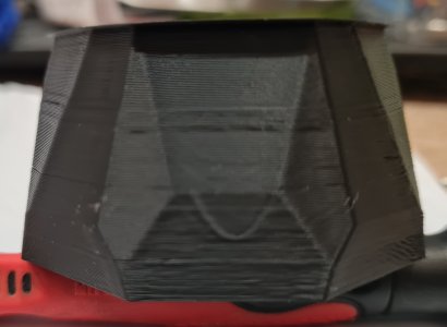

Nordlicht77

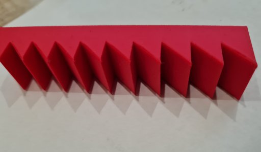

I made the adjustment plan from Ellis Print Tuning Guide
I've already tried several settings
For example, printed with a fan in 10 steps
I can't get this bulging in Grifff
This has now been updated with Superslicer 2.5.59.3
I'm trying again with Simplify3D
Does anyone know a tip how I can do this better
Uploaded to Dropbox from Superslicer in mf3 format
greet Martin

Hello
I get the stripes on the top with every slicer
I just saw these
It can also be seen above
Maybe it's normal

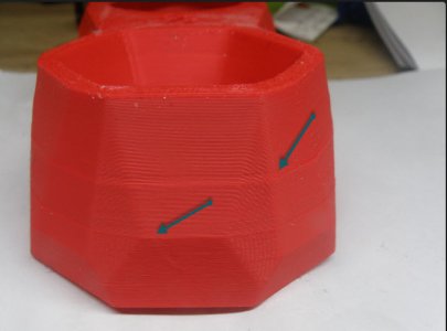

I think you need to tell us what is the exact issue. Also what printer are we looking at? And is this ABS or other filament?
I added some arrows of what I think you are asking about.

Hello
Yes, that's what I mean
I've already tried too many things with the fan in 10 steps or the temperature of the bed and extruder in steps
I have it with ABS + from Amazon and with Esun
Mmh printer is actually in the signature
Voron R2 350
Have you dried the filament?
Have you tried a different color or brand?
Is this only on that model or all models?

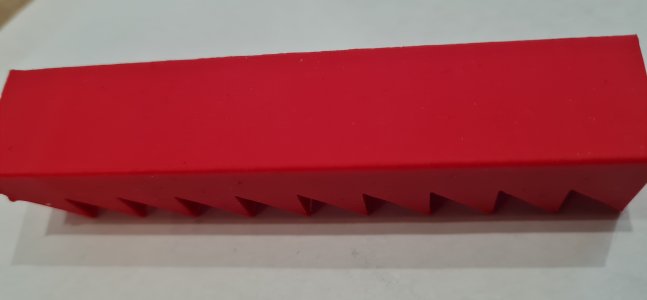

Hello
I dried all four rolls of filament
I tried Esun Red and Black and Red and Black from Amazon
I have now cleaned and greased the ruler rails and the scales again
Then I installed the drivers from TMC5160 back on TMC2209
I had printed two more towers
One with a fan interval of 10 steps and one with 40 fans and temperature steps from 225 to 270
it cannot be seen there
I still have a tower, see photo

So are you saying when you changed from 2209's to 5160's you saw the same issue?
What about new motors?
yes, I did the switch and back and the same results
There could be a defect in the stepper motors
which engines could it be A/B or Z
Which ones I am not sure. It's a little cheaper and easier to replace A/B first.

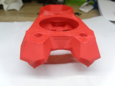

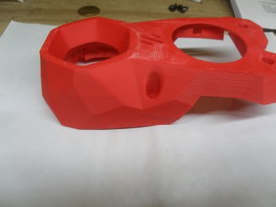

The bulging on the top of the extruder might be because it's curling up from the build plate. All the layers on top will be squished together resulting in those artefacts.
Hello
I have now changed the extruder to a V6 hotend and checked the steps
Same results
Same thing with Orca Slicer too
I have now reset SuperSlicer to the standard Voron profile and am now printing a Brim
I also let a new roll of ABS dry in the oven
Unfortunately the brim doesn't seem to be improving at the moment and it doesn't come up
Filament changed now and left and right and rear panels removed and cover over to prevent the belts or anything else from getting stuck

I know you said you went though Ellis tuning guide but I see some issues besides the bands. Might want to tune again.
Hello
What do you mean exactly
At first I left everything on the Voron standard profile except the filament diameter and the temperature start code and end code
The fan was also off
Hello
In the first post you said "I made the adjustment plan from Ellis Print Tuning Guide"
I would try to retune everything you can.
