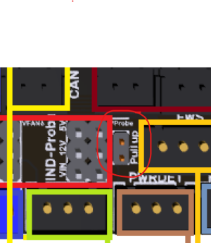

I have similar issue. I've installed ebb2209 + chaoticlab tap v2. I've wired tap to ebb2209 on x-endstop connector and always lights on blue. I've moved toolhead manually and it never changes color to red.
I don't use Probe connector because it's died.
I've had that happen to 3 optical sensors, and I am starting to think I have a wiring issue that's slowly killing them. One was like yours out of the box, another 3 months in and on a CNC TAP. The one test I've come up with to tell if its a bad sensor, or bad wiring is to pull the signal wire from the connector, if the sensor is good it should trigger
for me it was the pull up resistor next to the Probe jumpers, once i added that jumper, it worked as intended.
