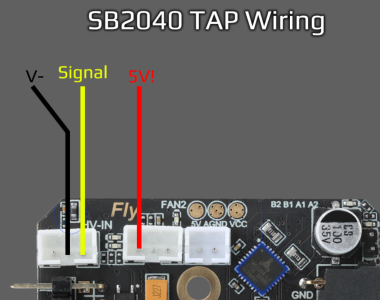

in the process if building my 2.4 and going with tap. In the tap github it says if using the 2-piece hartk pcb there is a slight modification needed. I tried to check discord as it said but am coming up blank. Anyone have the info on what is needed to be modified? Thanks
For Tap, this is recommended. Also I added a 3010 24v fan to gpio15.
I hooked it up as it is, Tap to the probe connector. Works great.

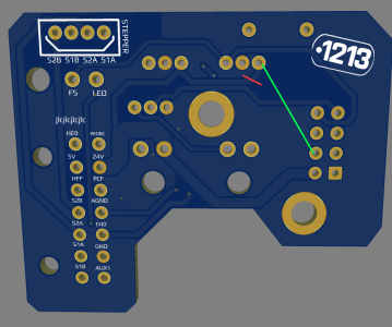

it all depends on if you are using a 24v tap pcb (which i would hold off on at the moment in light of the current issues with them ) or a 5v tap pcb
with a 5v tap PCB there is a modification you can make to the PCB to change the FS header to be a 5v probe header
to make the FS header a 5v option, you will need to cut the trace where the red line is and solder a small jumper wire between the 2 pins that the green line connects
