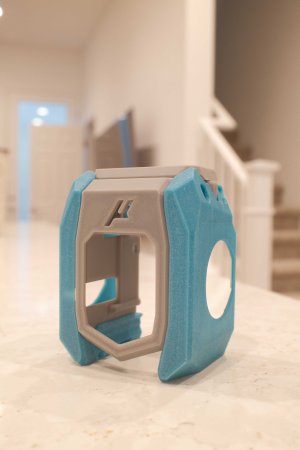

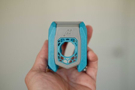

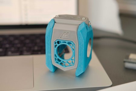

It's been awhile! Planning on some upgrades to my Micron. Tentatively, Anthead paired with ReVolcano on a new MGN9H rail to accommodate Boop. Though, ZeroClick has been set-and-forget for so long that it feels wrong to rip it out. Started printing it's own upgrades and the print quality is still there. Good work, little buddy!
Edit: Full plastic mock up with knocked out grill. Speed holes.
