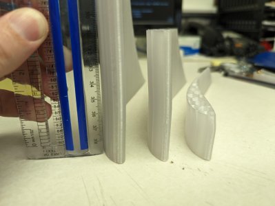

I have been trying to print a wing profile and am getting strange bend/curve in the print along the z axis. I have tried different amounts of cooling, different bed location, different temps. Also cleaned up some potential drafts coming in as a precaution but nothing seems to fix the problem it just varies slightly on how much it curves.
The curve or bowing does not go throught the whole part as well it seems to effect the front of the wing profile the most the print is staying stuck to the bed so it isn't compressing as if it came off.
Any Ideas?

It's warping. Try with no fan, and printing slow or like 20% fan and slow.
Carbon Fiber ABS will mitigate this to an extent.
I have printed at fan speeds of 0,10, and 25% all with similar results.
Printing speed is 150mm/s and walls at 50mm/s (everything is 2 walls thick so pretty much 50mm/s the whole time.

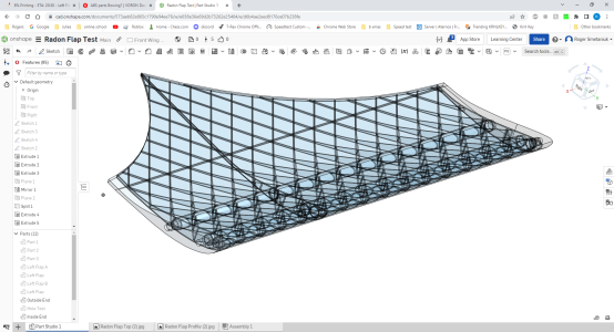

I have tried different location/rotation for placement but can't really do a different oreintation due to the shape of the wing.
I could add a perimeter but so far my thought is that on the lower side of the wing the larger radius/more material versus the top side smaller radius less material is my issue and the reason for the warping.

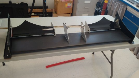

These are what being made ( Bat flaps as we call them)

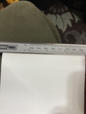

I printed it in Polymaker ASA white and it seems okay to me. I tried to get the pic and my Calipers lined up as straight as possible.
Looks good do you have a pic of the straight edge against the bottom surface of the wing? (See my first post pic) Thats where the warping was happening my leading edge was fine even on my warped prints.
Also print settings?
ps. funny looking voron you have there!;)
