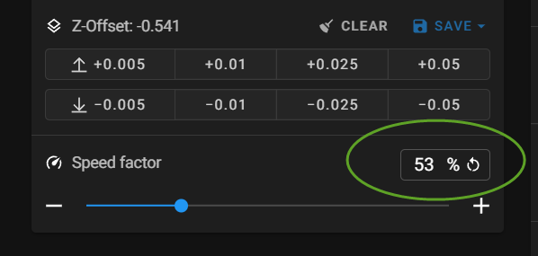

I've managed to get prints to work if I print one object at a time (that new exclude object feature has saved a couple of prints. I wouldn't have been able to use it if I hadn't been made aware of the adaptive bed mesh. Thanks!)
Most of my lifting starts when I'm making the skirt. My slicer (I'm using CURA for now) is set to make 3 turns around the print before it starts. When the 2nd skirt line touches the first, the first skirt line lifts from the bed in some areas.
I think I'll try my next print at 50% speed. Either that or just continue to print 1 by 1 until everything. is complete. Would probably be faster the way it is now, but I guess it wouldn't solve my issues.
