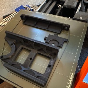

Next step is verifying that it's square enough, as soon as I find one of the measuring tapes I know are somewhere, and printing a couple of MGN9 rail guides right now.

Result of inventory, sorted by category and all marked. Extra useful since I have a full set of both CW1/CW2 and AB/SB:
I got an extra z_drive_retainer, but the PIF program apparently doesn’t supply the power inlet piece for Chinese kits, and Formbot also includes some Wagos for nicer wiring, so for now I just printed those plus the pulley jig tool in PLA:
Note that is the filtered inlet version, Formbot does ship the preferred and hopefully much safer components now.

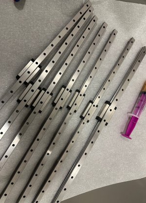

Pretty straightforward, no problems as far as I can remember. Next up I cleaned and greased the linear rails with the recommended Mobilux EP2:
A little bit messy but used the method I've seen eg @Nero3D used to really get the grease in there!
