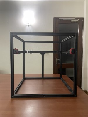

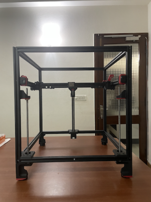

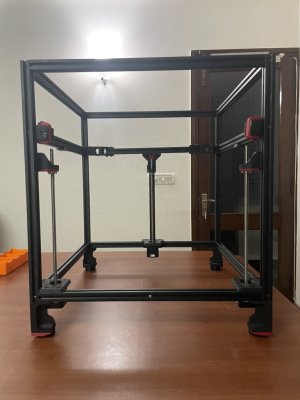

It has taken me around 2 months to get comfortable with the 3D printer terminologies, Voron Trident reference design, figure my way around the manufacturers and the vendors that can be used to source the VT350 components.
A big thanks goes to the post Self Sourced Voron Trident 300 Detailed Build Log India Edition by sanketss84. Given the fact that AliExpress cannot be used to source the parts in India, his post gave me confidence that self sourcing is indeed possible in India without it. His post gives a detailed source of all the parts from BOM. I did an independent search for all the parts, but have referred to it when I had trouble finding vendors for some of the parts. The discussions on Voron Design Forum has been very helpful in a lot of my decision making.
I just finished ordering the last of the parts. So the parts are slowing tricking in.

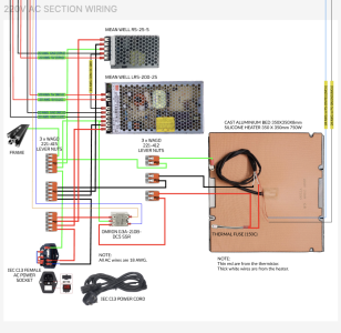

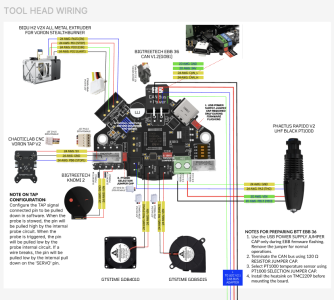

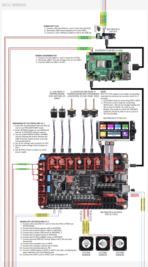

Voron Trident 350 Wiring
This is the wiring diagram for the build. This is my way of practicing the wiring virtually where I can afford to do mistakes. It consists of 3 sections.
(1) Tool Head section - build around BTT EBB 36 V1.2 (G0B1)
(2) MCU and SBC section - build using BTT Octopus Pro V1.1 (H723), Raspberry Pi 4B that I had lying around and BTT U2C V2.1 to connect the Extruder Breakout Board
(3) 220 V AC section - has the 24V PSU, 5V PSU, Heating Bed and SSR

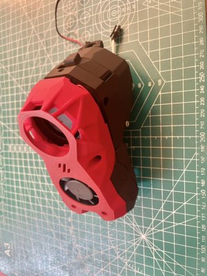

This has the most modifications using out-of-the-box Tap and Extruder.
  1. CNC Voron Tap Sensor V2.1 [biqu]
  2. BIQU H2 V2X All Metal Extruder for Voron [biqu] - replacement for Clockwork 2.
  3. Trianglelab Phateus Rapido Hotend 2 UHF PT1000 1 [TriangleLab]
  4. 50x50x15 Centrifugal Fan (GTSTime) [dc3d]
  5. 40x40x10 Axial Fan (GTSTime) [dc3d]
  6. KNOMI 2 [biqu] - I put KNOMI2 touch screen after a snafu with the TFT display.

Printhead
220V AC Section
  1. IEC Female AC Power Socket [dc3d]
  2. Omron G3A-210B-DC5 SSR [dc3d]
  3. Mean Well TBC-09 Terminal Cover [Custom 3D printed] - No one seems to stock it in India. I don't want to pay overseas shipping for importing it.
  4. Mean Well RS-25-5 PSU [3dprintronics]
  5. Mean Well LRS-200-24 PSU [3dprintronics]
  6. DIN Rail Mount Bracket for G3A SSR [3dprintronics]
  7. C13 Power Cord [Pre-existing]
  8. WAGO 221-415 Lever-Nuts [zbotic]
  9. WAGO 221-412 Lever-Nuts [zbotic]

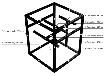

I got most of the parts delivered few days ago and started on the build. I thought I had the Voron Trident 350mm frame assembly figured out. The assembly manual gives the dimensions for 250mm and you have to figure it out for the other dimensions. I had to rework my understanding of the placement of the extrusions once I started building.

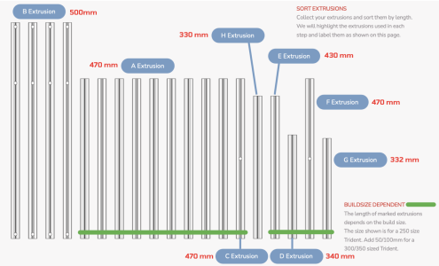

The lengths of 19 Aluminium extrusions used in the Voron Trident 350mm and their placements in the assembly are in the table below.
Extrusion​
Length​
Quantity​
Placement in Assembly​
A​
470mm​
9​
Top and bottom horizontal​
B​
500mm​
4​
Vertical​
C​
470mm​
1​
Lower back horizontal​
D​
340mm​
1​
Horizontal rear A-B motor joiner​
E​
430mm​
1​
X axis Gantry​
F​
470mm​
1​
Left to right bed support​
G​
332mm​
1​
Front to back bed support​
H​
330mm​
1​
Vertical rear support for D extrusion​
Total
19​
Here is the marked up image from the assembly manual.
Marked up image of the assembly I copied off Aliexpress.

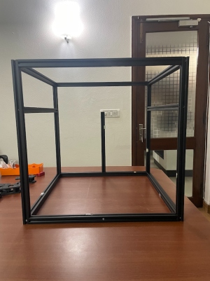

The very first image of my build. Only one of the diagonal is off by 2mm. Other are under 1mm difference.

I've completed the "Z AXIS" section of the assembly manual. It's started to look like a 3D printer now.
There were a few things I did differently.
(1) I used WD-40 on the linear rails before the Isopropyl alcohol cleaning. I had used a self made squirter for the alcohol for cleaning the earlier rails. I think that the pressure of spraying the WD-40 using the small thin straw did help in better cleaning. I let it soak for an hour before giving them an alcohol bath.
(2) I used the plastic packaging of the linear rails to make an Isopropyl bath as described in the LDO Motor's Linear Rail Greasing Guide. Why didn't I think of this earlier? One of the plastic packing was a leaky. But, it held long enough for the soaking. For one of the rails, a black chip also came out when I drained the alcohol. I think the cleaning worked.
(3) I got the ball end hex drivers. They were a lifesaver. It's an effort t saver. I think it saved me lot of grunt work in fixing the feet to the frame.
Completed the "X AXIS" section of the assembly manual minus the idlers. I'll be skipping over the "BELTS" section till it gets delivered. Going on to the "PRINT BED" now.
Not much of an issue assembling it. Keeping the screws loose during squaring was the key. I followed the instructions for squaring in the linked video of the assembly manual.

Moving on to the StealthBurner toolhead assembly. This is a heavily modified toolhead is not going to look anything like the stock build of SB toolhead. Major parts, not including the printed parts, are the following:
  • Phaetus Rapido V2 UHF Black PT1000
  • Biqu H2 V2X All Metal Extruder for StealthBurner
  • ChaoticLab CNC Voron TAP V2
  • BTT KNOMI 2 - still awaiting delivery
  • BTT EBB 36 CAN VL.2(GOB1) - going umbilical
  • GTSTime fans for parts cooling and hotend cooling
Regular Voron StealthBurner consists of 5 subassemblies based on the SB Assembly Manual. The modifications are as follows.
  1. Voron ClockWorks2 Extruder - This is replaced by Biqu H2 V2X All Metal Extruder using the umbilical print parts and M12 Cable Gland. I haven’t seen any official assembly instructions from Biqu. I think they assume that you should be able to figure it out from the STEP files. I followed the Use a BIQU H2 in a Stealthburner video on YouTube. I did run into couple of problems. First, the printed part for screwing the cable gland broke while screwing. I’ll just superglue it till I can print some modifications for it. Second, one of the threaded inserts if spinning loose and I can’t get the screw out. I think I’ll just put some Locktite on it.
  2. Tool Cartridge - This assembly is retained from the SB stock build and assembled using the Phaetus Rapido V2 instructions in GitHub.
  3. Distinctive SB main body (front cover) - Replaced by KNOMI 2 main body. I had to use a combination of the original StealthBurner Assembly Manual and KNOMI 2 User Manual. Though KNOMI 2 User Manual is well written, it’s not complete in itself for the full main body assembly. The instructions for cutting off the ears off the 5015 are in the How to use StealthBurner 5015 fan ear cutting jig.
  4. X Carriage - It’s not mounted as I’m still missing the A/B motors. If the shipment doesn’t arrive by the time I finish mounting my electronics, then, I'll just buy some extra ones from a different source. Biqu is still trying to figure out the status of the shipment.
  5. ADXL Mount - I’m not using this mount as ADXL is built into the EBB 36. EBB 36 sits towards the back of the extruder on printed parts.
Here are a couple of pics of the progress so far. It’s not a full assembly. I’ve just put it together for understanding the assembly. My overall impression is that the printed parts for the H2 V2X extruder could have been better designed structurally. It’s not as forgiving for a first time builder and does not have the same solid feel as the rest of the Voron Trident printed parts.
I’ll be unscrewing, prepping up the hotend, putting the blue Locktite on all bolts, screwing the bolts again, then connecting the power and data wires to the EBB 36.

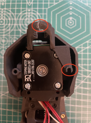

That was a BAD decision to do the StealthBurner assembly in 2 steps. Given the quality of the H2 V2X umbilical printed parts, I shouldn't have disassembled them.
As I had mentioned earlier, the cable gland mount had snapped earlier. It does not hold up under super glue. EBB 36 screw mount also snapped. I'll need to get it printed online. Probably go for a higher infill.
It's no wonder that the stock Voron build without modifications is recommended as a the first build. I might also assemble the Clock Work 2 for a comparison in build quality.
