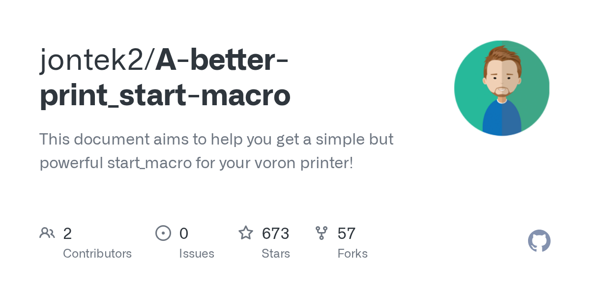

is there some advice on setting orca slicer for the first time for a voron trident build. I am right now working on setting my print start and print end macros.
referring this for print start
I still have to do my first print. so far things have been just about calibration and printer over all checks.
I think I had to add one or two lines but the default Orca is setup pretty well already. And I do like the better print startup, after reviewing it, it looks pretty close to my startup.
