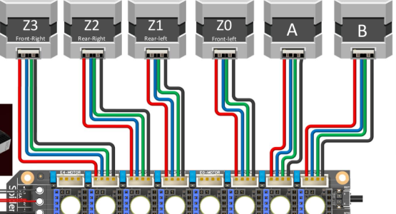

Finishing the electrics found all 6 of motor wiring looms had pin 2 & 3 reversed on motor plug, that's 8 plugs in total that were wired incorrectly.

Hi Paul. Just wanted to say your build thread for the Fysetc Spider V3.0 H7 Voron 2.4 has been a nice resource, really appreciate you sharing your progress.
I'm currently working on my own build with the same kit, and I've run into an issue getting homing to work. I'm suspecting a wiring mistake on my stepper motors, specifically the color order of the z steppers.
I'm seeing this error when attempting to home:
TMC 'stepper_z' reports error: DRV_STATUS: 001f00e0 s2vsb=1(ShortToSupply_B!) ola=1(OpenLoad_A!) olb=1(OpenLoad_B!) cs_actual=31<br>
If it's not too much trouble, would you mind posting a quick photo of your stepper motor connectors showing the wire color order? It would be immensely helpful.

Finally found the issue, and yes that error I posted came after I had all the cables with the exact same connections as in that pdf. The machine was able to power up without exploding but the moment I tried to home it, klipper complained with that error in all Z and A, B motors. It starts complaining about stepper_z but if you disconnect that one, it complains about stepper_z1 and so on.
I tried a lot to re-interpret the confusing motor schematics pdf and tried many combinations of connections but what ultimately solved the issue was testing the motors with a multimeter. Turns out that the coils are wired completely different from what I expected from the pdf. Of the pins 1, 3, 4 and 6 they use, the 1 goes with the 4 and the 3 with the 6, at least with the motors I received.
On the spider side, the pinout image they have on github is clear about what are the A coil pins and what are B.
After figuring that out I decided to name 1, 4 => A and 3, 6 => B (or B and A, I don't remember) and the error disappeared. Now the issue was that all motors were going in the opposite direction, but I didn't have to re-wire them again, I switched the dir_pin adding a ! exclamation mark in all of the steppers, or removed it if it already had one, and finally was able to home it.
