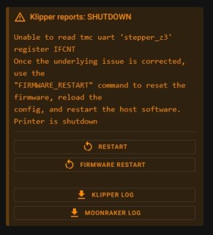

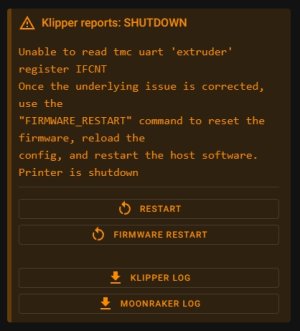

Ok now... another issue. Changed the wiring and almost all is ok. I tried the printer.cfg from BTT and the variant from voron docs page and have the same issue. Wen I try the STEPPER_BUZZ command the Motor 6 (one of the Z steppers) position on the motherboard moves the stepper only in one direction(I mean both steps of the movement that are supposed to be up-down are up-up), and does not change direction when I edit the "dir_pin" exclamation sign. Motor 7 ( Z3 ) and 8 (extruder) just kill Klipper. I tried changing the drivers with the drivers from x and y, I tried connecting the x and y steppers to position 6 7 8 on the motherboard and I have the same issue. Bad motherboard?

Ok... Figured all out. All config files that I found are for the V1.0 board. I have the v1.1 board. I could not find a change log or something that says to change settings in config files. After some research in the schematic of the board I found the right pins for Motor 6, 7 and 8. Now the mechanical part goes ok. I will attach a text file whit the changes, if anybody need it.
