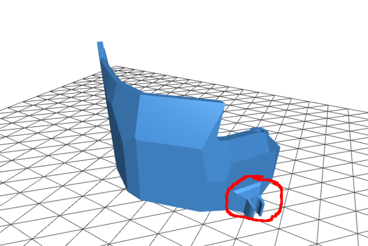

I played around with the amazing snap latches mod to hold the panels together:
The latch closes with a very satisfying thud.
