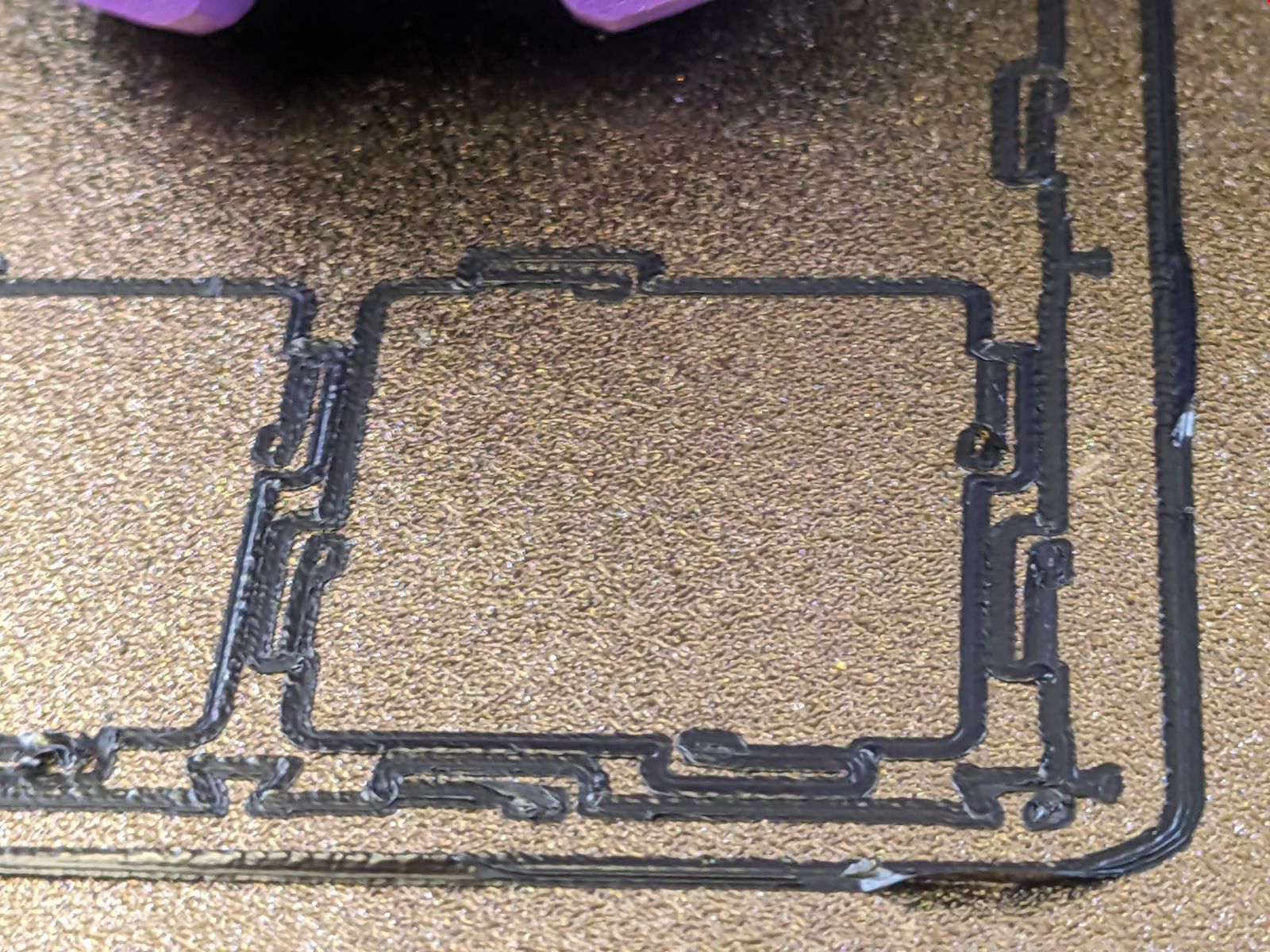

LDO Trident 250, complete 3D printer beginner

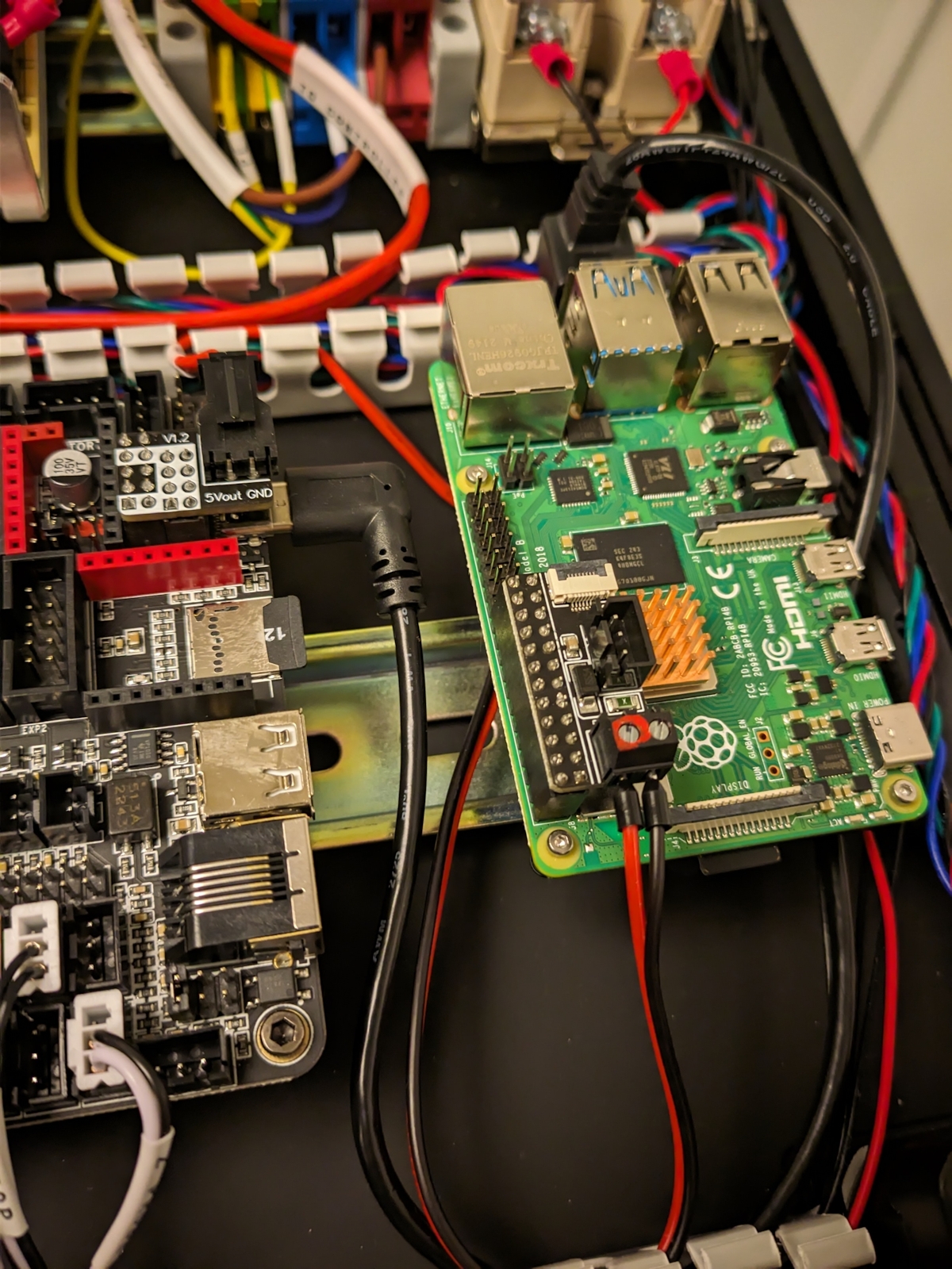

I've got another question:
In the LDO docs it says to double check that 24V/GND and 5V/GND aren't shorted. But where exactly are 24V and 5V? I think 24V is the V+ outputs from the power supply, but where do I find 5V?
This is with almost all of the wiring, except fans, the problematic hotend cable and also without the bed connected.
Is there anything that sticks out before I can dare to turn it on?
I plan to disconnect the HE0 and Pi before doing it, and I've tested that the power supply turns on and its little lIght turns green before connecting the Octopus.
The 5V would the power supplying the Pi. That's the little tophat PCB on the Pi. Your wiring looks good to me there, follows the LDO reference pic. But, double check the 24V wiring to your Octopus, it's not matching the LDO docs. I also notice you don't have the HE0 power to the breakout board--that's how your tool head is getting 24V.

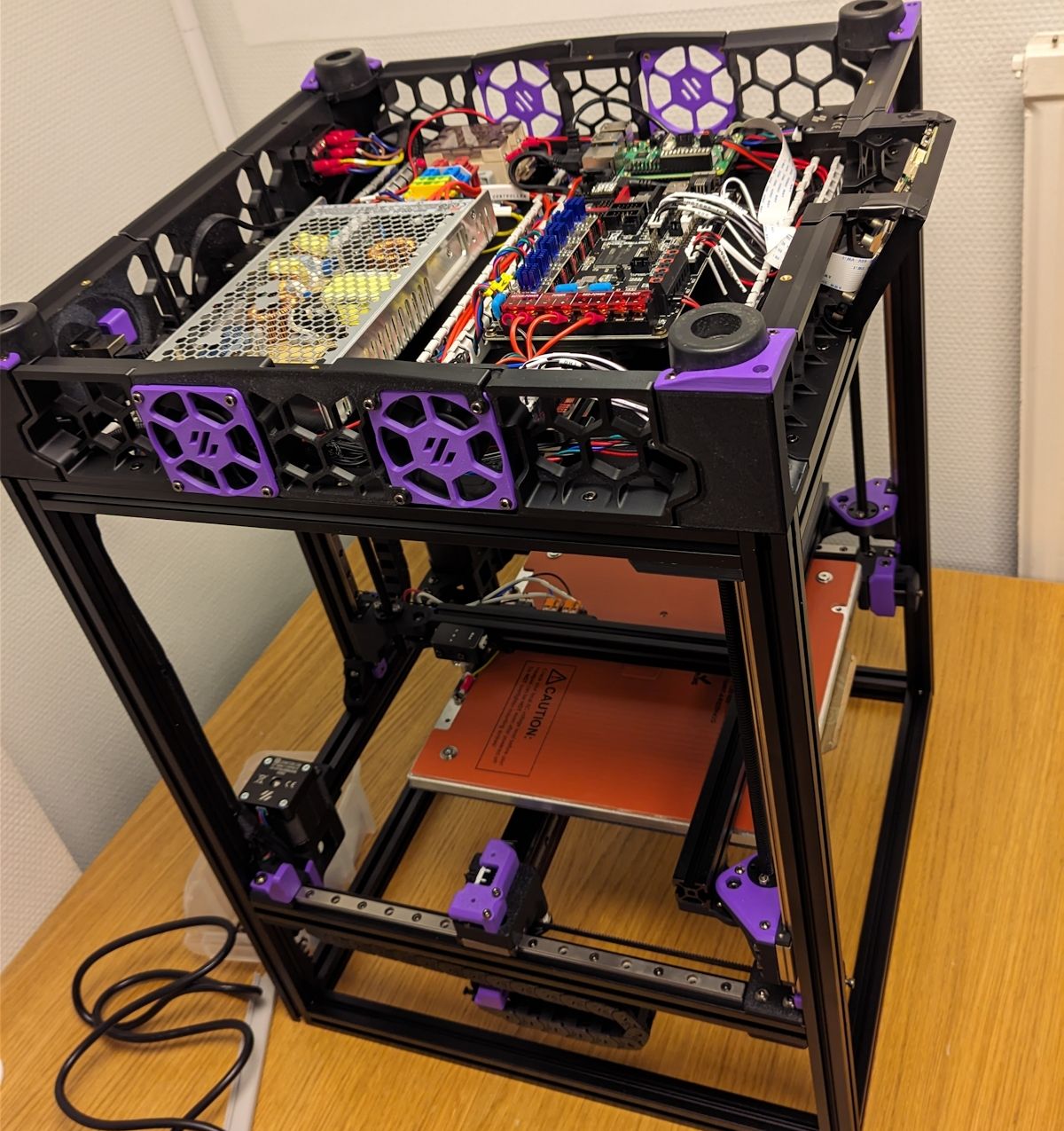

Part 4
Dread it. Run from it. Wiring arrives all the same.

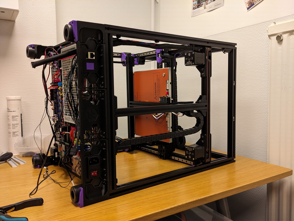

It’s time for the part of my VORON build that I’ve been dreading: the wiring.
It’s scary because I really have no clue what I’m doing, and mistakes can be very costly and time-consuming.
I’ve taken my time to double- and triple-check everything, and I took lots of pictures. I ran into some issues I’ll document here, but this post will mostly be filled with pictures to gawp at.

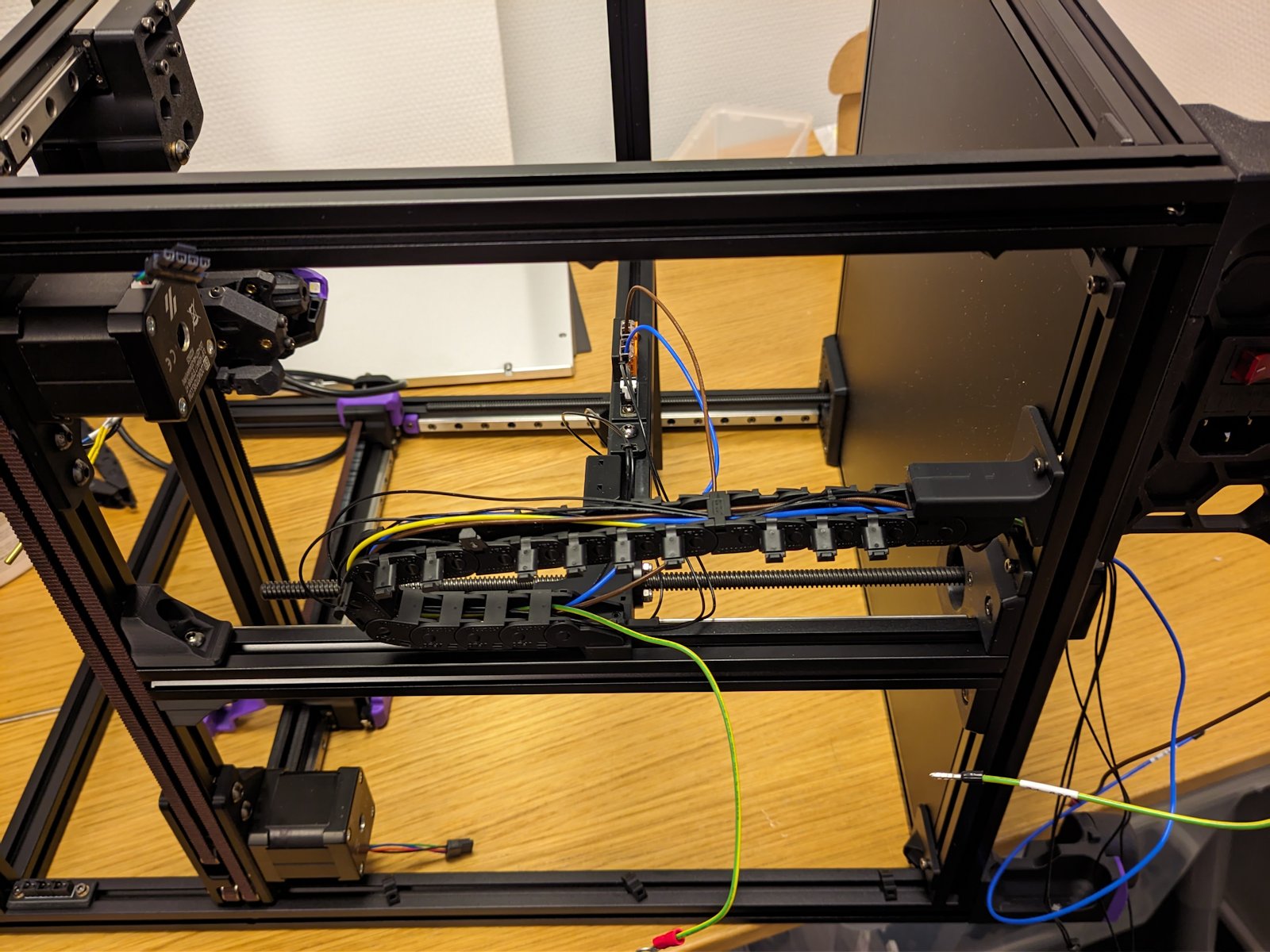

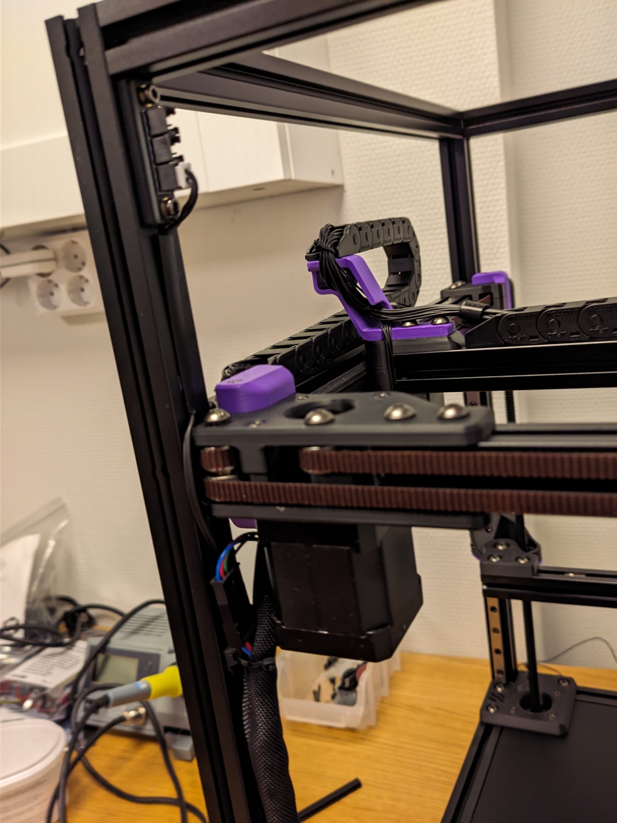

Cable chains
There wasn’t a ton of instructions on the cable chains, but I felt it went well.
I made some big mistakes here that caused major headache later on, but more on that later.
It was fiddly, but not the end of the world.

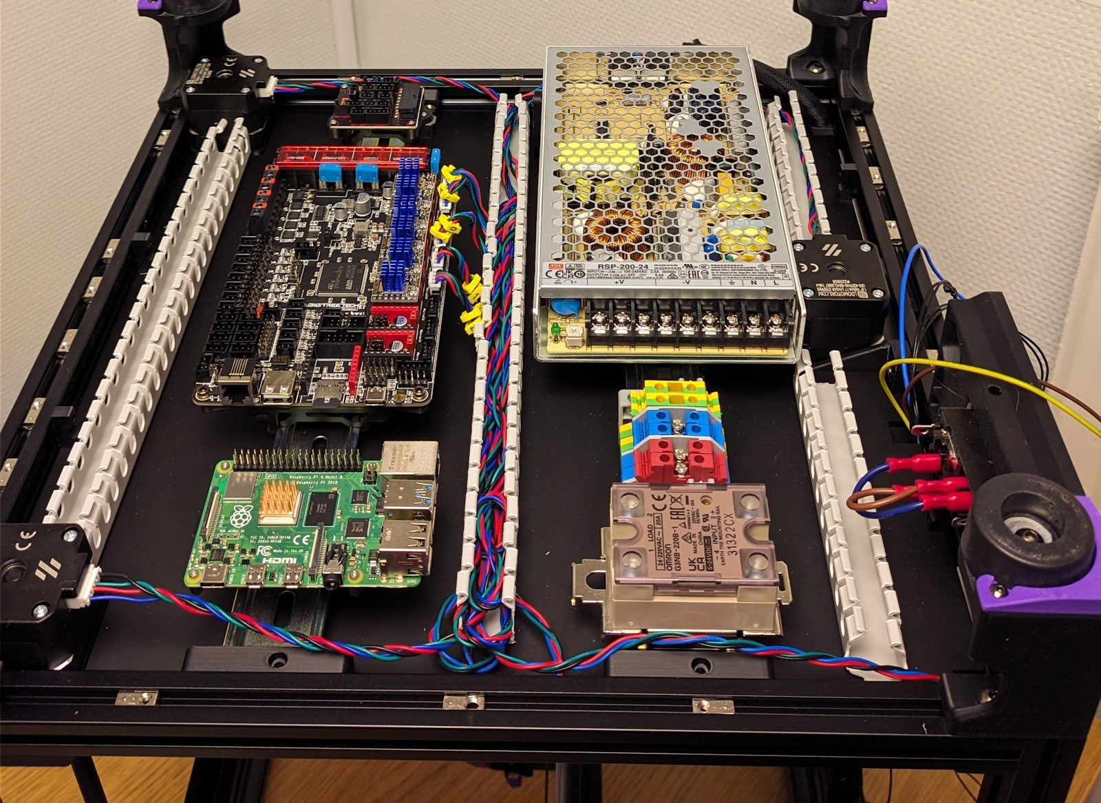

If we make the wires pretty from the start, we can just continue like that?

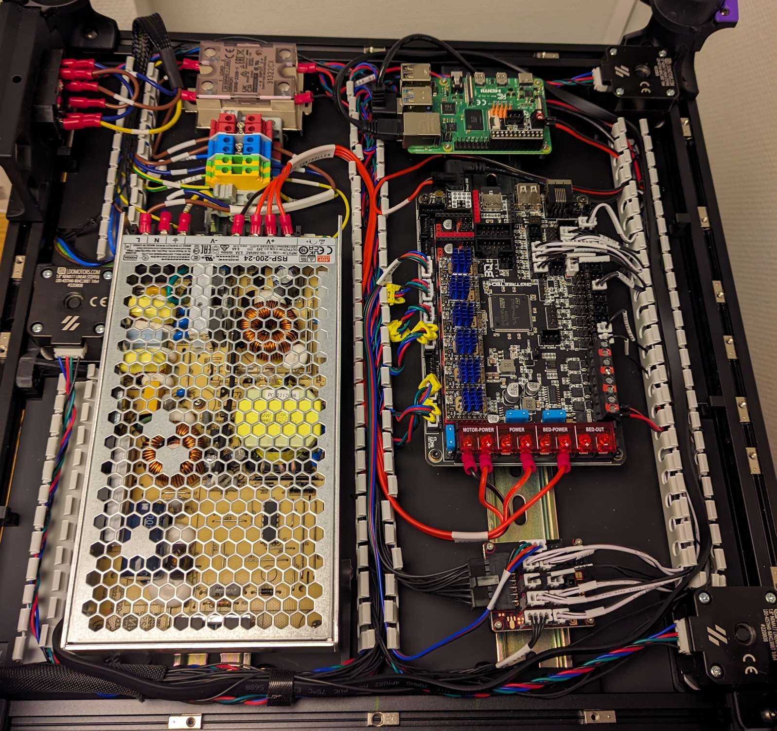

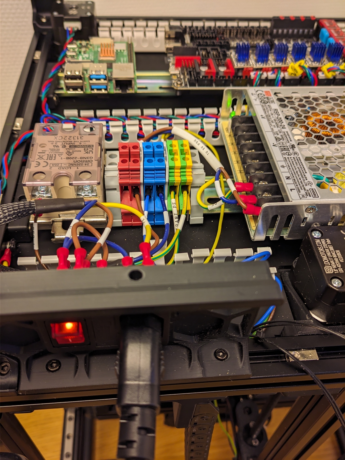

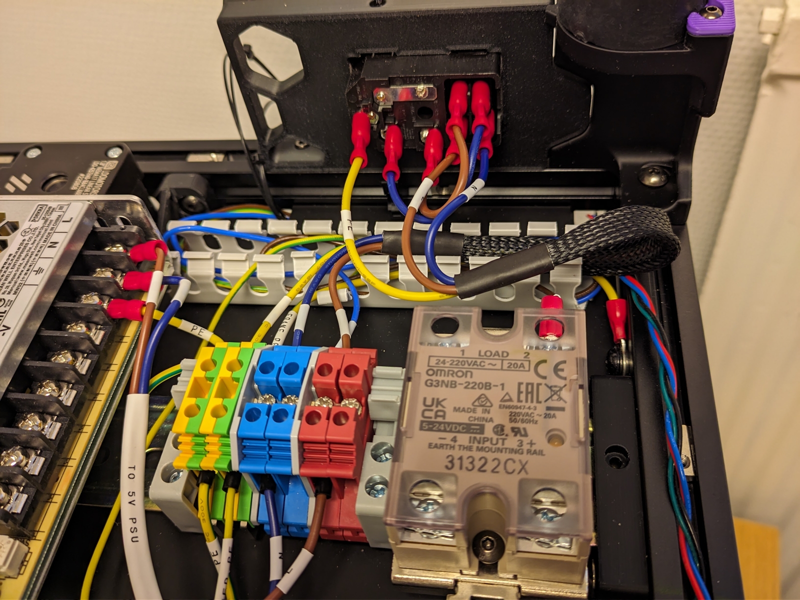

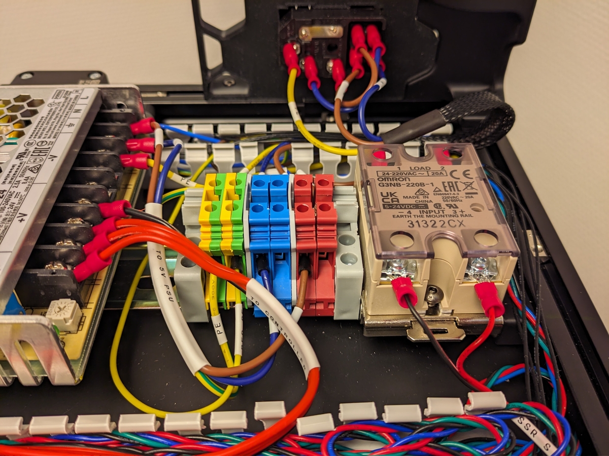

Main power
Yes, I guess I should’ve connected main power before connecting the motor cables, but the octopus isn’t connected yet so it’s fine…
I triple-checked that I don’t mix colors and I checked again that I connected it to the outlet properly.
Note that it says “TO 5V PSU” on the PSU cable. I think that’s a typo…
The green light turns on! I’m glad it didn’t burn up yet…

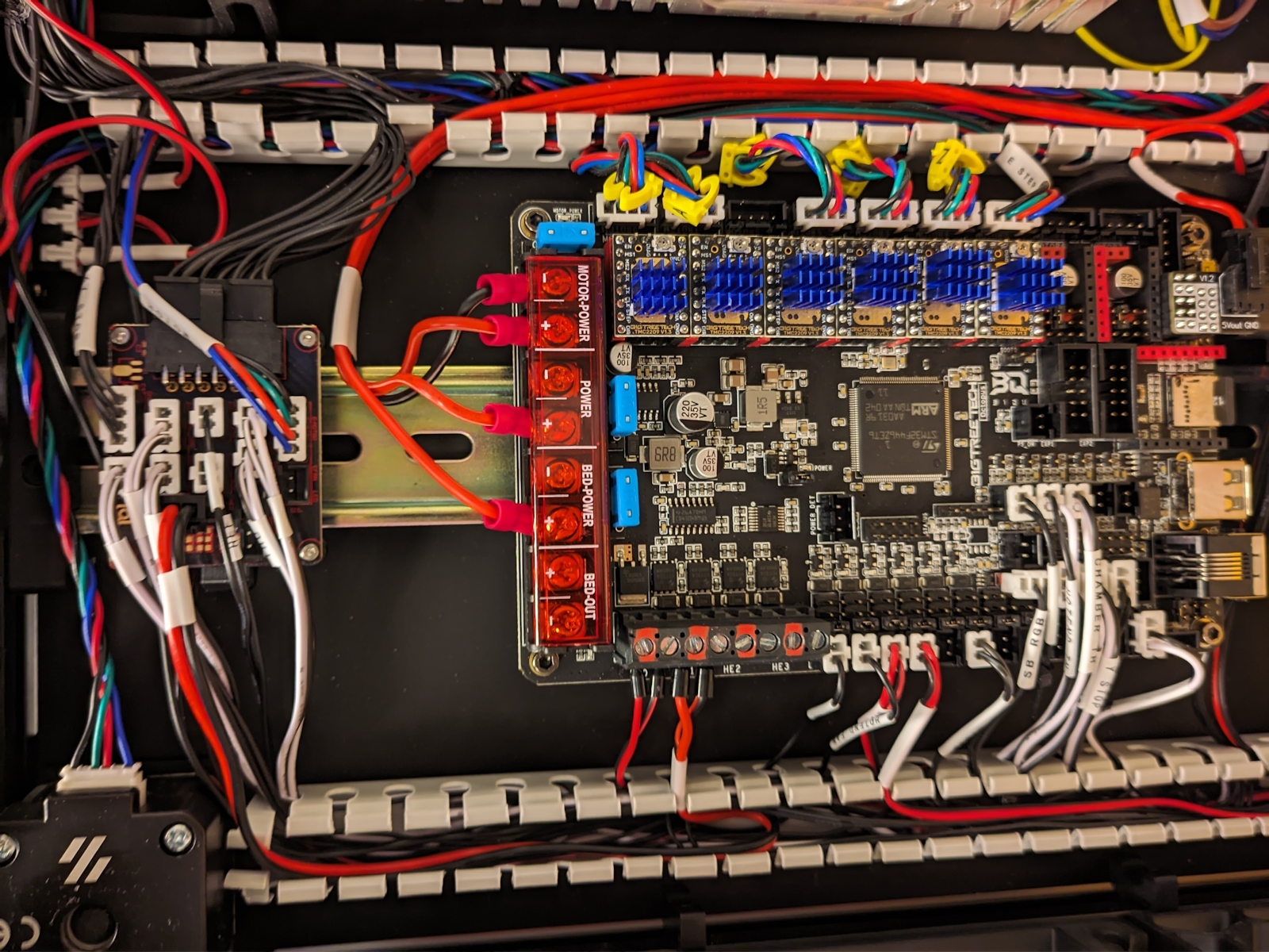

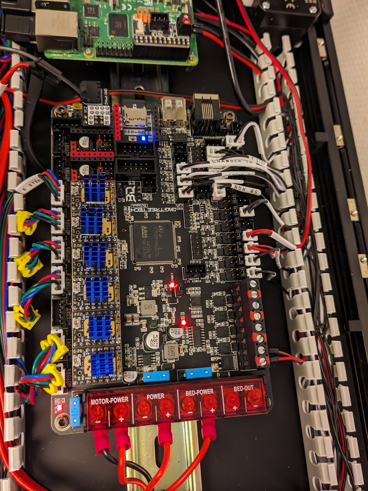

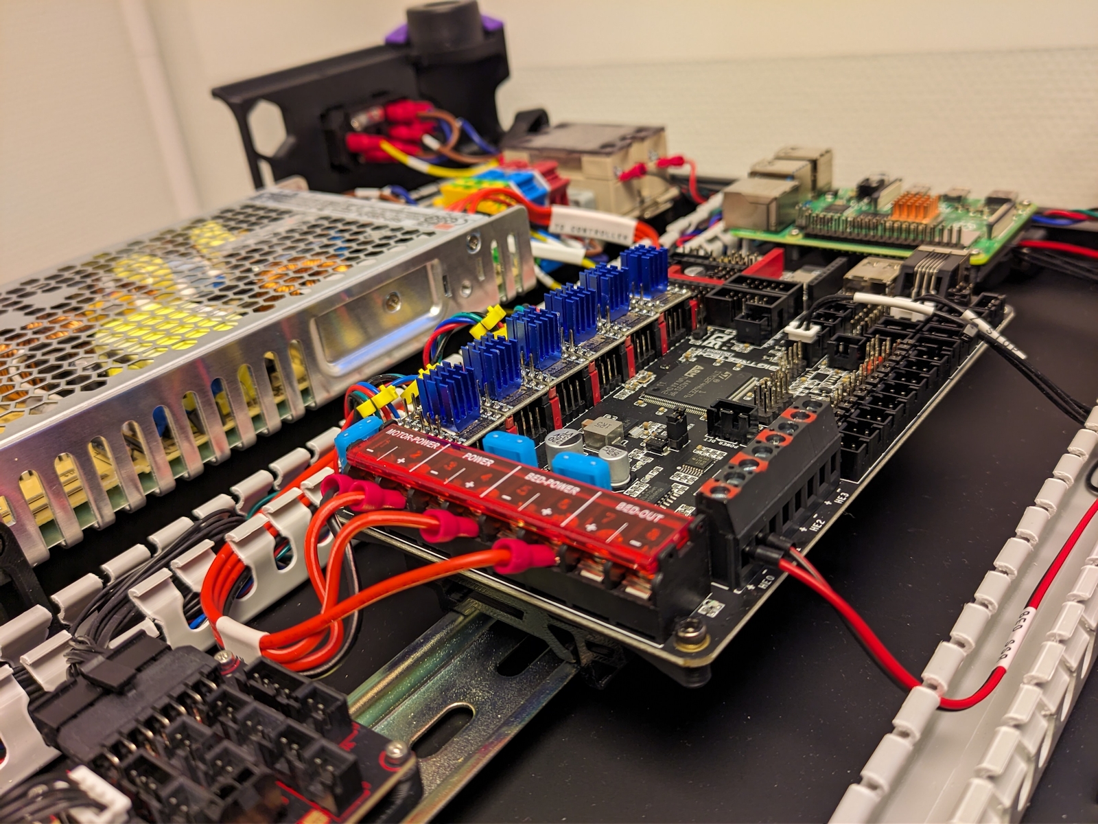

Octopus power

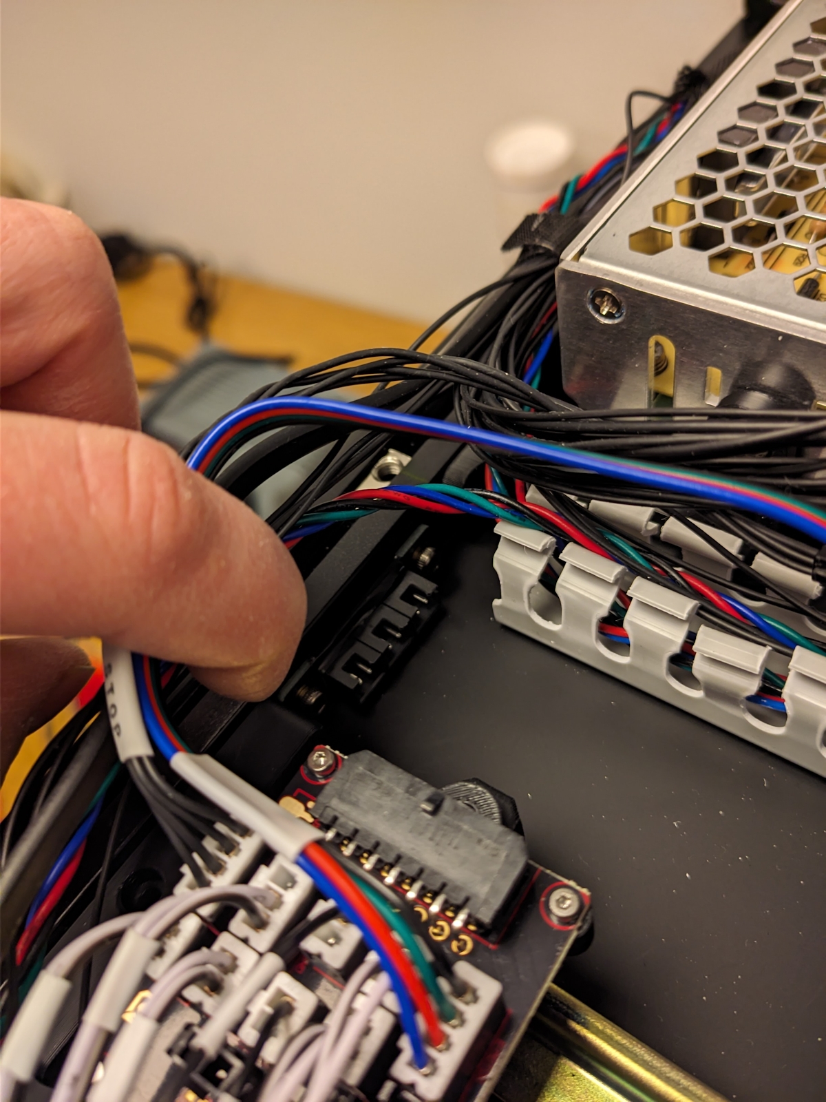

According to the docs, the SSR should connect to HE0 instead of BED_OUT. Fine.
The Octopus has the required power, but I didn’t check if it turns on at this point…
I mixed the 3 and 4 inputs on the SSR, but luckily I caught it when double or triple-checking.

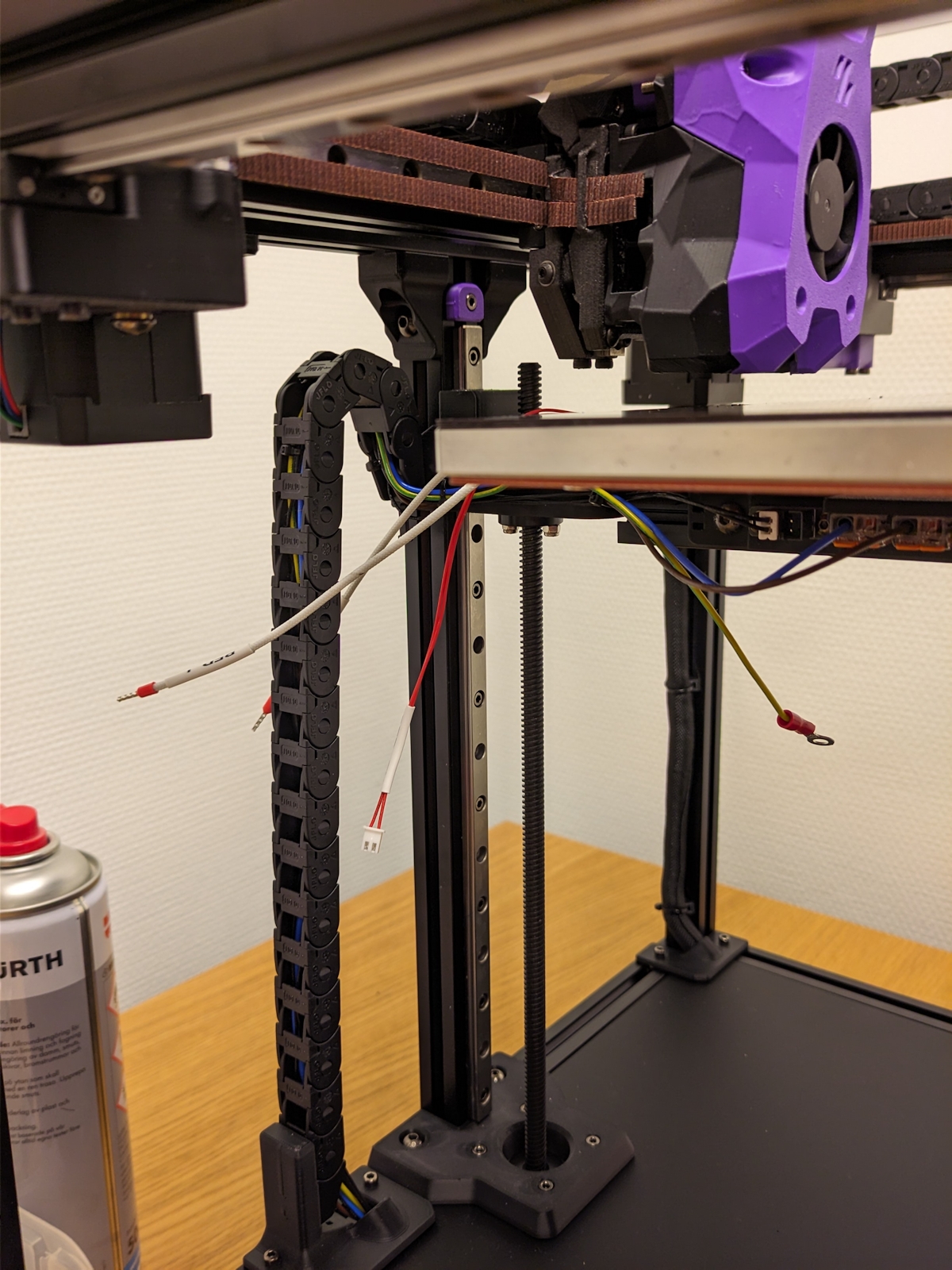

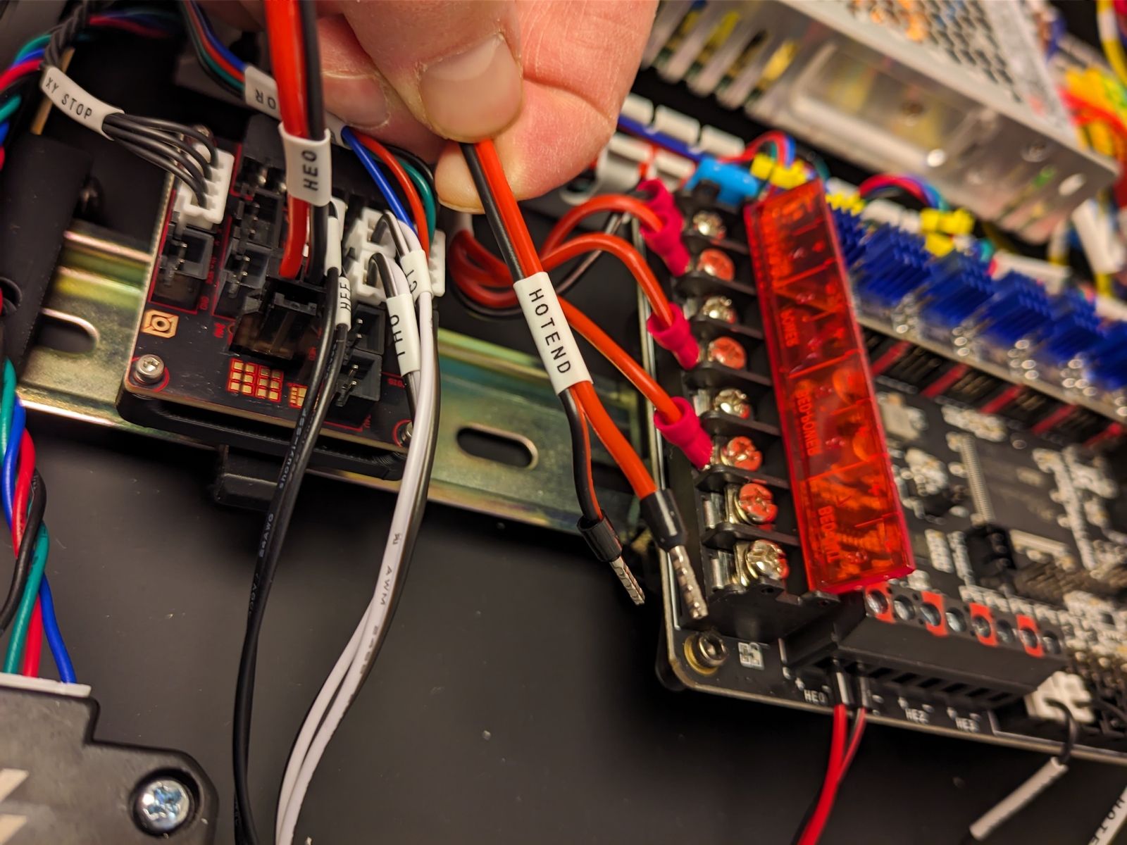

Wrong hotend cable?
When I was about to connect the hotend cable I noticed a problem.
In the wiring guide it says that I should connect the hotend to BED_OUT:
Breakout PCBCable label (breakout)ControllerCable label (controller)
HE0 ****HE0HE0/PA2BED_OUT
****The BED_OUT port in the Octopus controller carries more current than the HE ports, this allows you to use super high power hotends such as the Phaetus Rapido.
But the cable that I got doesn’t fit:
The hotend cable has “pin” type connectors.
My suspicion is that I got the wrong cable because the V2.4 wiring guide specifies that the cable goes into HE0 and SSR goes to BED_OUT, while the Trident has it reversed.
I complained about this to 3DJake (where I bought the kit from), who reached out to LDO where I got the response that they’re sorry, but I can connect the hotend to HE1 and change something in printer.cfg to make it work.
Not ideal as I do have the Phaetus Rapido, and according to LDO’s V2.4 errata it’s advisable to switch:
It has been reported that the Rapido hotend (by Phaetus) draws a large amount of current during initial heat-up. If you are using this hotend with our kit, please consider swapping the bed and hotend connections at the Octopus side.
I’m not thrilled about it, but I guess I need to find some spade terminals and change the wires later.
Full picture
A better overview of the wiring with breakout cables (and other things).

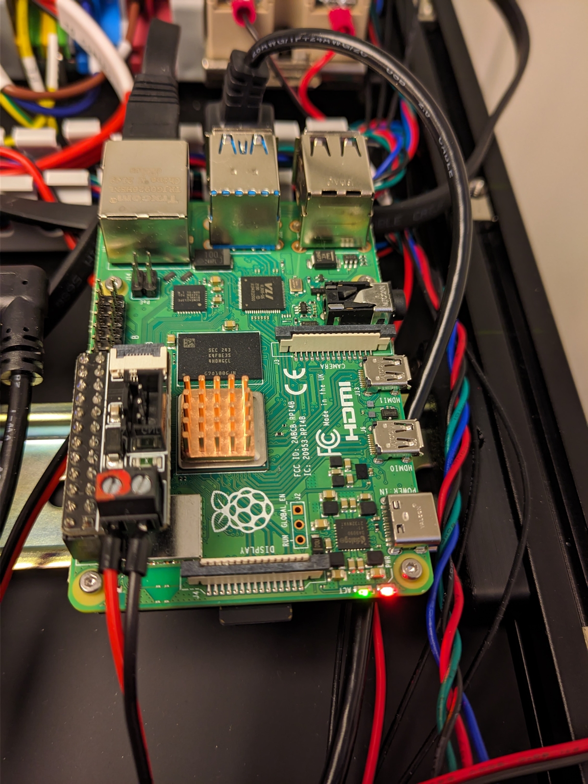

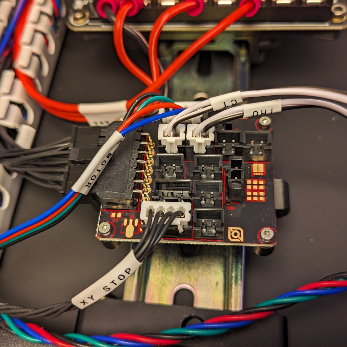

Raspberry
The Raspberry Pi uses 5V from the Octopus via some PCBs:
The Raspberry Pi is connected.

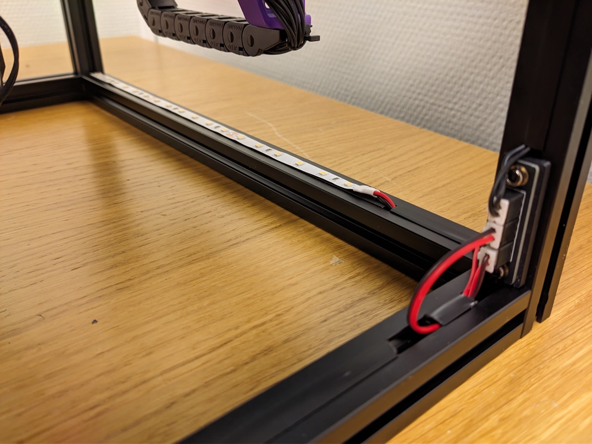

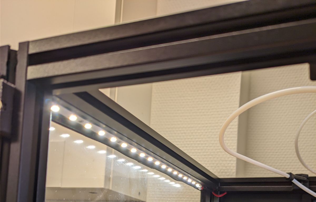

LEDs
I got a cute little PCB for connecting two LED strips in the kit.
It’s neat. I like it.
(I later moved the LED wire so it goes down in the front instead of behind the belts.)
I wasn’t sure how to mount the LEDs, so I added a wire cover below the LED strips to give it a platform to attach on.

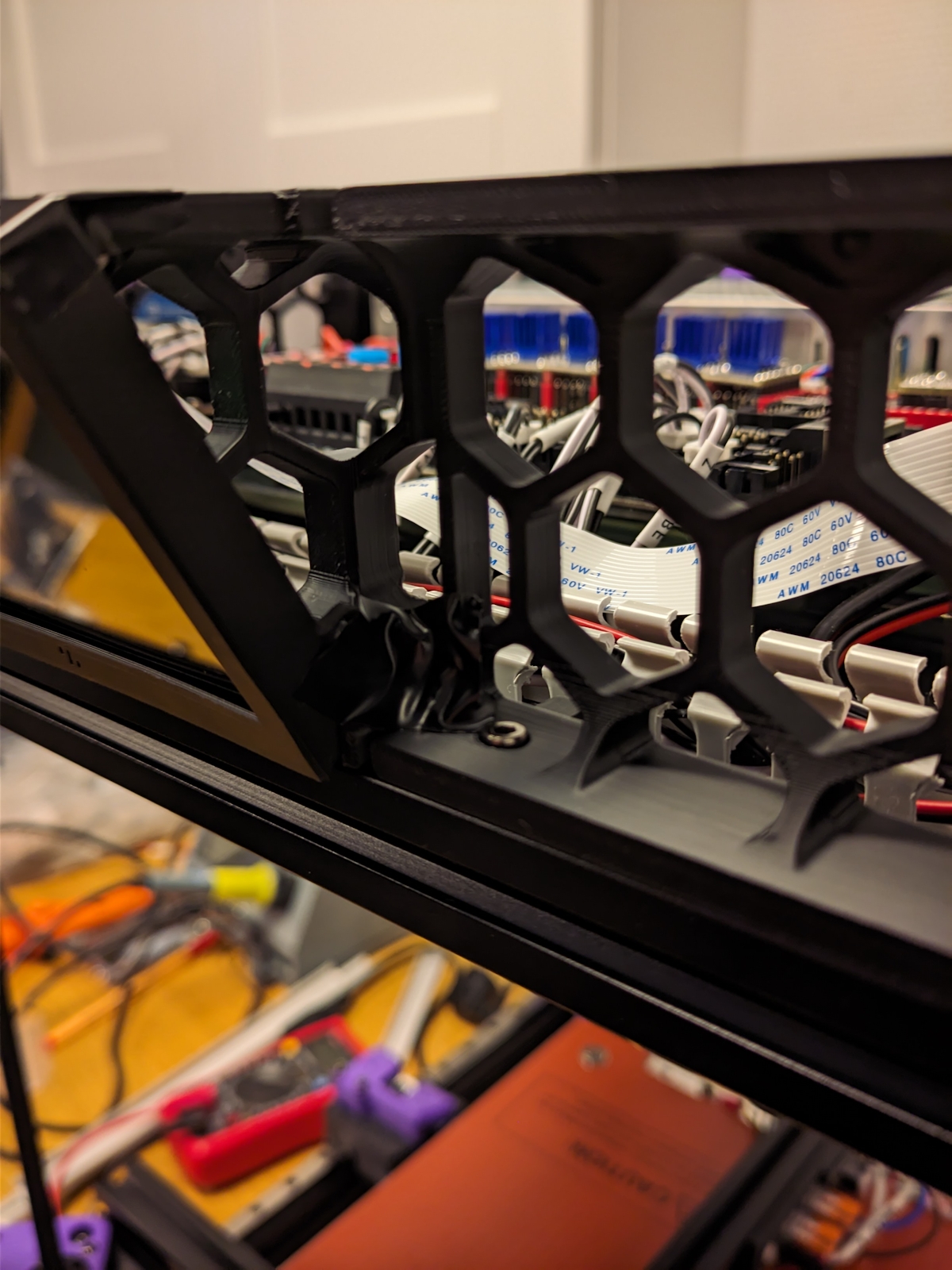

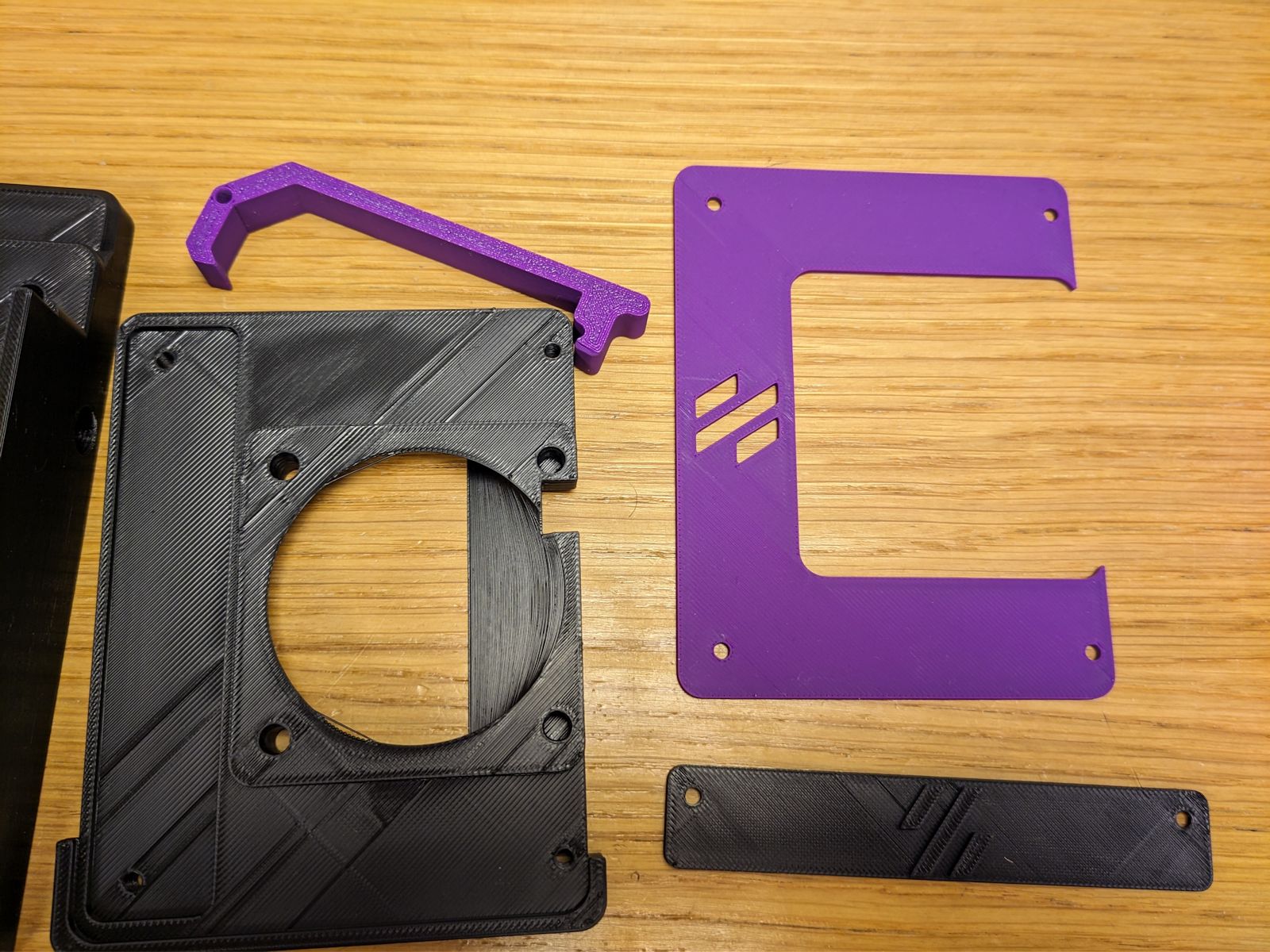

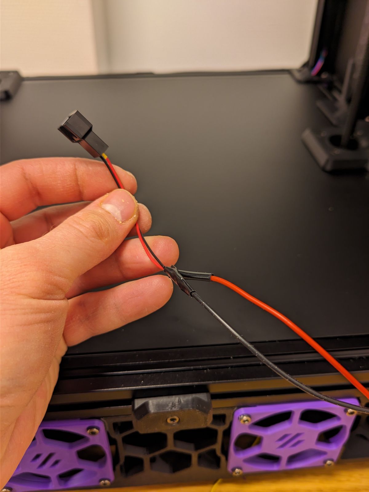

Controller fan
I should’ve gotten another PCB mount to mount the fan PCB, but I didn’t get one from the print-it-forward service. Maybe I should’ve mounted the fan PCB with the mount instead of the LED PCB, but I couldn’t be bothered.
Some tape to prevent shorts.
It was hell to get it mounted. Why didn’t I do this before adding wires…?

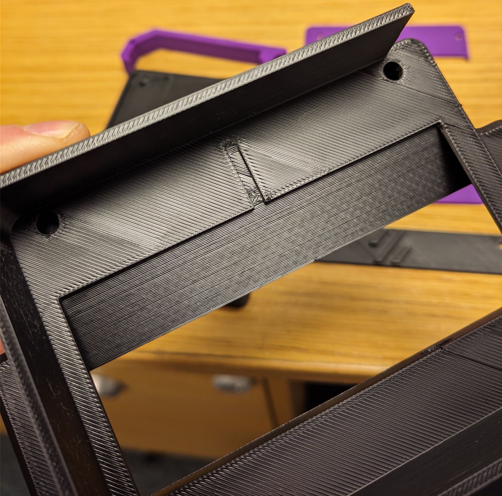

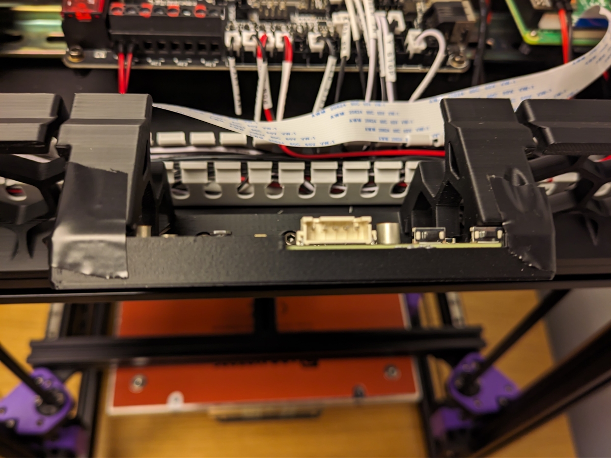

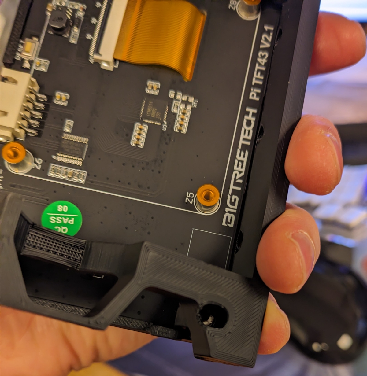

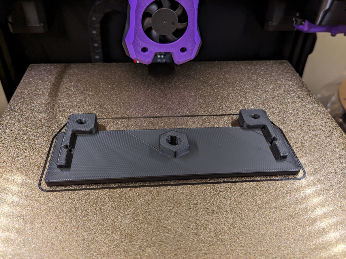

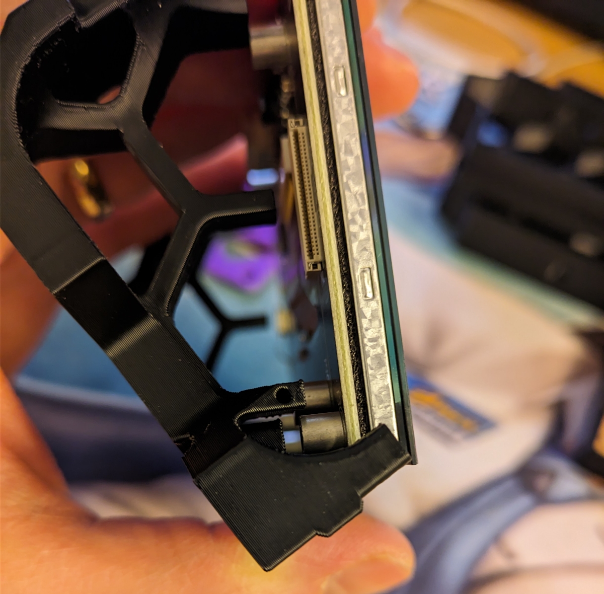

Display mount
I didn’t manage to get the display mount to work properly. The screws didn’t align properly and the display cover constantly fell off.
There’s a space here that I couldn’t close no matter how hard I pushed.
The screw hole is slightly off.
I had to use tape to keep it all together:
Tape for the cover so it doesn’t fall off.
Tape for the sides.
It works I guess but I need to print new mounts when I get the printer up and running.I believe the problem is that I have the 2.1 version of the display, while the mount is for the 2.0 version.

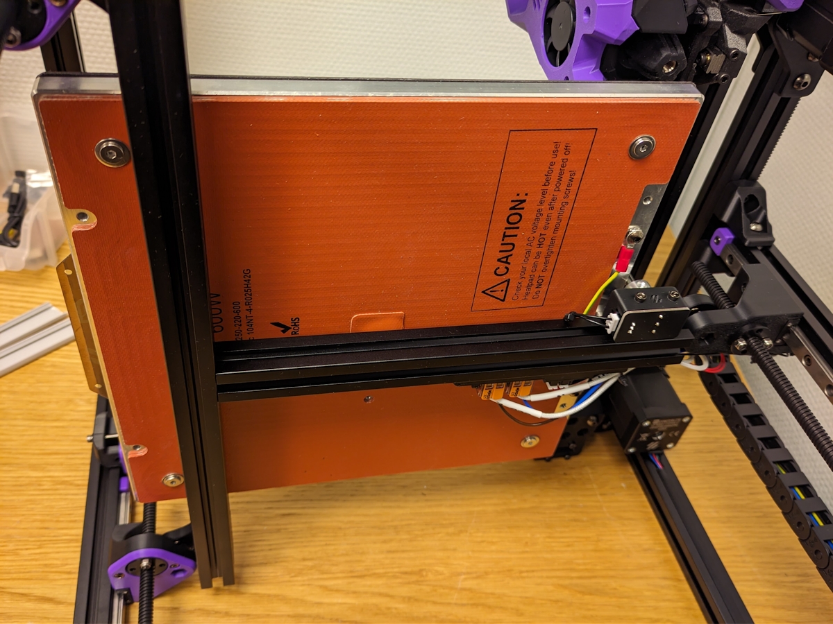

The bed
I had delayed installing the bed, but with the wiring needing to be done it was time to install the bed.
I was a bit worried about applying the magnetic sheet, but I think I managed to do it without any bubbles.
The bed is installed and ready.
Maybe the Z-endstop is completely unnecessary as I’m going to run Tap?Probably, but as it’s already installed I won’t bother ripping it out now.

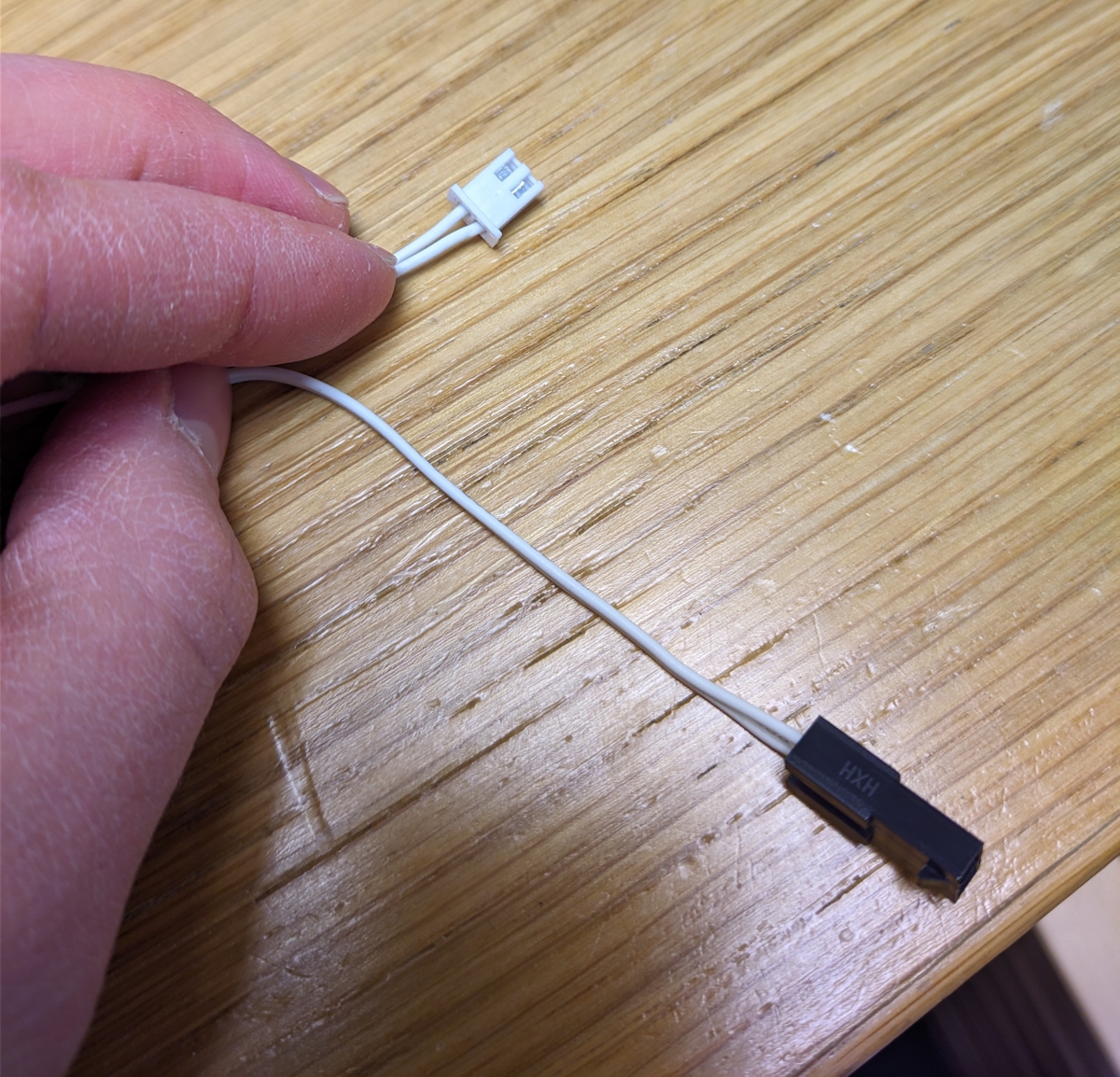

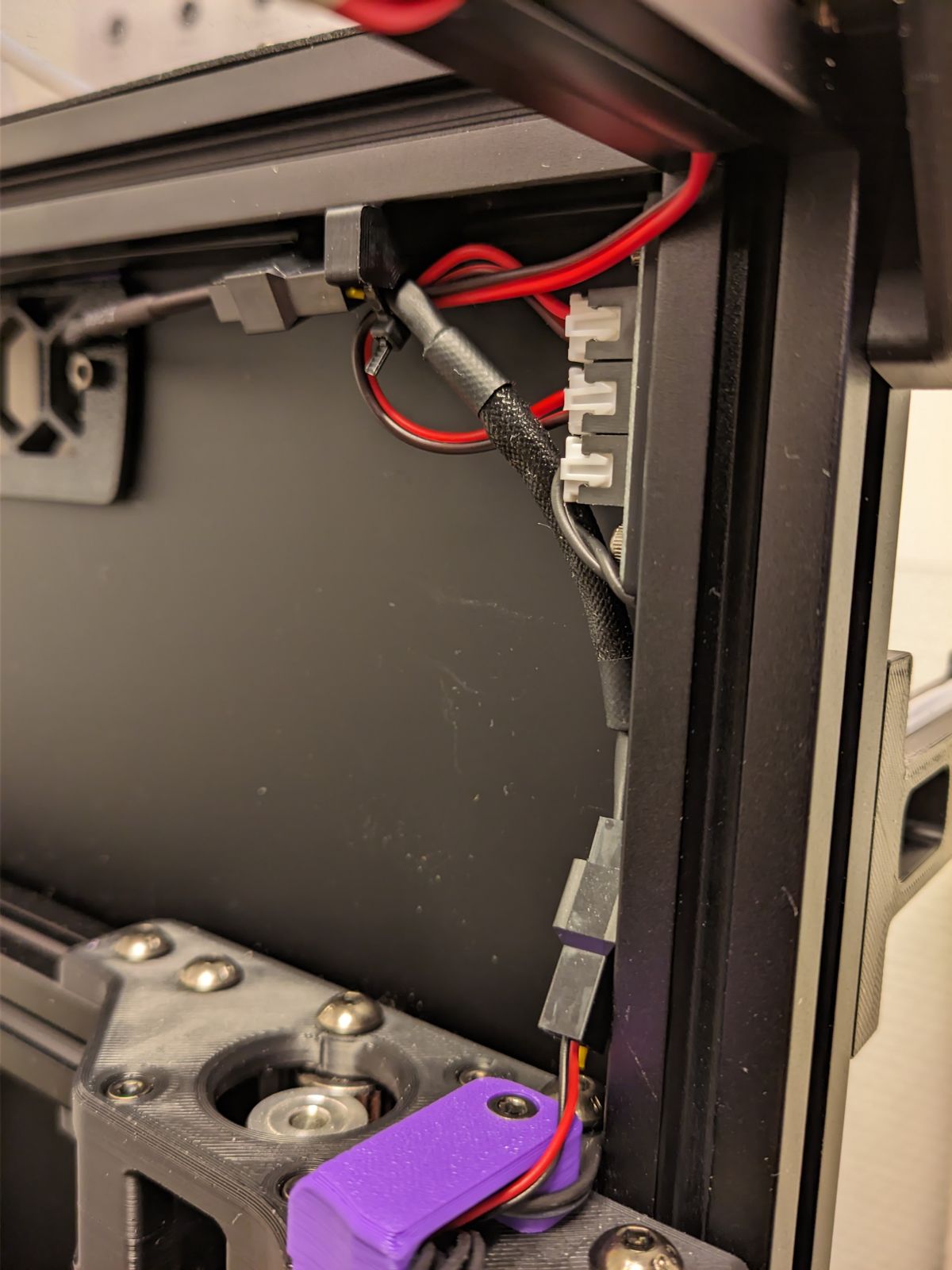

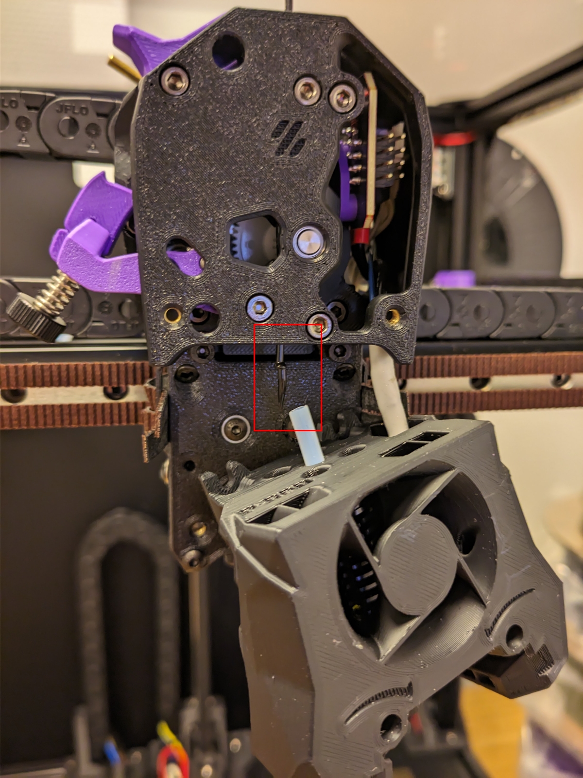

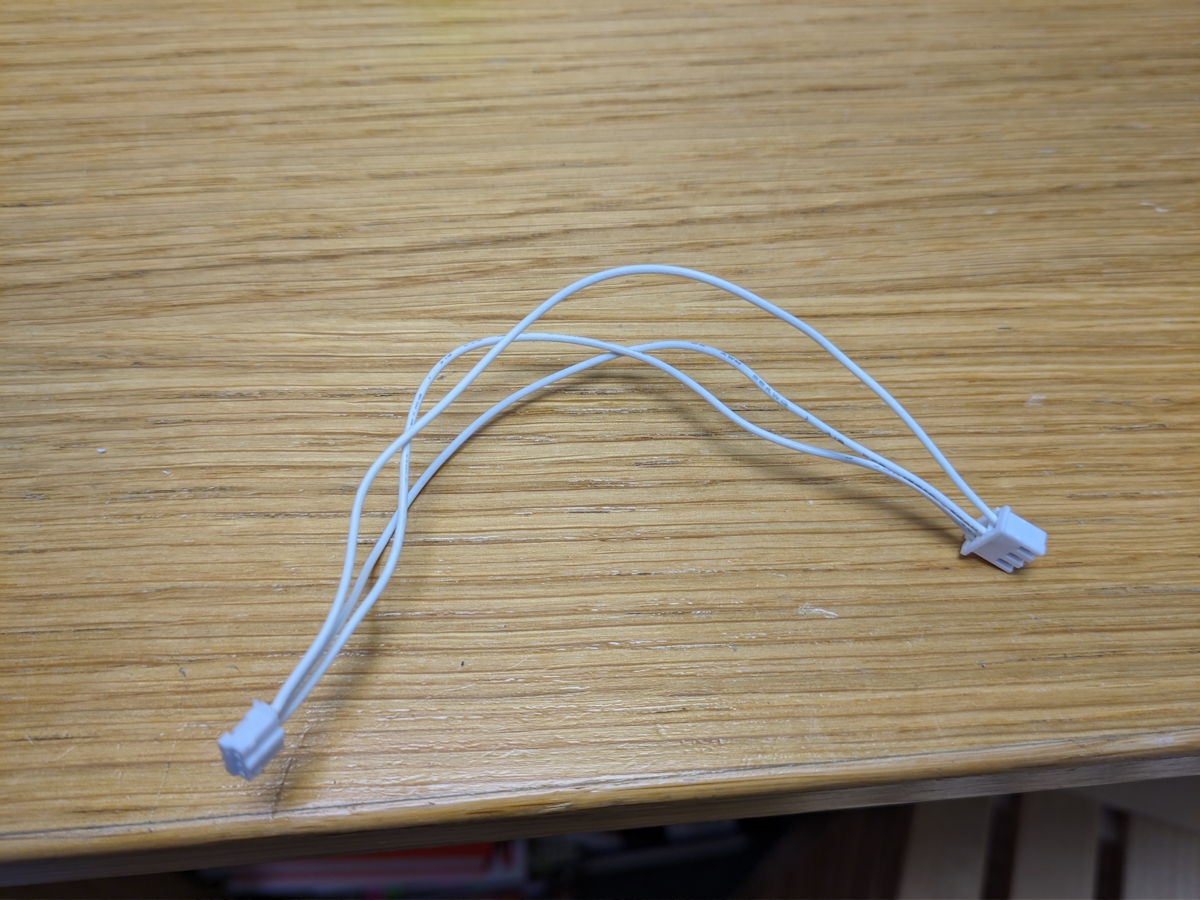

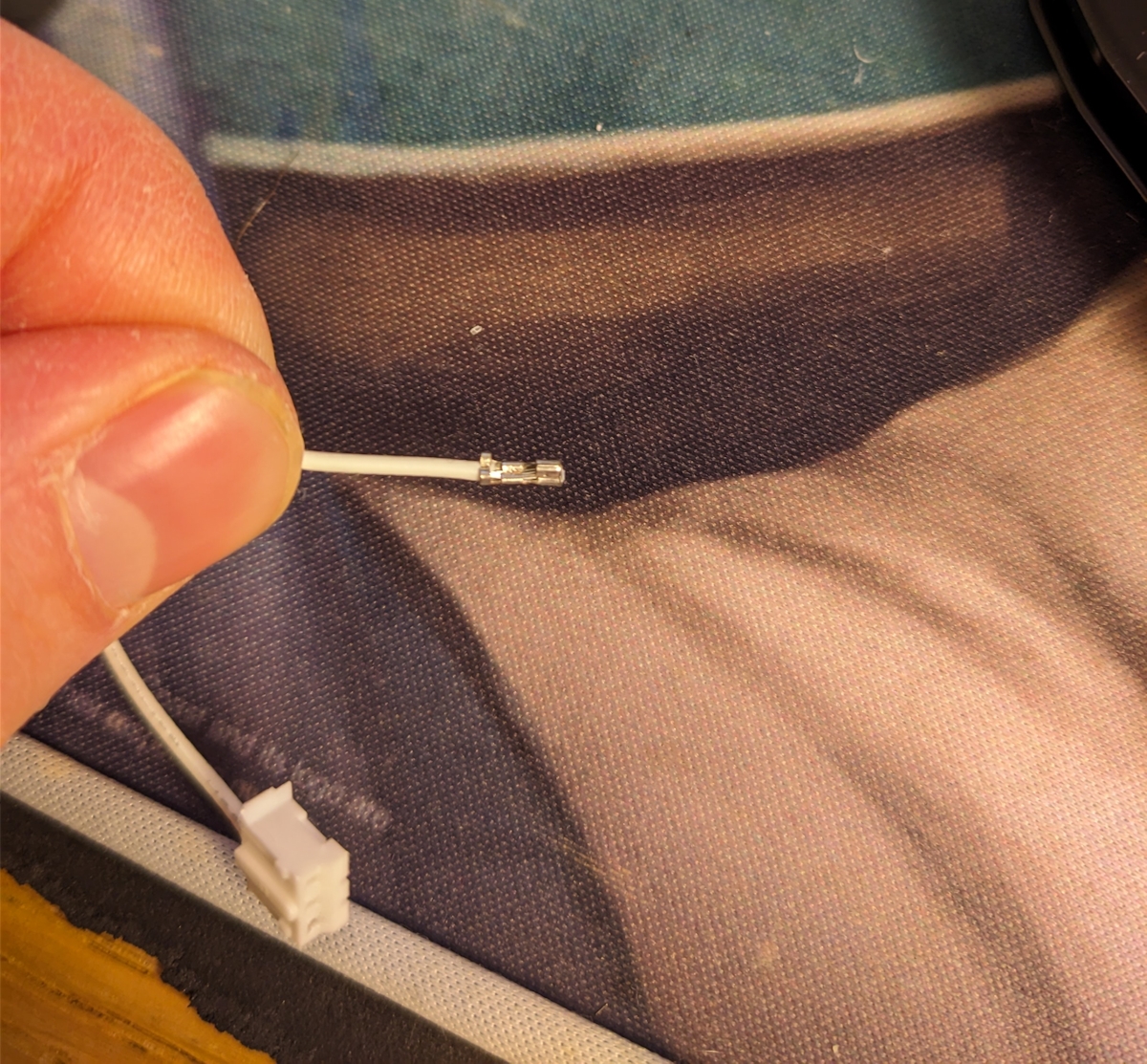

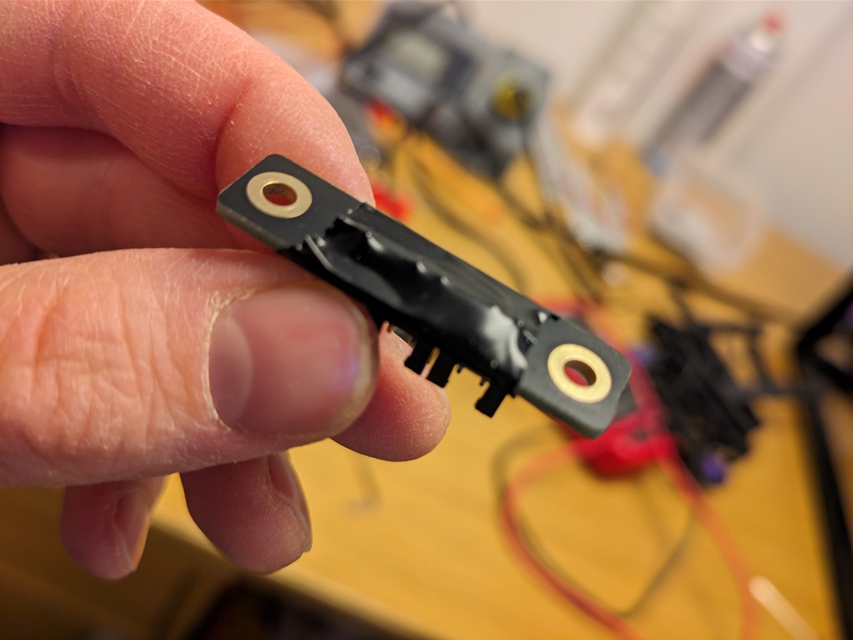

Missing Toolhead cables
When assembling the stealthburner I couldn’t connect the hotend to the toolhead PCB because the connectors didn’t match, and I also didn’t have a cable from the Tap PCB to the toolhead PCB.It was time to rectify that.
I didn’t do it when building the toolhead because I didn’t have the tools for it.So I ordered wire strippers, a crimping tool, JST connectors and some wire from Amazon.
No, I didn’t have a wire stripper and I’ve never created a cable before.
Crimping was fiddly but after a dozen attempts I think I got it down.
After I painstakingly created the Tap cable—with a 3-pin JST on each end—I noticed that the Tap PCB required a smaller connector than the ones I had. Oh no… Do I have to order another connector kit?
But luckily the Tap kit came with one such connector.(Please don’t break it.)
So I tried to change it… But after trying for some time I noticed that the wires I had were too thick, and didn’t fit this smaller connector.I nearly destroyed the connector while trying to insert the wires…
Things aren’t going my way, maybe I need to order (and wait for) new wire?
But wait!
Remember how I complained about the hotend cables having the wrong connector? Turns out the Rapido comes with extension cables with the connectors I wanted.The thermistor extension cable has thinner wires and the same JST connector I have…
Maybe I could shorten that cable and use the leftover wire for the Tap cable?
A shortened extension cable for the hotend thermistor.
Behold! My glorious cable!
I’ve spent an embarrassing amount of time and energy just to create this single cable. It makes me really appreciate that the LDO kit comes with pre-made wiring,I can’t imagine the frustration if I had to create all wiring from scratch (there’s a lot of it).

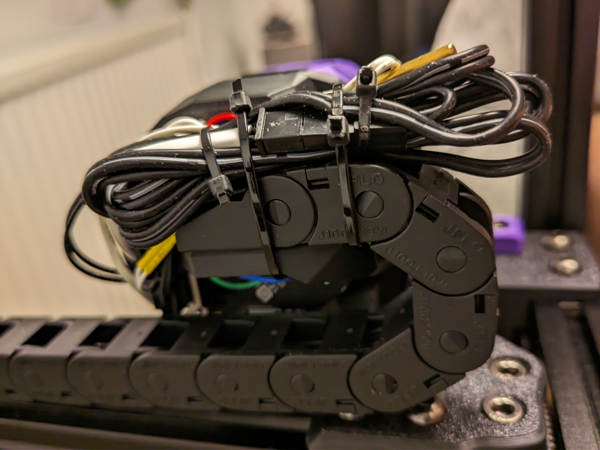

One problem I still have is the excessive wiring coming out from the toolhead, and I don’t really know what to do with it.
Too many cables. Should I try to hide it inside the cable chain?
Maybe I could try to shorten them all…But I’m not skilled or brave enough to try.
It’s not pretty… It sort of ruins the nice looking toolhead don’t you think?

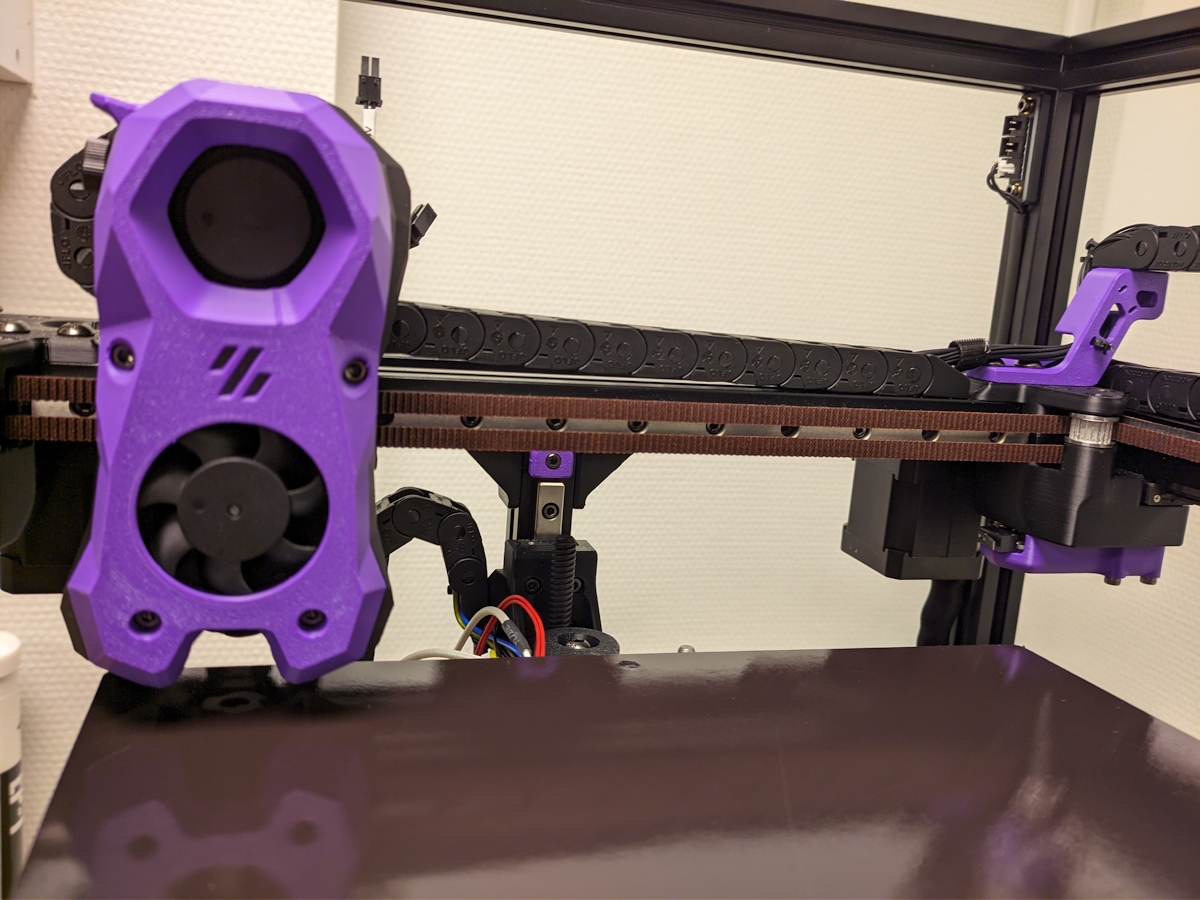

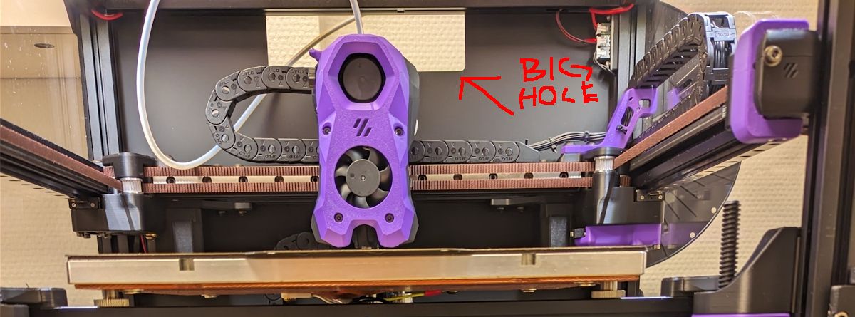

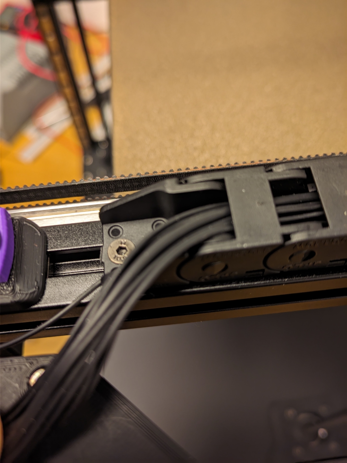

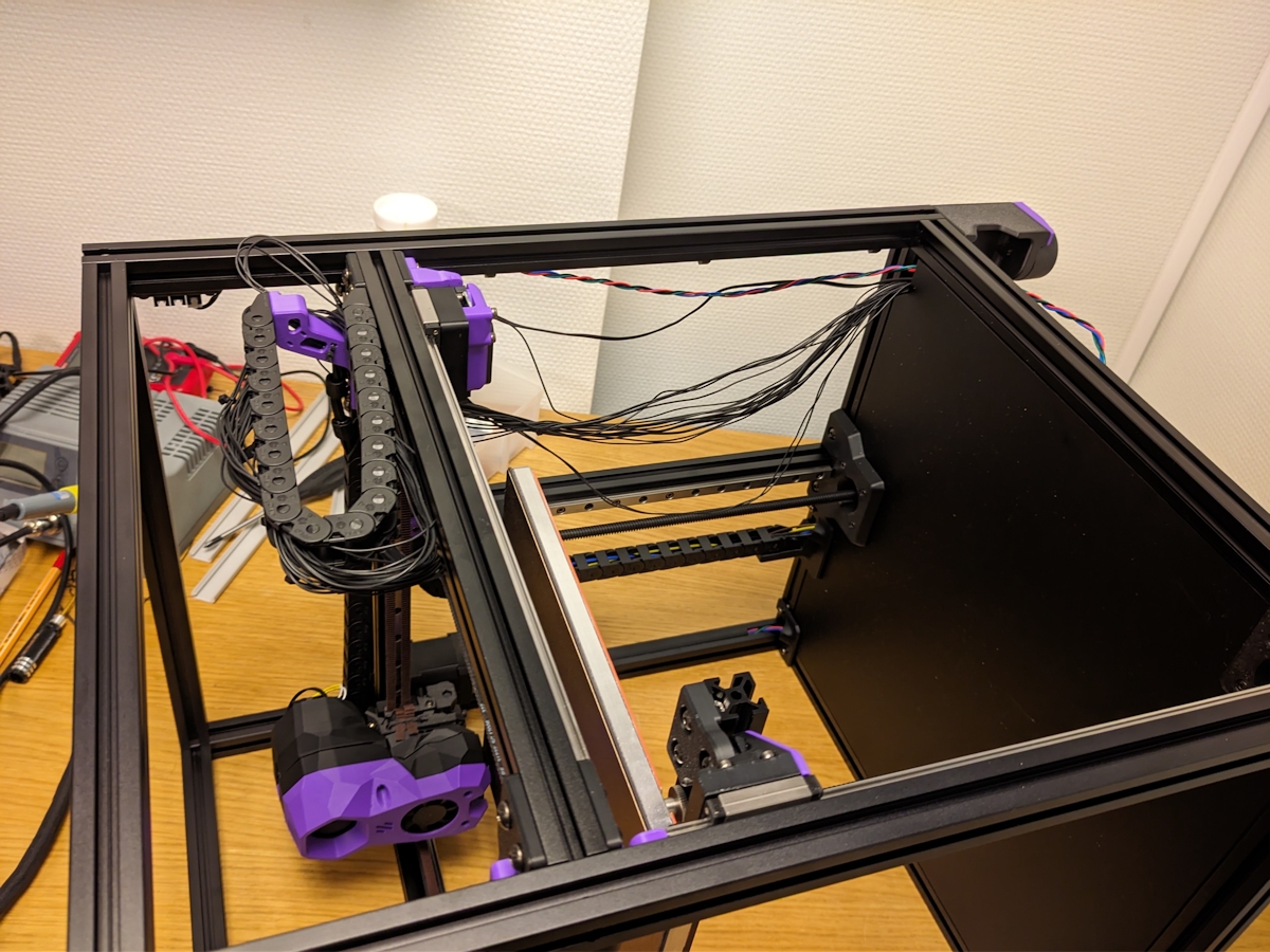

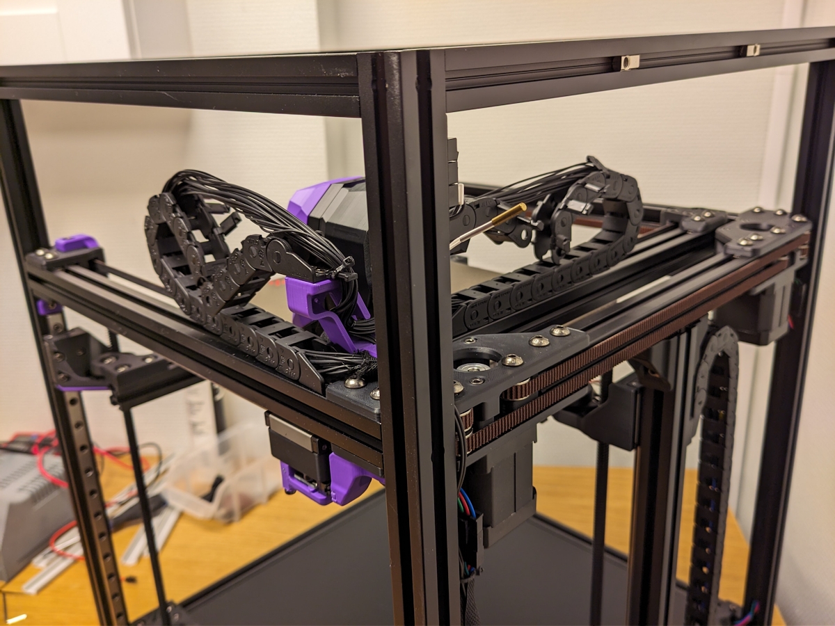

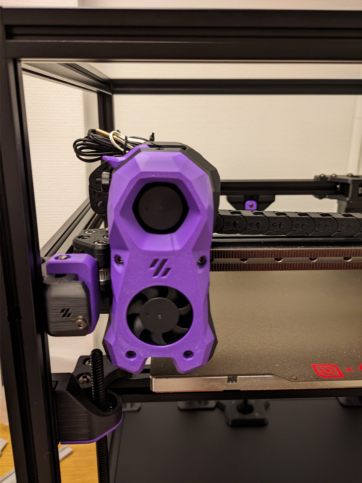

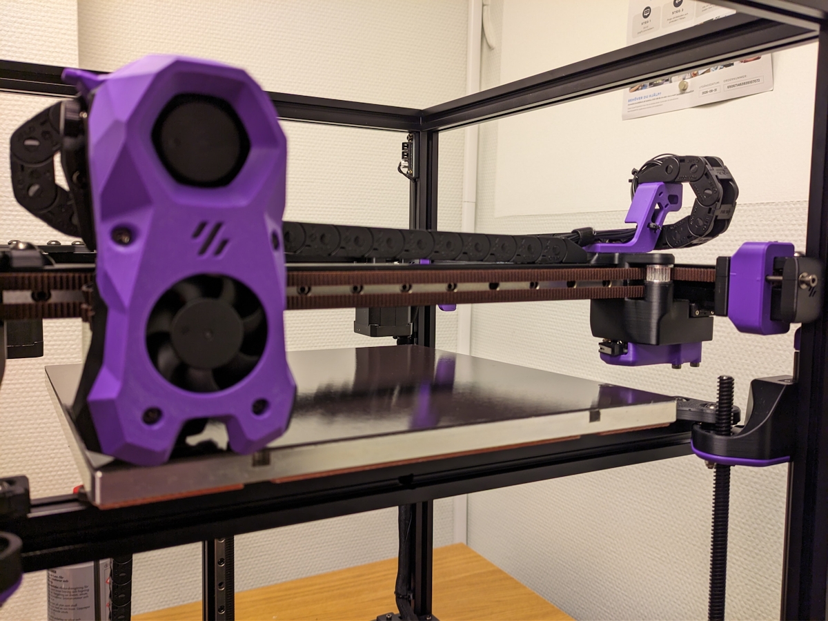

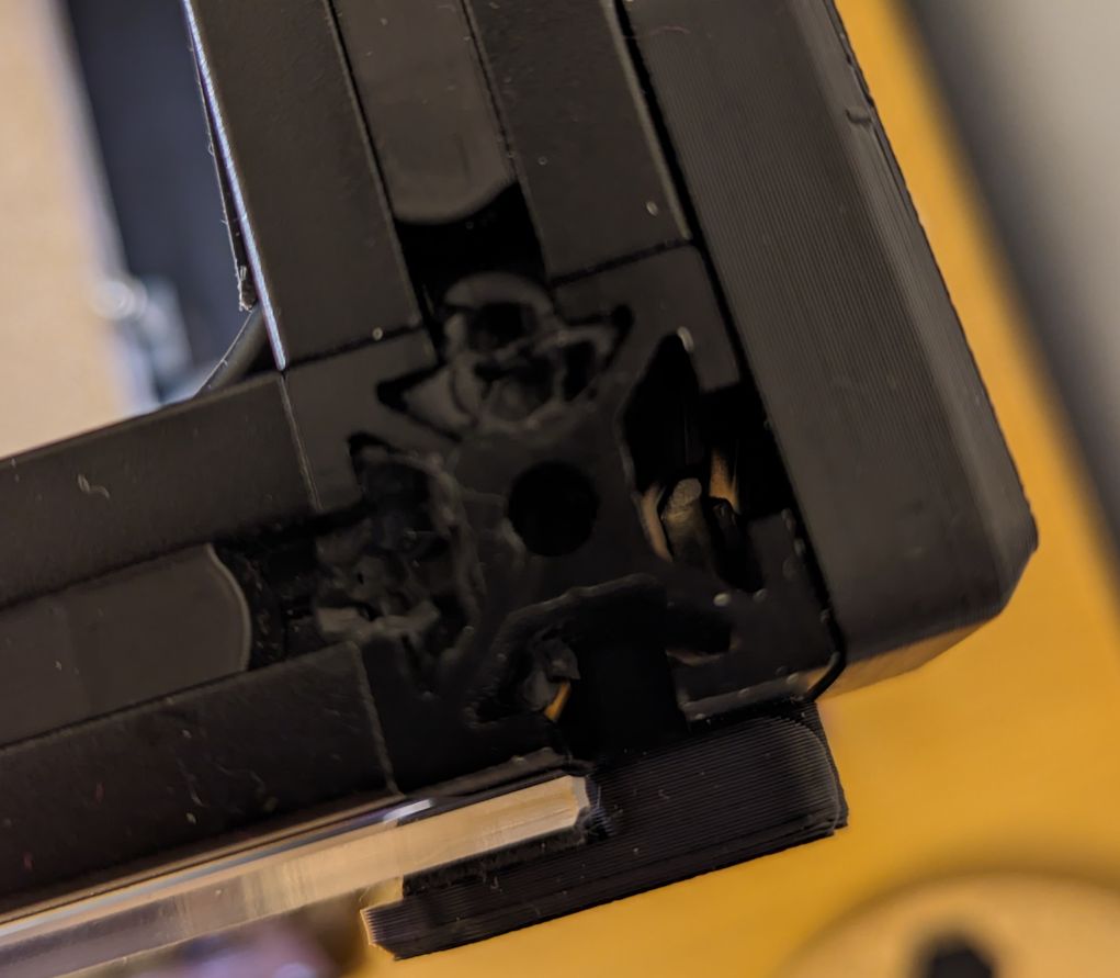

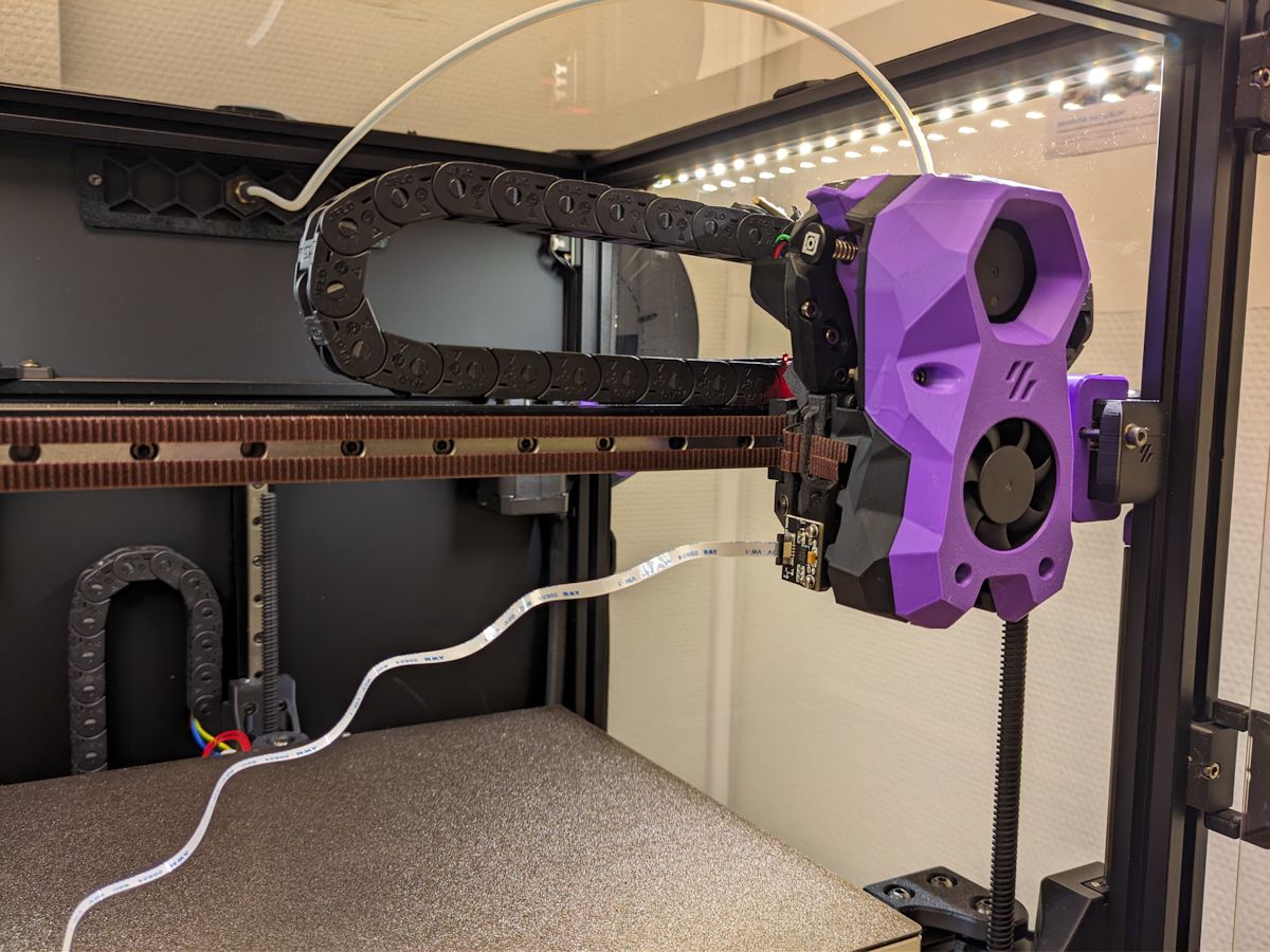

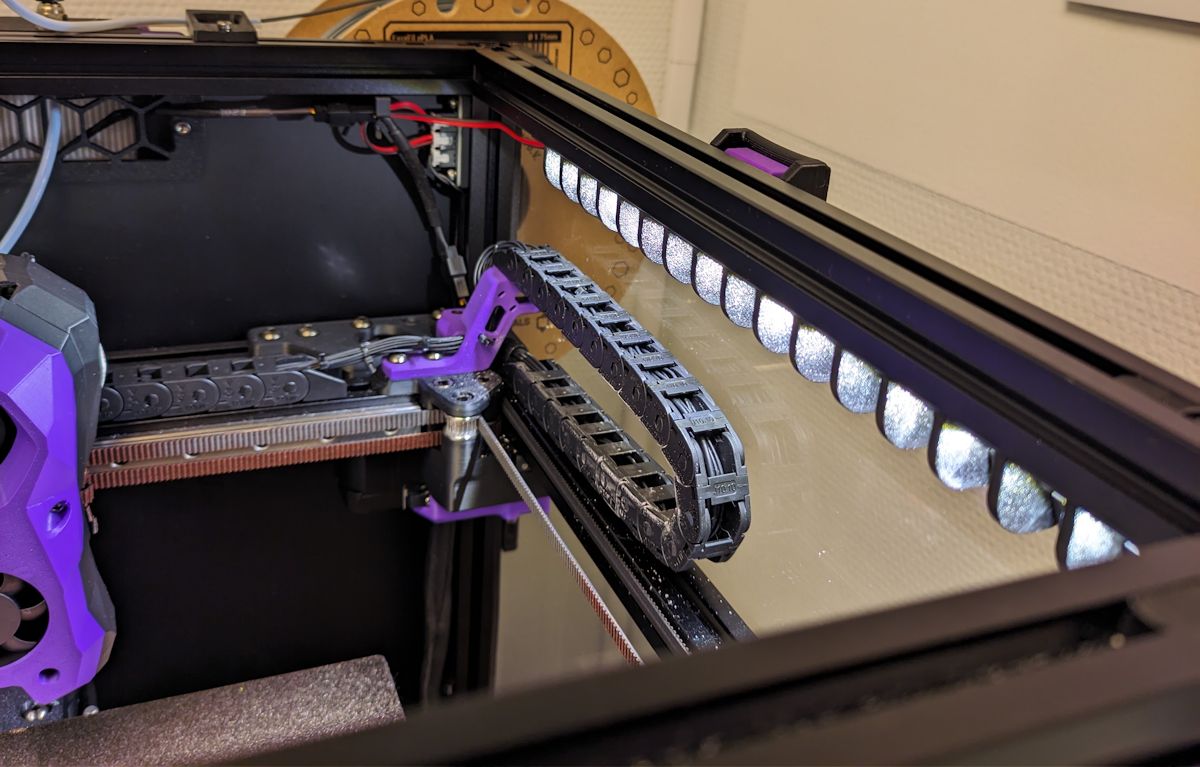

Lack of range for the toolhead
After installing the bed and racking the gantry, I noticed a big issue with the toolhead: it doesn’t reach the corners of the bed and the bed doesn’t reach up to the toolhead.
The toolhead is at max x, but it’s far from the edge.
The toolhead doesn’t reach the edge on the y-axis either.
I tried to raise the bed as high as possible, but it doesn’t come close to the toolhead, let alone raising it for tap to function.
Turns out I had made a mistake when installing the cable chains, as they’re all too short and they max out too soon, stopping the movement.
There were 4 extra links in the kit, but I didn’t know what to do with them so I forgot about them and took for granted that the three cable chains would work as-is. Maybe this is assumed knowledge, but when installing them—and before running the wires through—I should’ve checked the range of motion to be sure they were long enough.
Now I had to break open the chains and add the extra links afterwards. This was super annoying because I had to pull more wire to the chains, meaning I had to undo all the wiring work for all the motors and toolhead cables.
Opening up the xy cable chains.
I added two links to the z chain and one link each to the x and y chains.For x and y I also had to add some extra space by offsetting them so the chains aren’t flush to the edge of the extrusion holder or toolhead.
I had to add some extra spacing on the x and y chains to get the required range of motion. I wish I hadn’t clipped away the tab, so I could zip tie the cables to it.

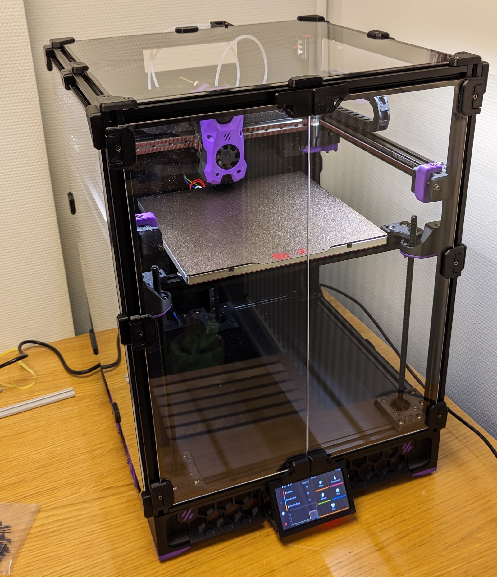

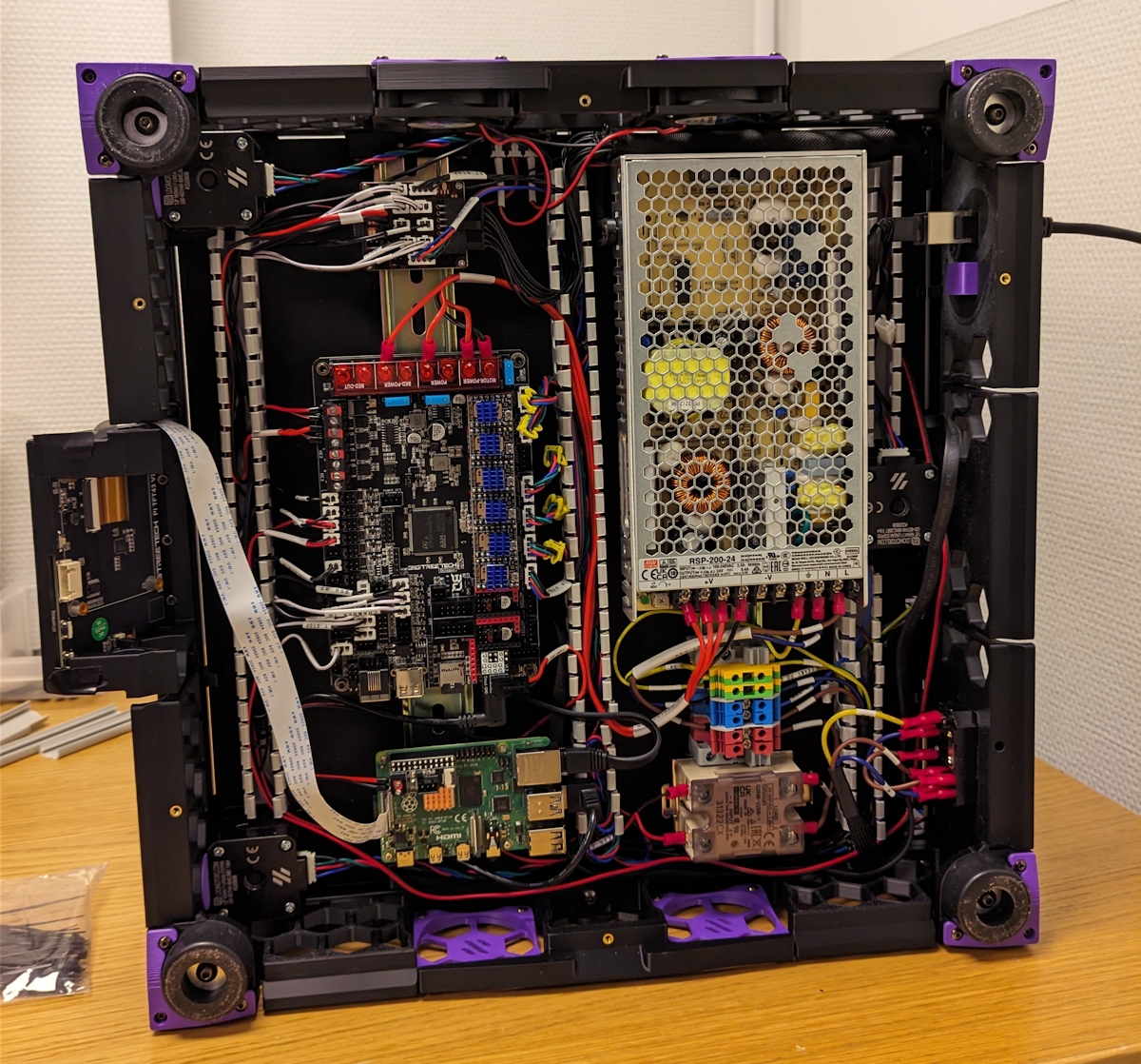

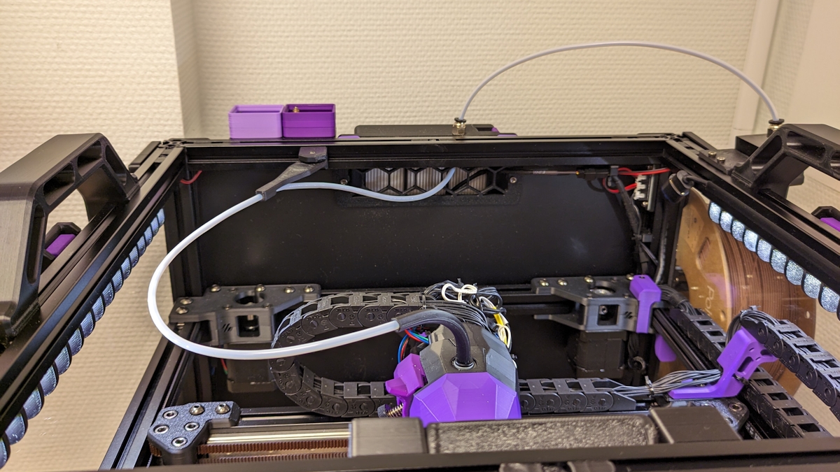

It’s all coming together
All the wiring is in place.

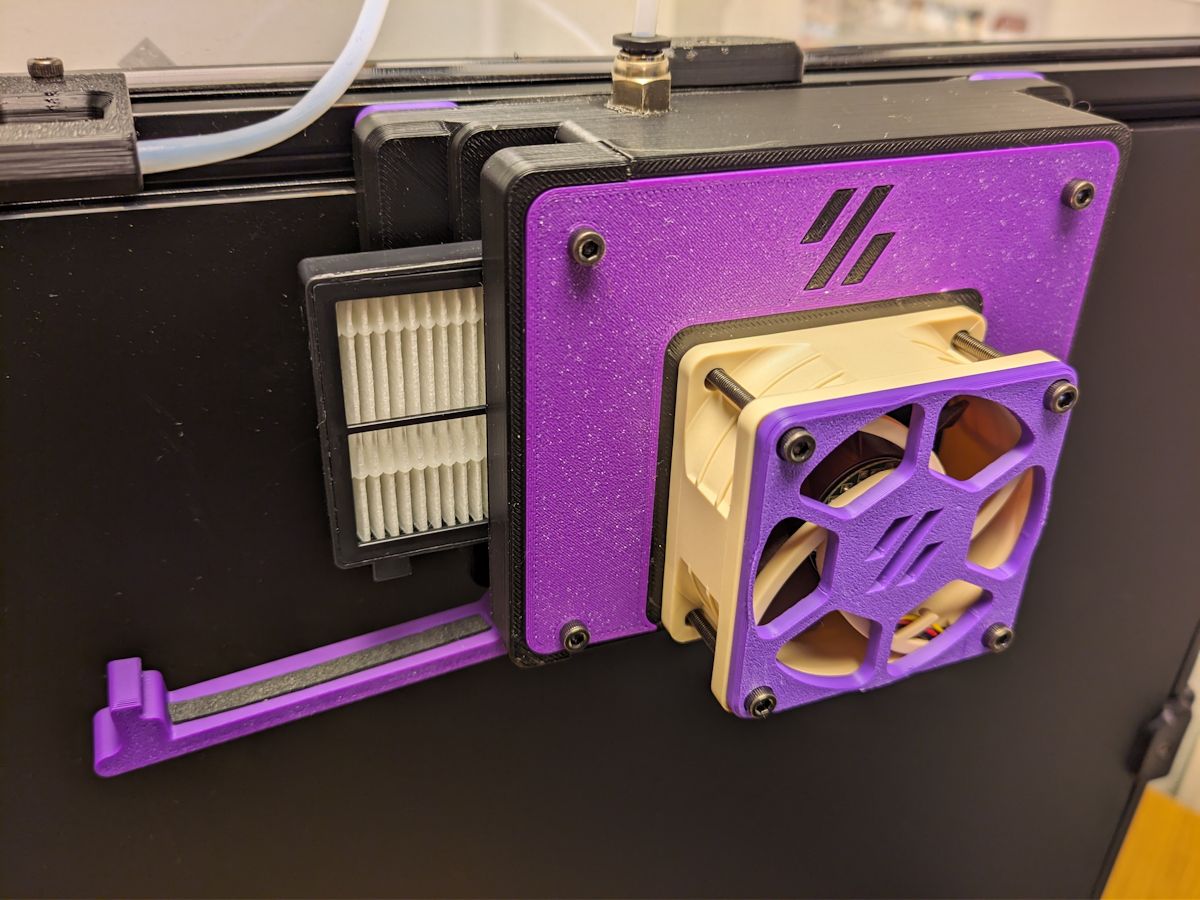

(You may notice an unconnected cable in the upper right, it’s for the Nevermore filter I haven’t built yet).
I may clean it up a bit after I’ve verified that things work.It may not be r/cableporn neat, but it could be worse.
A better overview of the wiring with skirts and all.

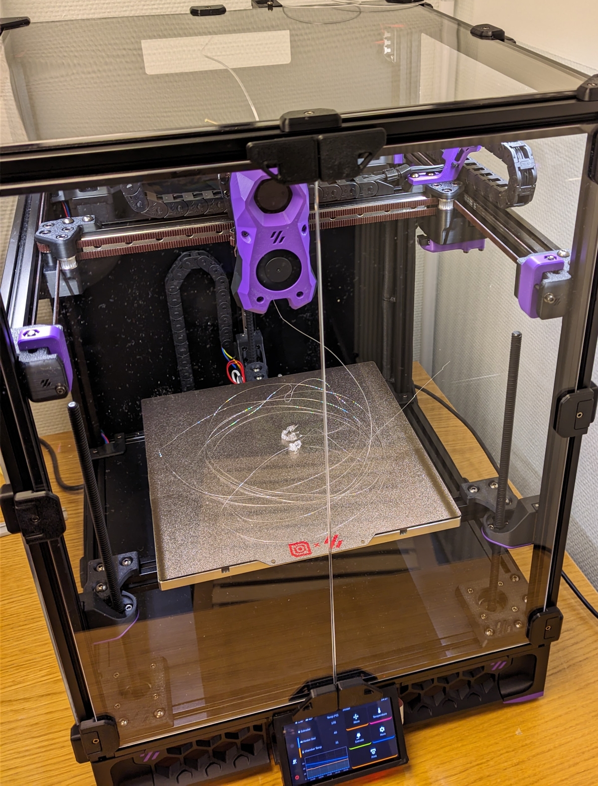

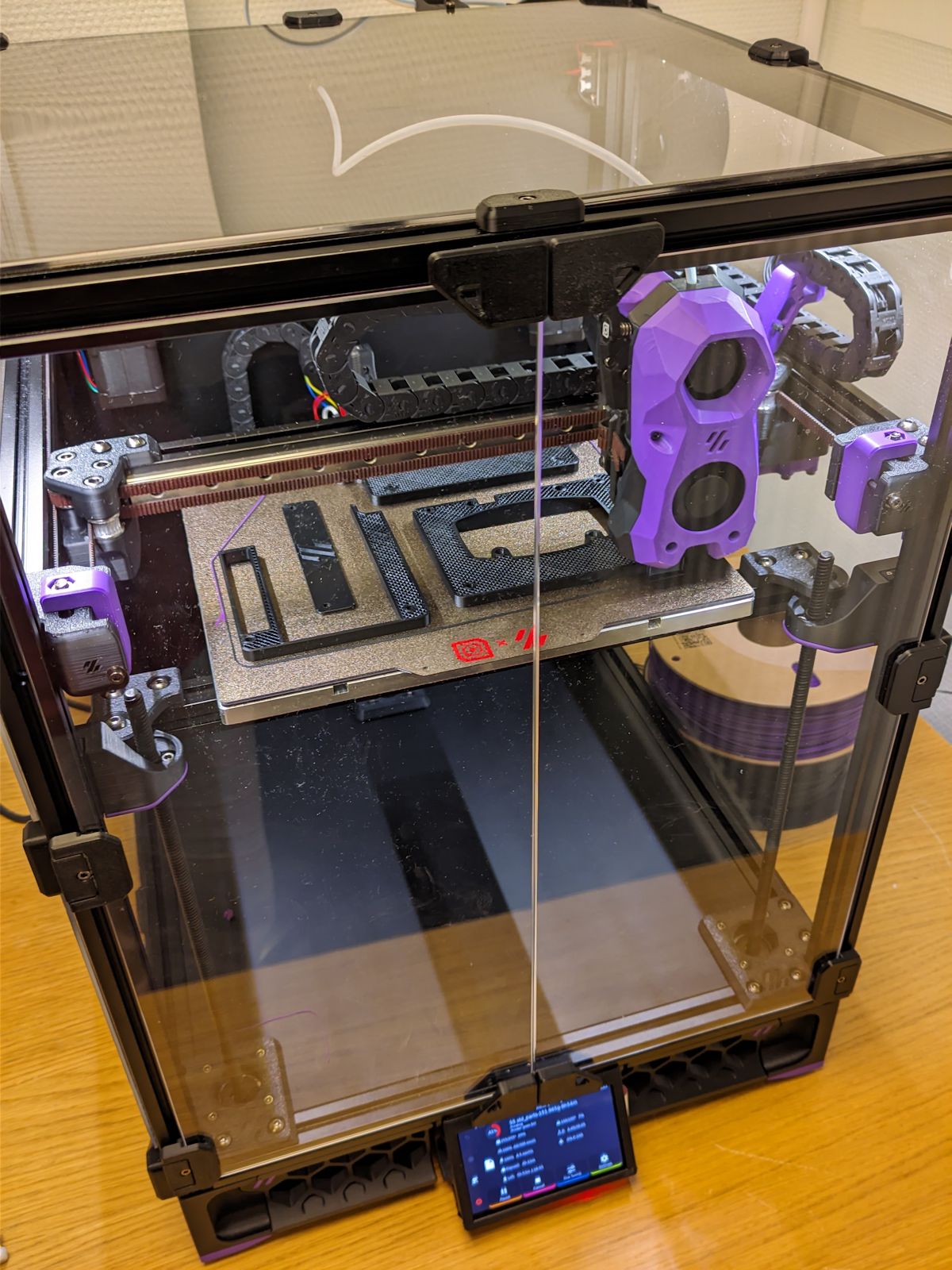

Let there be light
With everything prepared I closed my hands, curled my toes, and clenched my ass and turned on the power…
And the lights are glowing! Huzzah!
The lights are glowing, and there’s no smoke from the Octopus.
I disconnected the hotend and Raspberry as a safety measure before turning it on.
The Raspberry Pi also has some lights when turned on.
The status lights are promising, but I can’t tell for sure before flashing.

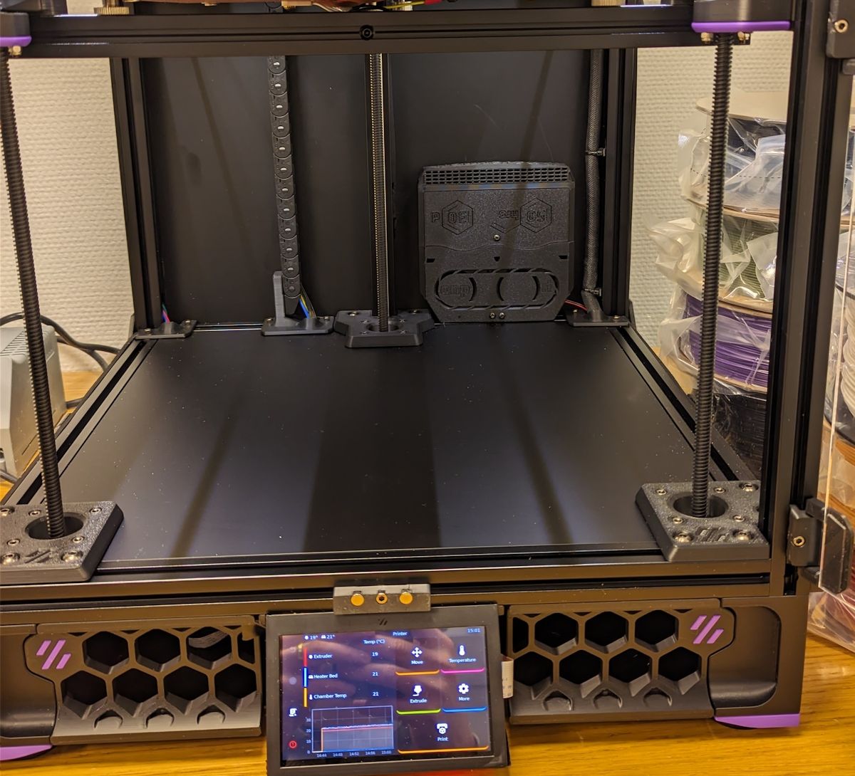

Part 5a
The build continues, now in a little more familiar territory.
Firmware flashing
To flash the firmware I had to order a microSD card reader.With that on hand the flashing wasn’t difficult. The VORON docs walks you through the installation very well.

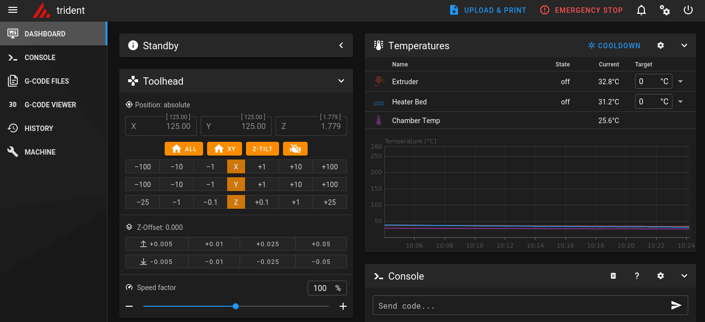

Mainsail
I chose to install Mainsail instead of Fluidd simply because I liked the screenshot a little more. From what I understand they’re very similar and the choice doesn’t really matter.I flashed it using pi-imager.
It was great to see the display turning on and being able to ssh to the Pi—such a relief!
The Raspberry Pi and the display are alive and kicking, although the display is rotated 180 degress.
After installing the Octopus firmware on it’s SD card and adding the device to ~/printer_data/config/printer.cfg I could start messing around with the Mainsail web interface.
[mcu]
# This is my serial, not yours
serial: /dev/serial/by-id/usb-Klipper_stm32f446xx_140045000F50535556323420-if00
The Mainsail web interface.

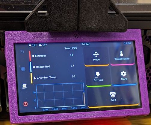

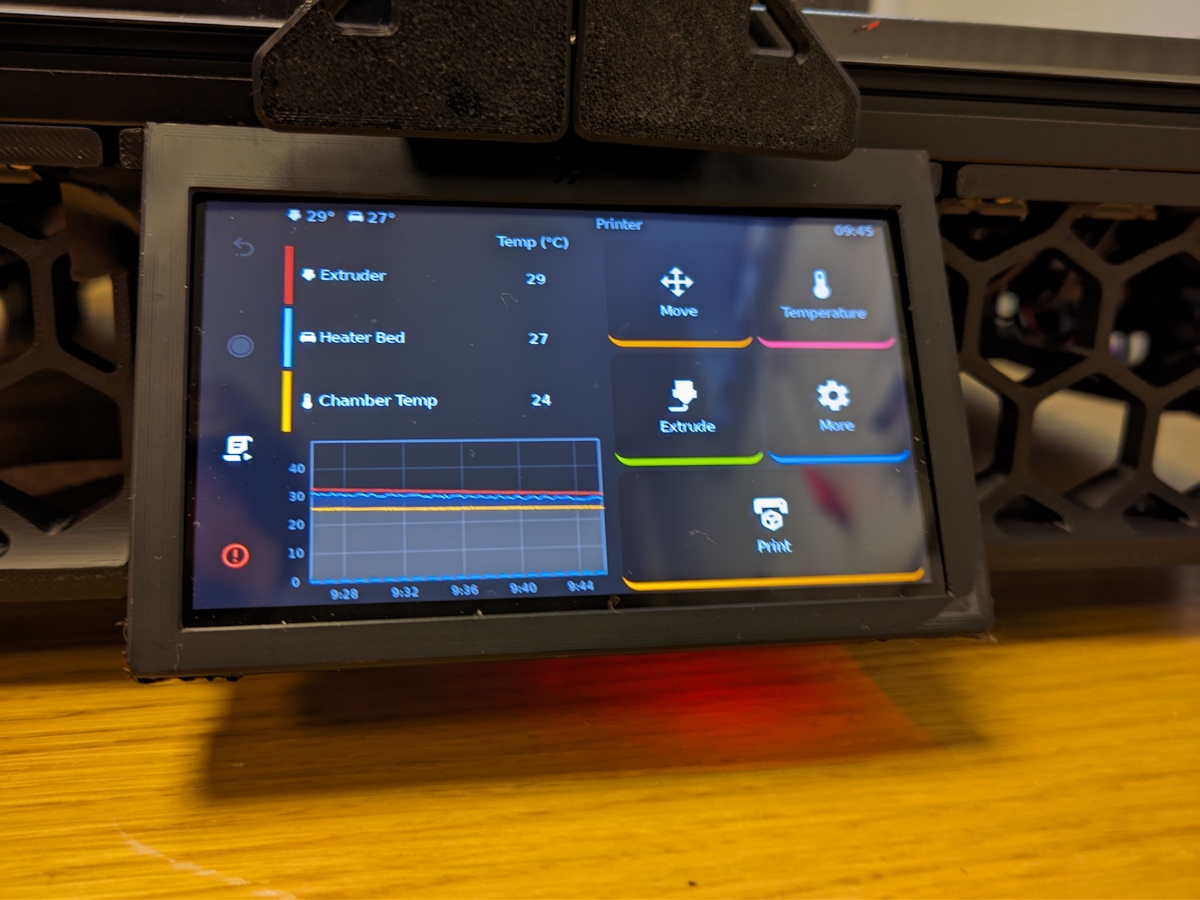

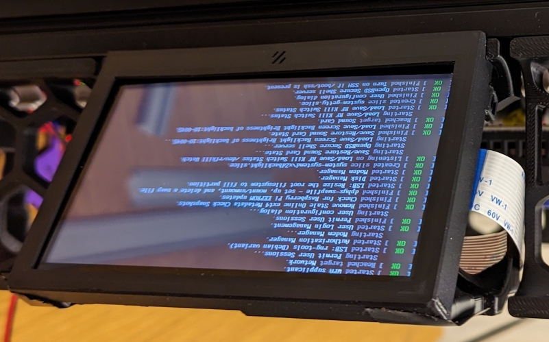

KlipperScreen
It’s good to see my old friend the Linux login prompt on the display, but that’s not really what we want here.Instead we should install KlipperScreen to be able to control the printer via a user-friendly UI. I installed it using a manual install, but in hindsight I maybe should’ve KIAUH. Oh well.
To rotate the screen you edit /boot/config.txt according to the LDO docs:
# Make sure this line is commented
#dtoverlay=vc4-fkms-v3d
# Add these 2 lines to the end
display_lcd_rotate=2
dtoverlay=rpi-ft5406,touchscreen-inverted-x=1,touchscreen-inverted-y=1
The display is rotated and uses KlipperScreen.

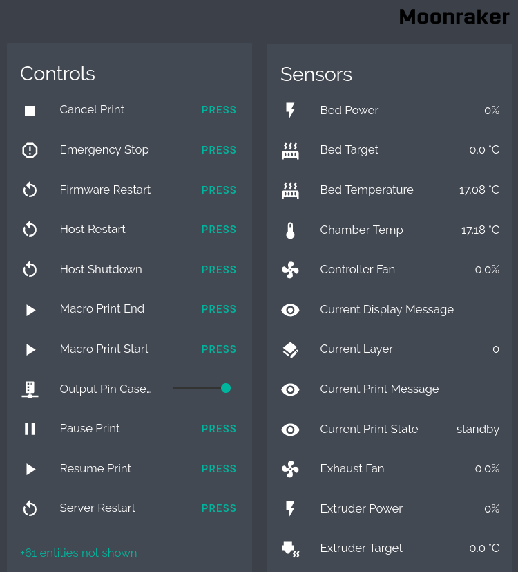

Home Assistant
Home Assistant integration with plenty of controls and sensors.
Of course, I had to hook up the printer to Home Assistant. This was easily done using the Moonraker Home Assistant plugin via HACS.
Maybe I’ll actually make a functional dashboard with it… Some day.

The bed—through the SSR—is connected to HE0, corresponding to the PA2 pin (BED_OUT is PA1):
[heater_bed]
# SSR Pin - HE0
heater_pin: PA2
Hotend
The hotend is connected to the non-standard HE1 (since my cable didn’t come with a fork spade to connect it to BED_OUT, as advised in the LDO wiring docs):
[extruder]
# Heater - HE1
heater_pin: PA3
sensor_type: PT1000
It also took a long time for me to figure out the correct sensor_type value.None of the values in the common thermistors documentation worked for the Phateus Rapido, but I found an off-hand comment somewhere that PT1000 was the correct type.

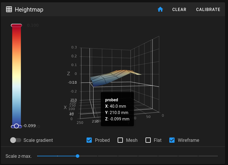

I’m a little confused what the negative numbers mean; is my z_offset too low, causing the probe values to be negative?Or are they uncorrelated and this is completely fine?
Extruder
It’s weird. In some cases you can move mountains and solve the most difficult problems in a flash, but at other times you’ll stumble on the smallest pebble.
And I stumbled hard on inserting filament into the extruder.
I know I checked it when assembling the Clockwork 2, but by god I couldn’t get it to grab on the filament. After a long time of fiddling, and considering if I should just disassemble it all, I somehow got it to work.
I think it was a combination of the extruder direction being inverted and some filament getting stuck, but I just don’t know. I’ll file it under user error and forget about it.
[extruder]
dir_pin: PF0 # Inverted by removing the `!`

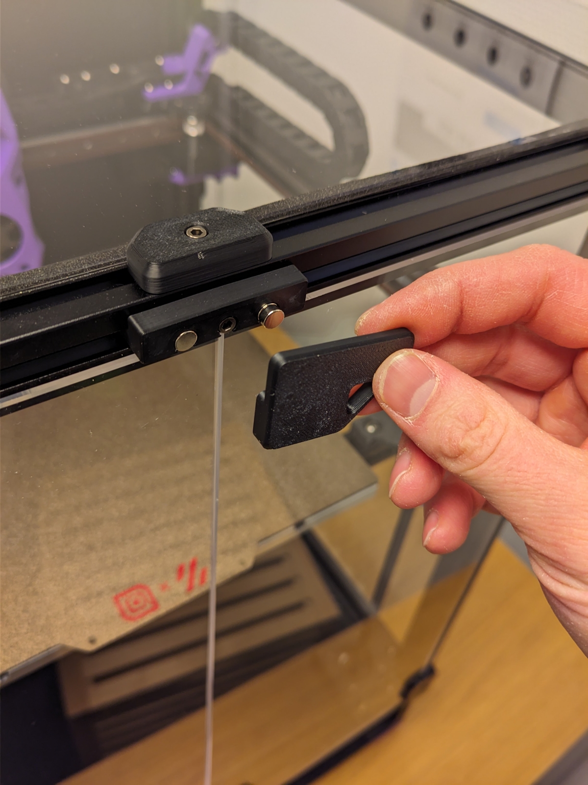

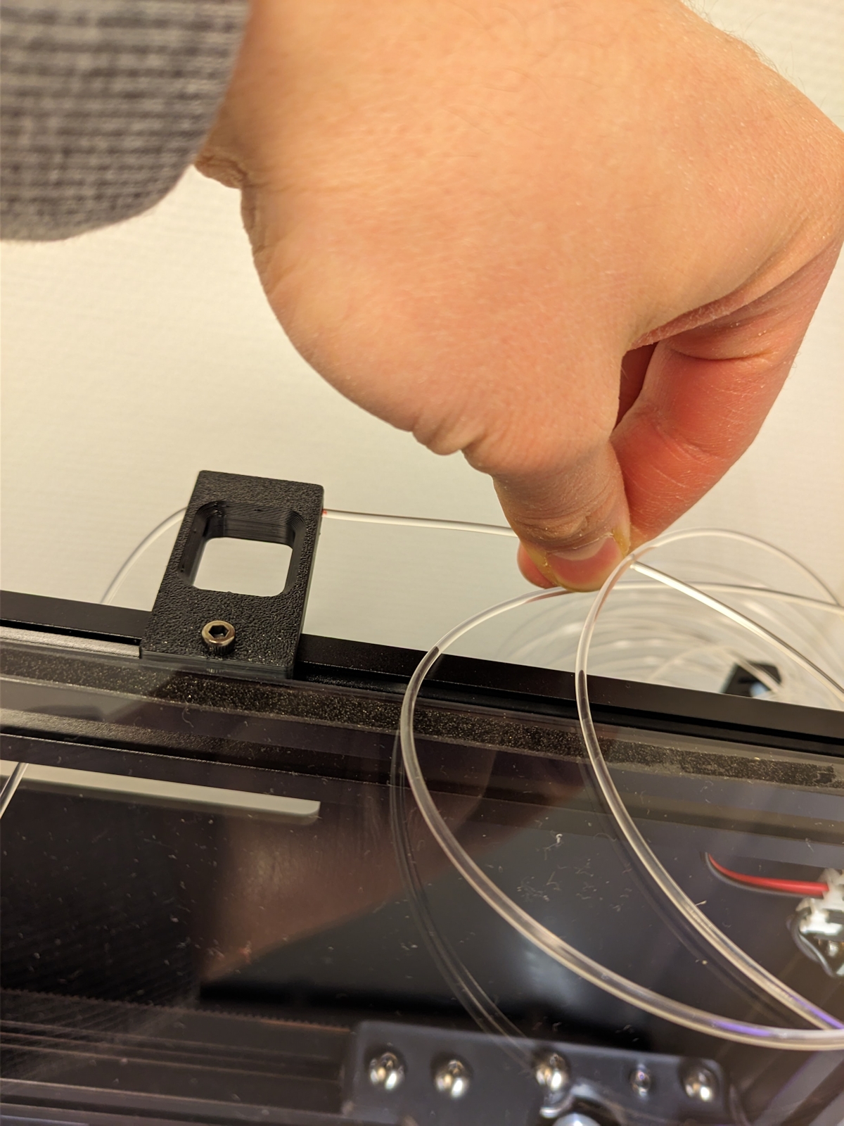

I don’t understand how you’re supposed to properly measure the amount of filament when calibratingthe extruder, the VORON docs isn’t particularly clear about it. What I did was to pull it taught and try to measure from there, but I fear it wasn’t that precise.
Maybe it would be easier without the top panel?
The small red mark was 100mm away from the edge of the black holder part before I tried to extrude 100mm of filament. I think this is good enough?
[extruder]
rotation_distance: 20.41105599   # After recalibration
I hope my first print will look better than this mess?

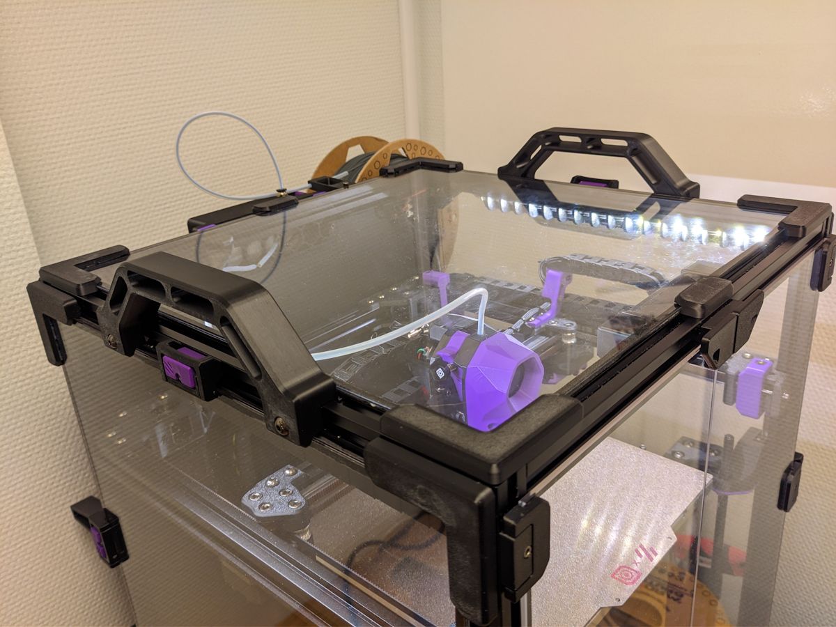

Part 5b
Panel mounting

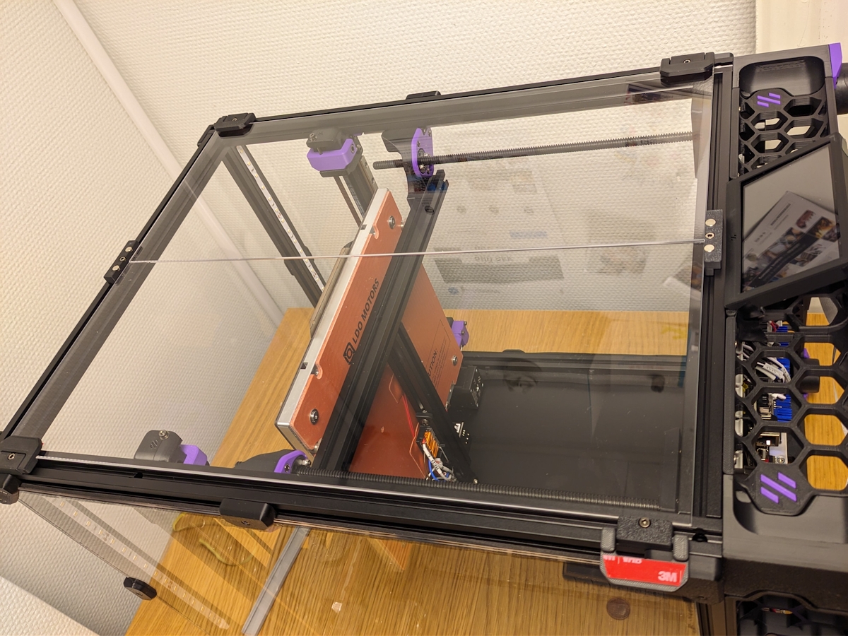

You may have noticed that the above pictures had panels on them. That’s right, to be able to heat soak the printer I had to have the panels, so I quickly installed them.
It was easier to align the doors with the printer lying down.
How are you supposed to get the right polarity and stick the part on the correct spot on the door? Just place the magnet and then push in the part.
I’ve been impressed with the build so far, but I’m not impressed with the doors. The doors doesn’t have foam tape between them and the frame unlike the rest of the panels.
I wonder why that is? I worry that they will scramble against the frame and it won’t make a good seal, which I think could’ve been avoided. I’ll probably look for mods for the doors; maybe I’ll replace the doors with a magnetically mounted panel or something.

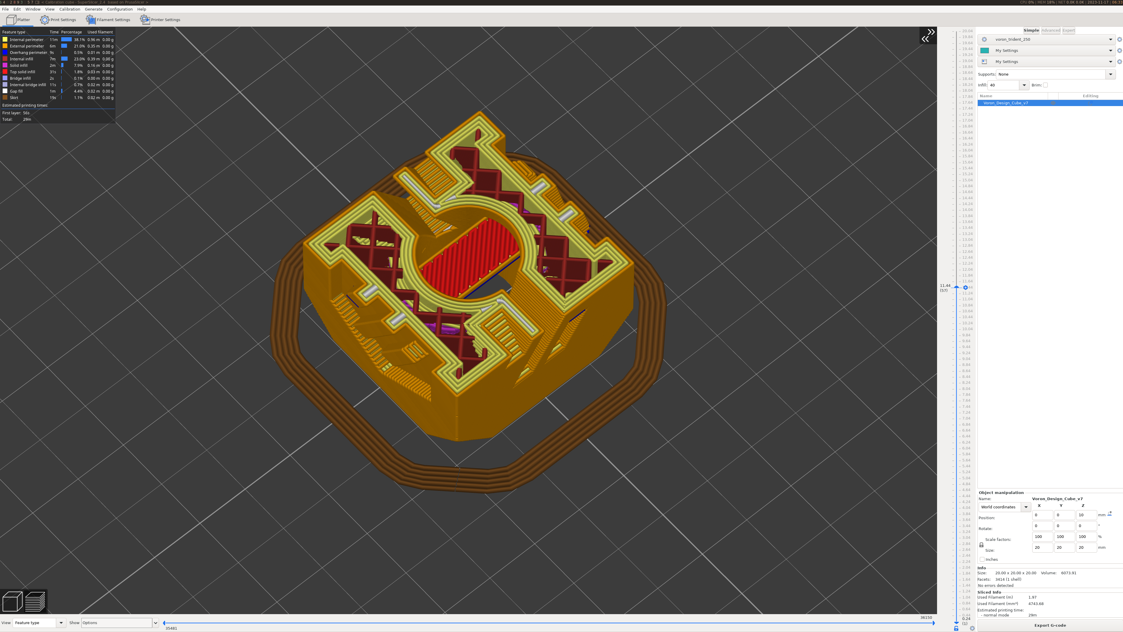

Slicer
I do feel my 3D printing inexperience when I have to setup yet another thing: a slicer. There are quite a few options, but I didn’t care to try out them all—I simply wanted to get up and running smoothly.
I picked SuperSlicer because it works on Linux, has a custom Voron Design profile to import, and seems fairly popular.
Viewing the layers is weirdly satisfying.
I was initially super confused on how to see the layer preview. Turns out there was some error with only using the preconfigured Voron v1 250 0.4mm config I selected in the configuration wizard.Importing the Voron Design profile and selecting it seems to have resolved the issue.

Its looking good!
I found it much easier to calibrate the extruder without the Reverse Bowden tube installed. The Ellis tuning guide has some great pictures and suggests using tape rather than a sharpie marker. I found it much more precise. I have a 150 mm scale from Lee Valley that works absolutely spectacular for this. It has a ridge that makes it easy to get the filament straight and set the tape at exactly 120mm to start.
Looks great! You are basically off and running now. I agree the doors aren't spectacular, but they work fine as they are. My chamber gets plenty hot even with them basically stock.
Don't worry about the actual offset number. What you have is well within normal. As long as it's zeroing correctly you are fine.
For calibrating the extruder, I always measured from the top of the Stealthburner body. But again, as long as you've gotten it close to extruding 100mm when you tell it to all is well.
Next step is to go through the Ellis guide for your pressure advance and extrusion modifier. There's a ton of good information in there, so spend a while reading.

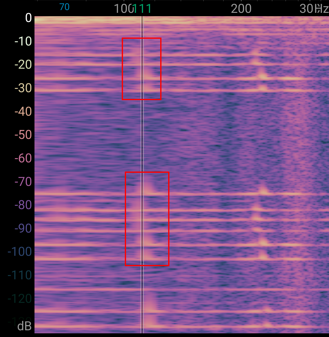

I always wondered how tight the belts were supposed to be.Tuning it by measuring the frequency using an app was pretty nifty, and it was quite painless.
It’s around 110Hz, I think?
I tried to tune it to 110Hz, but I’ve seen people aiming for 120Hz.

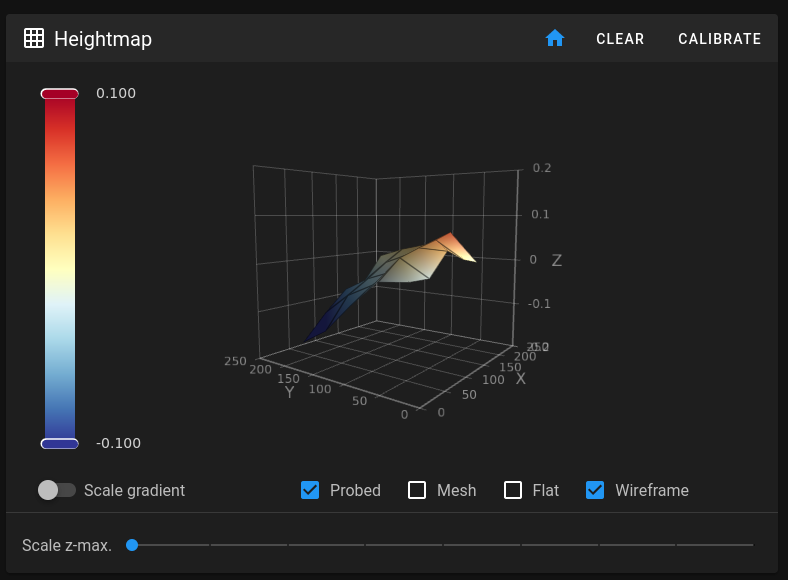

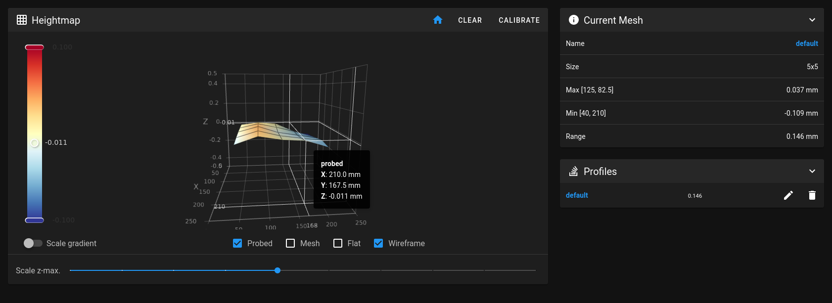

Bed mesh
To setup a bed mesh you just add something like this to Klipper:
[bed_mesh]
speed: 300
mesh_min: 40, 40
mesh_max: 210, 210
fade_start: 0.6
fade_end: 10.0
probe_count: 5,5
algorithm: bicubic
And then BED_MESH_CALIBRATE will do it’s job:
The bed mesh is situated around 0, nothing unexpected here.

First print
The VORON docs makes the first print seem so simple—just upload the print and eat a bowl of cereal.And I was looking forward to just hitting print and watching it go brr…But of course things wouldn’t go so smoothly.
Problems I’ve had include but isn’t limited to:
  1. Print stopped with Hotend not enough
    This happens because the Tap G-code reduces the hotend temperature to 150° when probing to not damage the bed, but then the temperature is too low for printing.
    To fix it I had to manually set bed and hotend temperatures after Tap and modifying SuperSlicer to provide these values to the PRINT_START macro as detailed in a better PRINT_START macro.
  2. Filament didn’t load.
    And KlipperScreen complains about FILAMENT_LOAD not existing. Sigh.

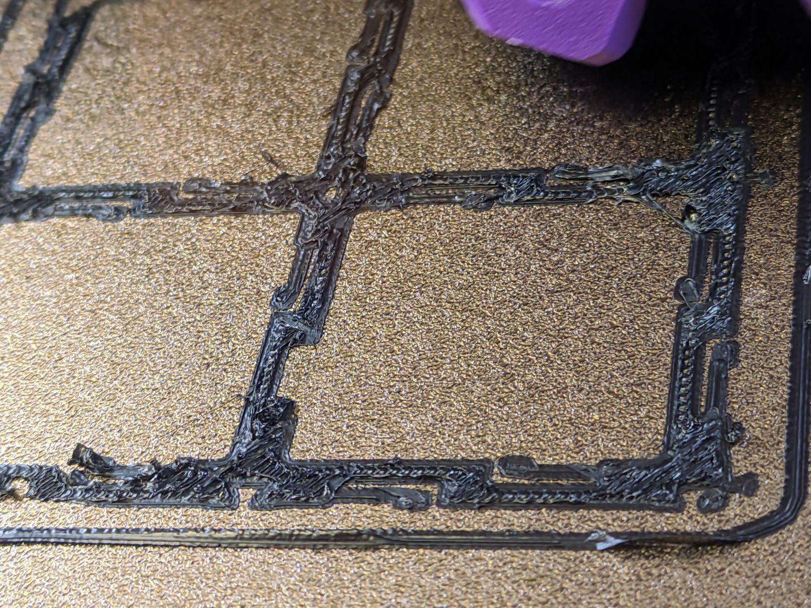

  3. First layer not sticking to the bed.
    A combination of using the wrong temperature and z_offset was to blame.

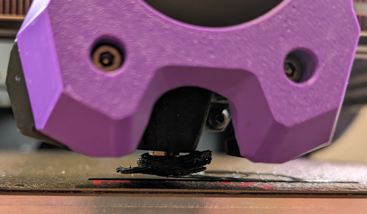

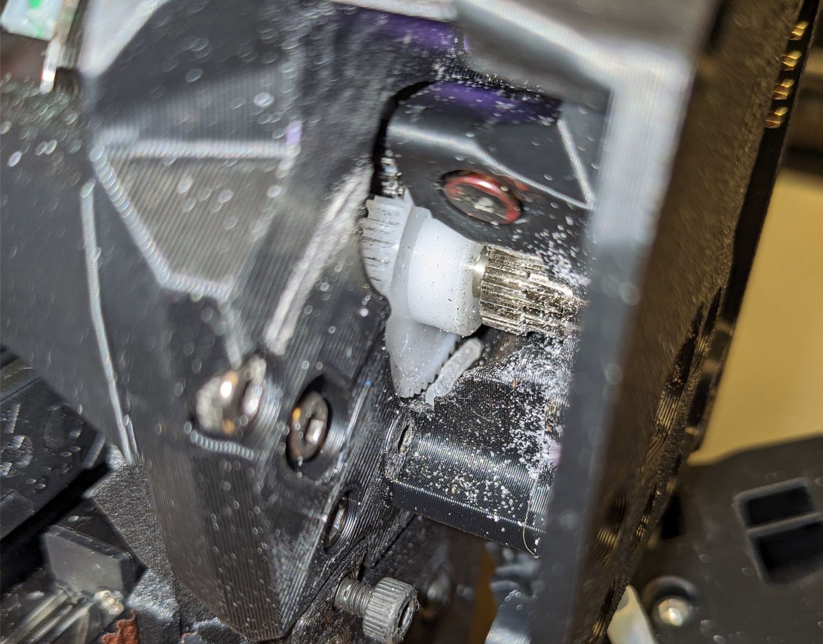

  4. After a few failed attempts, the filament clogs.
    The filament clogged somehow, and I had to disassemble the toolhead to fix it.
  5. Bunch of “Unknown command” errors in the mainsail log.
    I assume it’s because Klipper wasn’t selected in the “G-code flavor” in SuperSlicer.
  6. The print coming loose from the bed after a while.
    Oh FFS.
    I struggled with this a fair bit. I reconfigured z_offset which seemed to work, but maybe it’s extruding too much filament causing the toolhead to hit the print?
After all that trouble I was running into I was expecting for getting an absolutely shit print… But it’s actually not that terrible?
It’s far from perfect, but the lighting is fairly harsh and it looks better in real-life. My friends have shown many 3D prints that look a lot worse.

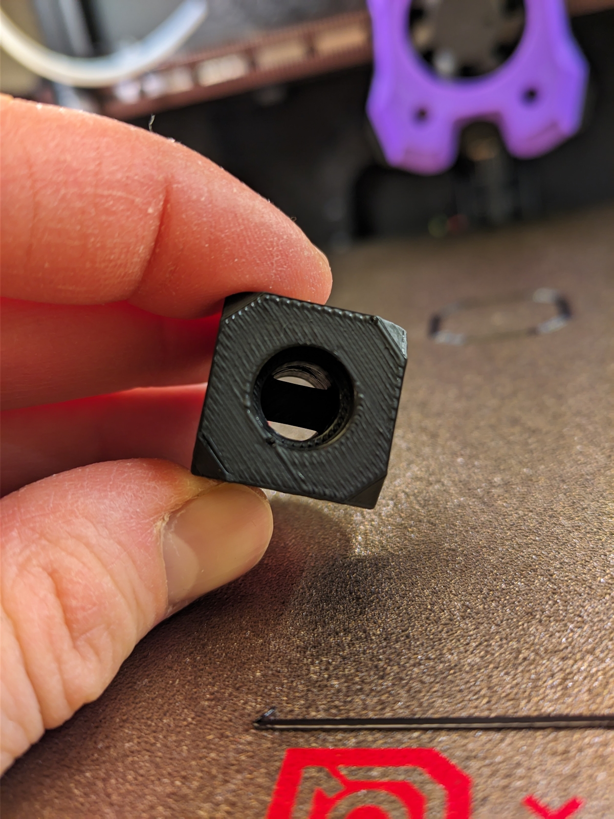

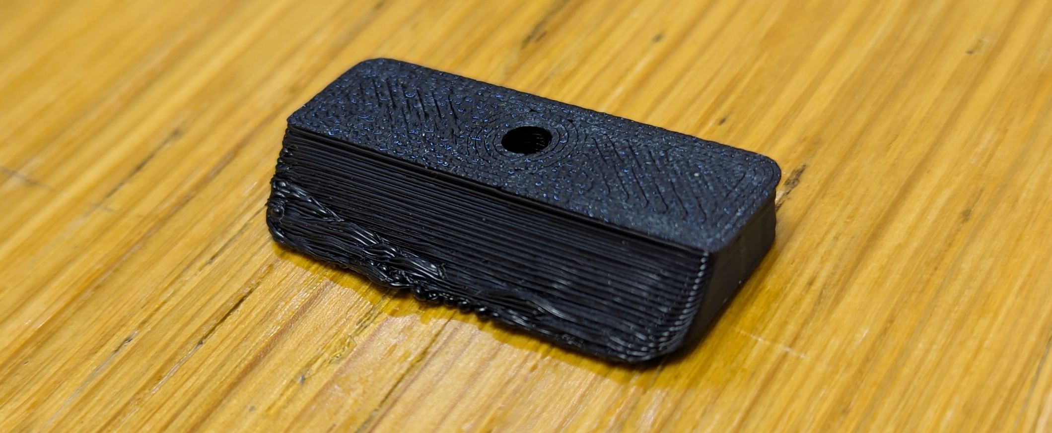

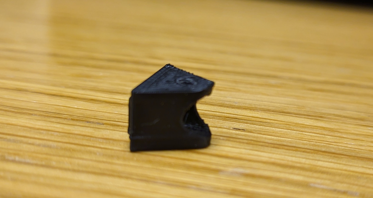

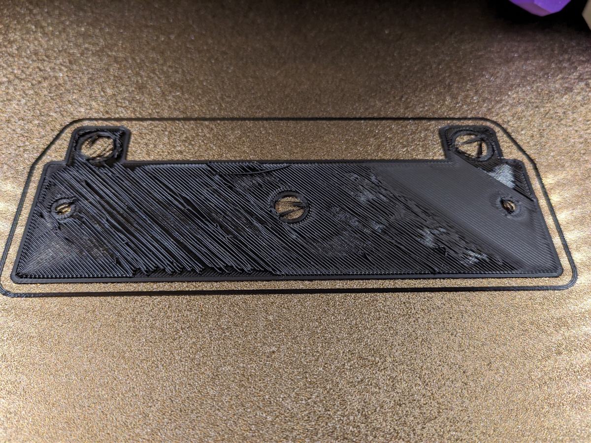

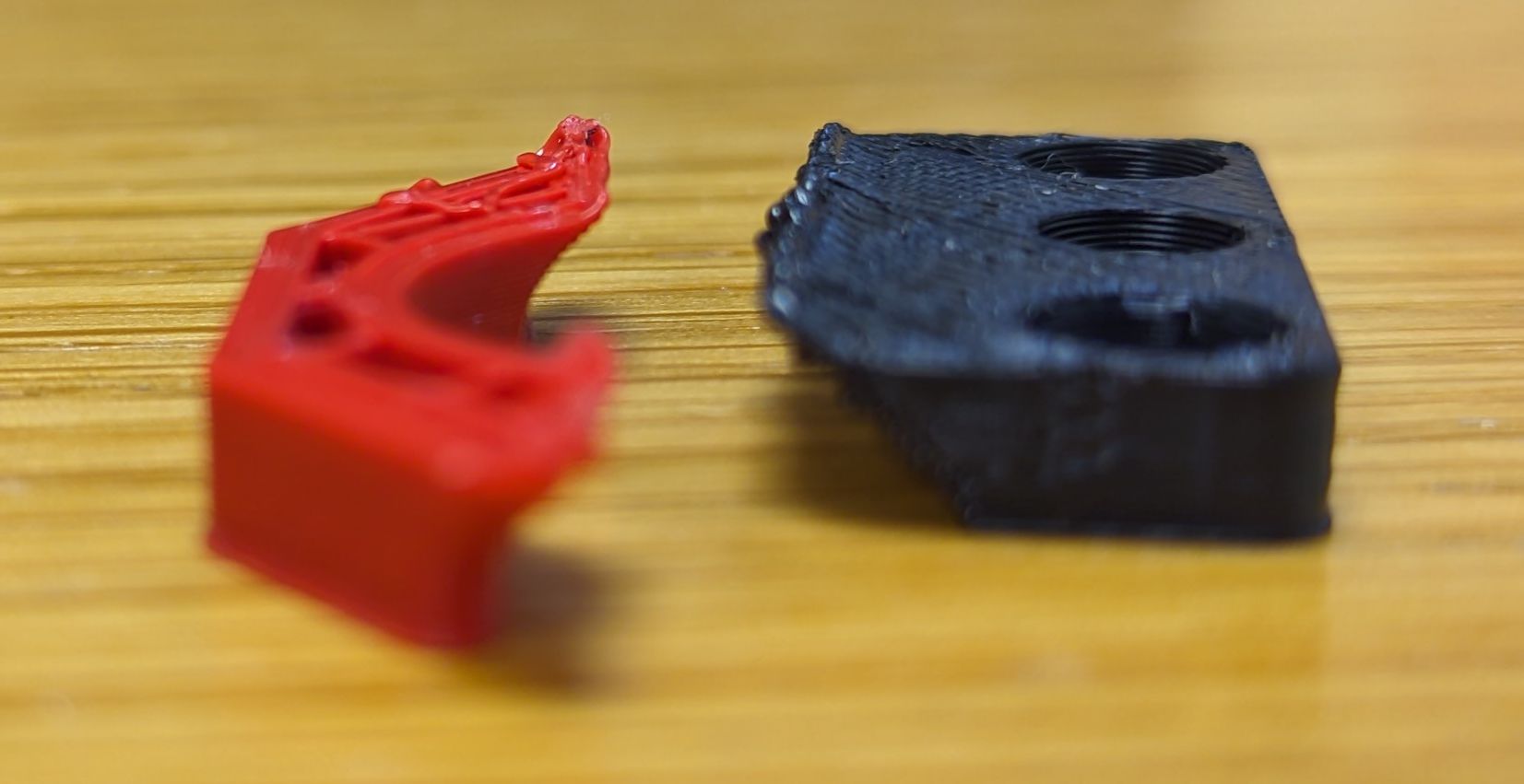

A part needed to mount the Nevermore filter to the extrusion .It’s hard to see in this image, but the top edge is drifting upwards quite a bit.
Simpler models seem to print well, but it struggles with more complex geometry.While I can probably use this Nevermore mount with some sanding, this level of quality isn’t high enough to for example print parts for a VORON.
More tuning is needed.

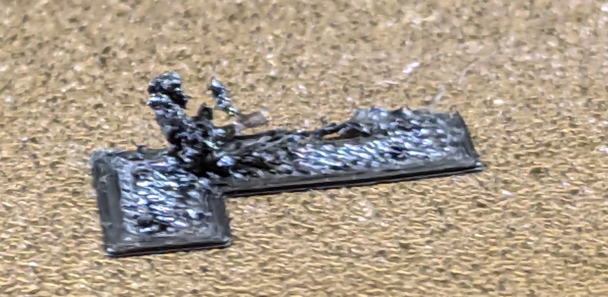

    I wasn’t really sure how to do this, but I think the point is to print one square using one z-offset and then change it a little for the next square to see which produces the best print. In SuperSlicer I had to enable the “Complete individual objects” setting for it to print one square at a time.
    My previous z-offset using the paper was pretty damn good, but I ended up accepting a -0.01 extra offset (increasing it to -1.050).

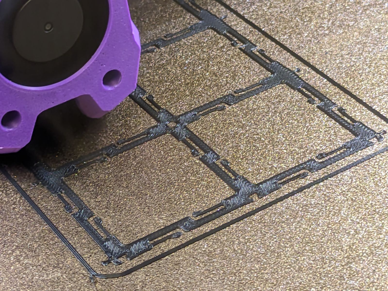

    I used the pattern method, although there were so many settings I was unsure about so I don’t know how well it worked out.
    Still, I got a value of 0.04 and for some reason I didn’t have any pressure advance setting previously.

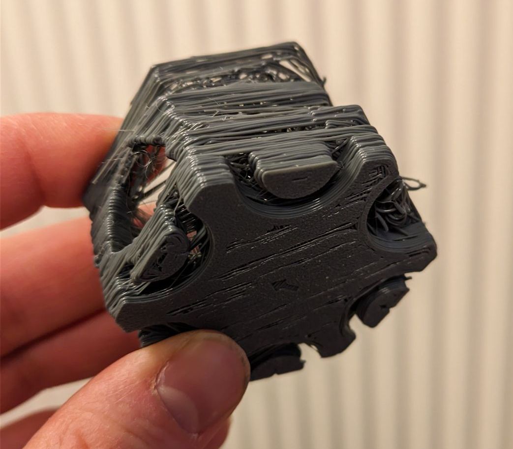

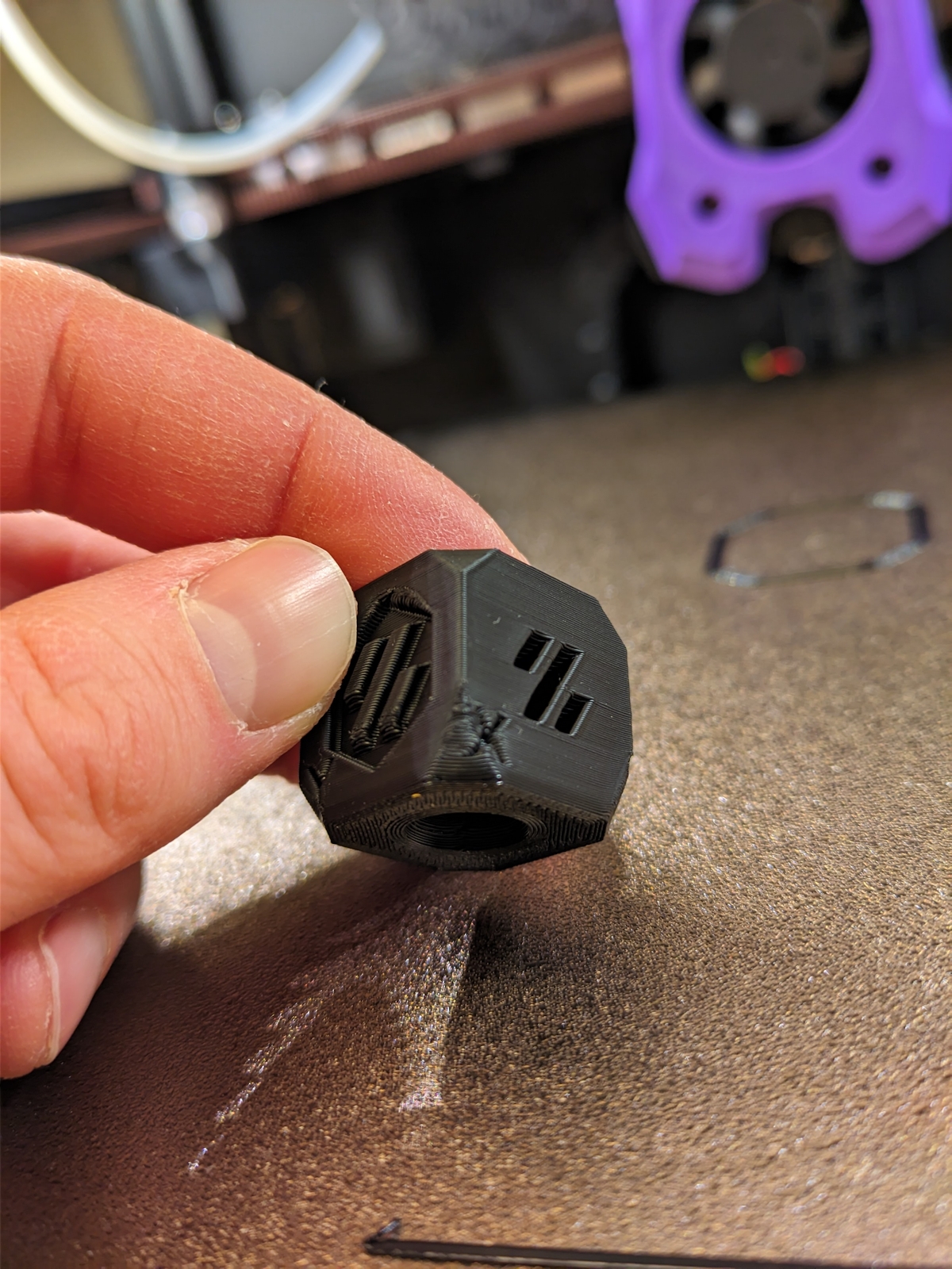

I printed out another calibration cube and I hoped to have some good comparison pictures here,but truthfully the difference was really small.There were some slight improvements, but not something that shows up well in pictures.
So here are some other parts I’ve printed:
Printer goes brr.
Some of the parts for a HEPA filter housing. If you zoom in you can see some stringing and very visible lines.
The print lines are quite visible.
Despite some artifacts I’m happy with these results,especially since these were new spools of filament that I didn’t do any tuning or drying for (I don’t have a filament dryer yet).The prints were absolutely good enough for me to start printing a bunch of mods for the printer.
Looks like PA could use a bit more tuning, but overall the parts look good. Your bed mesh also looks like the right rear Y extrusion is a touch high.

This is mostly covered by the kit, but I was missing some parts from the print it forward and the kit didn’t include a HEPA filter. Because the printer is in the office and health is super important fixing this was needed so I could start printing some ABS and continue modding the printer.
Exhaust cover
I’m missing the exhaust cover where the filter goes in a stock VORON.
The standard VORON comes with a filter in the back, but the LDO kit doesn’t include the fan for the filter and instead uses an exhaust cover to close the hole.
I didn’t receive this part, so the first thing I did was to print that part.This was just a very temporary measure so I printed it in PLA.

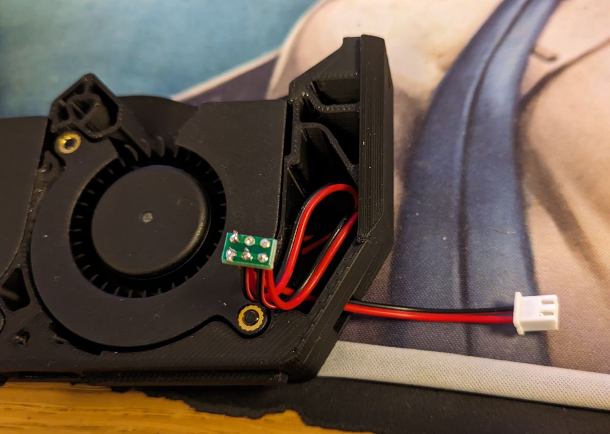

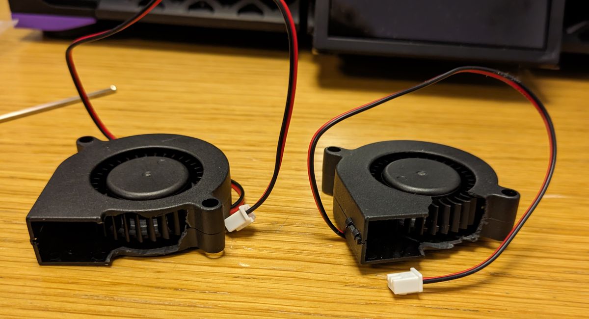

Cutting away parts from the fans was horrible. They broke very easily.
I finally got to exercise my (very poor) soldering skills! It was cute how LDO included a small board so that you don’t have to crimp any cables.
HEPA exhaust filter
A new HEPA filter. I wasn’t able to color match with the print-it-forward parts…
While I have the Nevermore filter, it doesn’t filter Ultra-Fine Particulates. For that you need a HEPA filter.
There were a few solutions with combined carbon and HEPA filter, but since I already have the Nevermore I wanted a standalone HEPA filter. I found the Voron HEPA Exhaust Filter that replaces the stock filter that seemed like a good option.
With the Nevermore in place I could print the parts using ABS, and they turned out pretty well.
For silence I used a Noctua FN-A6x25 fan. In hindsight I maybe should’ve used the PWM variant, if only to make the wiring simpler. Now I have this ugly looking wiring in the top corner (it uses the Noctua low-noise adapter).
I also had to create another cable, which wasn’t too difficult:
  1. Converted the 3-pin cable to a 2-pin JST connector and extended it.
    I simply ignored the yellow RPM speed signal cable.
  2. Connect to a free fan output on the Octopus.
  3. Used the 12V selection jumper for the fan output.

Bed mesh offset in one corner
It got pointed out to me in the VORON forum that I my right rear Y extrusion was a bit high.The Trident has automatic bed leveling, but because the bed is only attached in three positions it can’t compensate for a difference in the rear that only has a single mount in the middle. If you’re unlucky this might cause issues with bed adhesion.
Turns out I’ve had some problems with bed adhesion. Not a lot mind you, but enough to bother me on some trickier prints.I’ve seen the offset on the corner go down to -0.26, which is more than the standard 0.2 layer height I use, so this might be the cause of some of the issues I’ve seen.
Before adjusting the right Y extrusion.
In the voron_1_trident_questions channel on the VORONDesign Discord there was a pinned message on how to adjust this.I ended up adjusting the front right Y extrusion upwards quite a bit to compensate for this.
After adjusting the front right Y extrusion upwards.
The mesh still isn’t perfect (and it can sometimes look worse than the adjusted picture above), but it’s now a lot better and importantly the rear corners are much more level.
Bulging corners
One significant print issue I’ve had is bulging in the corners on overhangs:
Both edges round upwards and apart from being really ugly, they’ve caused a number of prints to fail when the nozzle has knocked loose pieces from the bed or has caused belts to skip.
It’s really ugly.
Maybe it was overheating? But it happened consistently, with long layer times, with max fans, and for PLA/ABS/ASA.Another idea was over extrusion, but I think that should’ve shown up in other places?
Then I found the Bulging section in Ellis’ Print Tuning Guide that made the issue disappear.These were the changes I made:
  • Enable external perimiter first
  • Set overhang threshold for bridge flow to 0
  • I also experimented with disabling overhangs specific settings completely (set bridge speed and fan to 0 or the disable checkbox), but I’m uncertain how effectual that was compared to the other two settings.
Some of these were specific to SuperSlicer, the slicer I use.
These are two prints that show the difference between the settings. The green is without the changes and white is with the changes.Apart from the overhangs, the green printout looks pretty good, but the overhangs look terrible. The white still has some defects, but it’s so much smoother.
Extruder skipping
I had printed for around 400 hours when the extruder suddenly started skipping.At first it was just minor artifacts, but after a while prints started failing in major ways or refusing to extrude anything at all:
My first idea was that I had messed up the tension in the extruder, so it no longer got a good grip on the filament. (I had some major issues with loading filament at one time, and I started screwing around with everything I could think of.)
But alas I couldn’t solve it with a quick-fix, so I had to open up the toolhead. Which I should have done much sooner, because there were a bunch of broken filament stuck in the gears:
One piece of broken filament inside the CW2, together with a bunch of dirt.
I really didn’t want to disassemble it because I was afraid of the effort to do so, but in the end it was just a few screws and the whole cleaning process took 10 min. Building your own printer has some benefits, I should have more faith in the process.
2mm PTFE between extruder and hotend
There were a lot of leftovers after the build; nuts, screws, belts, etc. But also an unused bag with “Teflon Tubing, 4x2mm”, which surely shouldn’t be completely unused?
Turns out you’re supposed to use a tube with an inner diameter of 2mm between the extruder and hotend, but I had used the regular PTFE tube that had an inner diameter of 3mm. This isn’t ideal and requires more retraction (which I didn’t compensate for), and it can cause stringing issues (which I had).
Note to self: Don’t use a tube with an inner diameter of 2mm between the extruder and spool, the filament will get stuck due to friction.
First layer woes
For a long time I was really happy with how my first layers looked and I could start a print and it would finish without issue most of the time.
But sometimes I had these “blobs” that started collecting:
This is some extra filament that has been pushed around and gotten stuck on the print.
I couldn’t figure out where it was coming from. Overextrusion maybe, but i didn’t find any issues with it and this only happened in the beginning of the print.
And later on I started to get severe issues with bed adhesion where I felt lucky if a part stuck around long enough for the print to finish.The first layer started to look garbage as well:
The worst part is, I didn’t think I had changed anything.
In hindsight me fixing the bed mesh offset might have been the cause my sudden problems.
I tried a bunch of things; changing nozzle, recalibrating PA and EM, changing filament, and even replacing the extruder (more on that in a future post) yet the issue remained.
What finally fixed it was recalibrating the z offset and tuning first layer squish once more. I’m not sure why I had to do this again (doesn’t Tap magically solve everything?), but now the first layer is pretty and the bed adhesion problems are almost completely gone. (Some prints have a tendency to warp a little, but I guess it’s hard to get things perfect.)
Much better first layer!

These are some smaller mods from the LDO kit I hadn’t gotten around to installing, and some other small mods that fixed some annoyances I’ve had.
Handles
The kit includes some very nice handles you can install. But unfortunately they cover up the top panel so you have to remove the handles before you can remove the panel—a gigantic pain.
So I ended up printing some sturdy handles instead. They’re really large comparatively, but they get the job done.I haven’t had that much use for them yet, but I felt obliged installing them since some kind of handles came with the kit.
LED mounts
There were no instructions on how to install the LEDs, so I taped them on top of the included extrusions covers. Turns out you were supposed to print a bunch of LED mounts to get the LEDs pointing inwards towards the print for better lighting:
Before the LED strips were mounted flat.
Now they’re tilted inwards and have shields to direct the light towards the build plate.

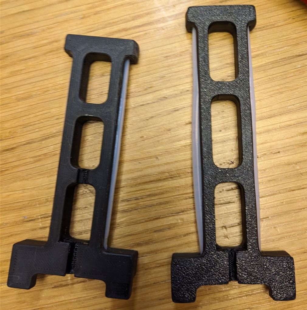

Longer spool holder
The stock spool holder to the left, a longer one I printed to the right.
I ran into the surprising issue that some spools were too wide for the stock spool holder (3DJake’s filament for example).So I replaced it with a longer one.
In the future I should probably replace it with a top mounted spool holder, but I got lazy when I saw I didn’t have the required M5 hardware. Maybe another day.
Bowden tube routing
I had some issues with the bowden tube getting stuck behind or under the cable chain, so I tried the bowden tube guide to keep it away .It was difficult to find a route that worked well. Depending on the mount position it had a tendency to cause a bend in the tube that drastically increased the friction on the filament, which I suspect was the cause for some prints failing.
I also use the Trident noodle that’s made to prevent the tube from colliding with the roof of the printer, and this combination works very well.
Display mount
The display mounts I got from the print-it-forward service wasn’t compatible with the screen I got, so I had to hold it together with tape.
So I tried to find the proper parts to print, but I must be missing something because the screw holes to hold the display cover still don’t line up. I don’t care to spend more energy on this; it’s a bit weird but tape does the job well enough.
At least I got the display cover in an accent color.
Improved seal in extrusions
Despite having the Nevermore filter and a HEPA filter exhaust, I could very clearly smell ABS fumes from the printer.Looking at the extrusions, there were large holes in the blind joints and I suspect that doesn’t help.
Therefore I tried to cover up the holes with some Sugru. It’s better, but I should probably replace the front door too.
