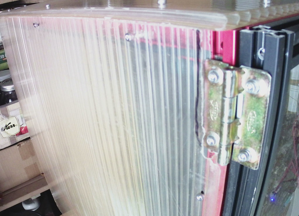

Self sourced 2.4 R2. My first 3D printer ever
