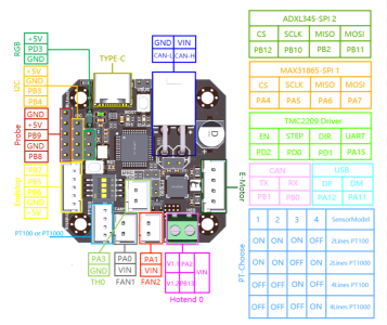

I'm building a new V2R2, and I'm using canbus and TAP.

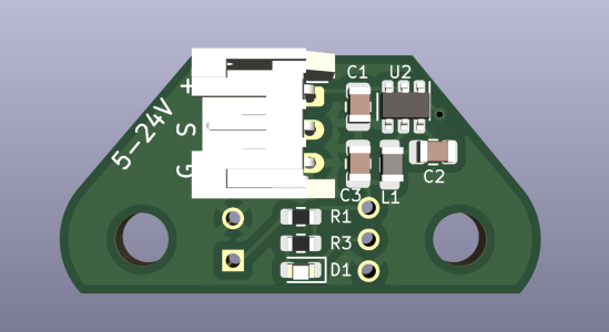

I'm using an EBB36 V1.2 canbus board with the OptoTap V2, and I'm hoping you guys can help me with the TAP sensor wiring.

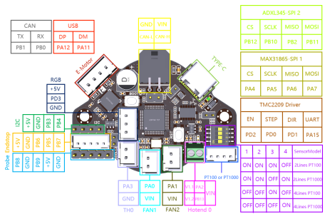

On the EBB36/40, there is a 5 wire endstop connector, with labelled pins +5V, GND, PB6, PB5, and PB7. The +5V and GND are self explanatory, but where do I wire the TAP signal? Once wired, I just need to follow the TAP instructions and change my endstop pin to match?
My understanding is that you can use any of the PB5, PB6, or PB7 pins. Just make sure you add the correct pin to the probe config section. If you plan to use the board for the x end stop, I would use the probe pins for the tap board. So in this case, PB8 or PB9.
I am using PB9.
