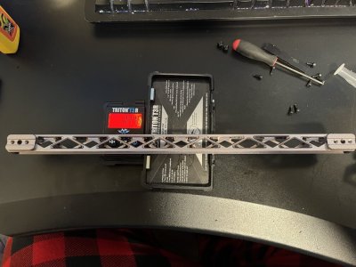

X-Beams
380mm Misumi 1515 126.49g
380mm Mellow CF Tube w/o hardware 40.65g
380mmSpinsall4 Funssor X-Beam 84.46g
380mm DoubleT's AluminumX w/ m5 t nuts and printed parts 131.51g
380mm ChaoticLab X-Beam tube w/ Alu Hardware 80.91g
380mm Common Anomaly Lightweight X Beam with Titanium Backer and backer hardware 169.40g

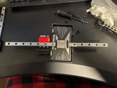

Rails
350mm Fabreeko Honeybadger MGN12H 275.09g
350mm China HIWIN MGN12H 284.39g
350mm Fysetc Lightweight MGN12H 221.31g
350mm Fabreeko Honeybadger MGN9H 155.33g
350mm China HIWIN MGN9H 159.64g
