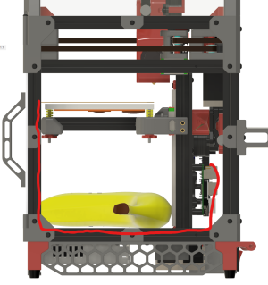

I'm heavily leaning towards your remix now, since it's straight in the middle of both my other considerations. Do you have a picture of the servo cable and how you routed it?
Was there anything that bothered you with the stock Klicky Probe that made you remix it?
I was doing a lot of full 120x120 prints, and it was difficult to find a location for the probe dock that wouldn't interfere, but was still able to be consistently picked up by the toolhead. I dont have a good photo, but this is where the wire runs, inside the extrusion channel, and under the mid-panel
I see, thank you!
Do you run a Nevermore (Micro)? I presume that running the cable like that won't work with a Nevermore installed there. So, I'd have to mount it on the over side?
I see, thank you!
yeah I moved my nevermore to the other side
