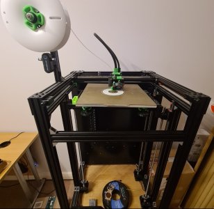

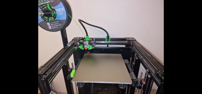

Hi all, a few years back I built a 300x300x600 blv mgn. I was very tempted by the voron but thr initial cost put me off.
Over the years I've upgraded the blv but it still isn't that great.
I'd like to convert it to a 2.4 if possible, and just trying to get a rough idea of what parts I need.
Im thinking I can reuse the parts below:

No idea what a blv is but I bet by the time you try to convert it you will buy almost all new parts and it would be cheaper to buy a kit.
Have pics of your BLV or links to what it is?
Stands for Ben Levi, the author of that printer. I first saw it on Thingiverse many years ago, it's an open source CoreXY design that is at first look very nicely designed. Problem is that, from what I heard/read from people who built one, it isn't kind with low tolerances cuts on extrusions; it also isn't fully enclosed, so PLA/PETG only. There is also a rumor that mods are frowned upon by the author, but I couldn't verify that.
